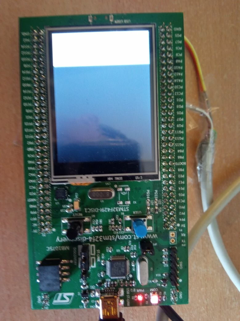

i am trying to configure my the CubeMX for my STM32F429I Disc 1 board to show the default hello world sample, which is generated from the Cube.
I have try very much an have read the example in the firmeware packegs (1.19.0). I have attached the .ioc file.
In the moment i get only a quarter white image on the display (see attached image).
I want to attached the complete project, but the size is bigger than 50MB so i can only descripe what i have done after the generation of the project.
I have copied the files like in the video and with the BSD it works correctly ( i have comment out the GRAPHICS_XXX lines).
https://www.youtube.com/watch?v=u_TVAudWabI
But when i will use the GRAPHICS_XXX nothing will work correctly.
I have tryied to compare the settings from the Example (STM32F429I_DISO_MB1075), which works correctly.
I have no glue, what i have do wrong. Can someone help  me with the problem?

Posted on April 02, 2018 at 12:59
Hello
Parli.Stefan
Please try to use the latest version of Cube firmware packageSTM32Cube_FW_F4_V1.0,with
new STemWin applications for STM32F429I-Discovery.
In the main, the display issue may be caused by one of the following:
- Stack size is too low.
- Wrong initialization of the display controller.
- Wrong configuration of the display interface.
Best Regards,
Imen

Posted on April 03, 2018 at 10:02
is there any tutorial or manual which discripe what i have to set to get the StemWin working?
I have tryied to call BSD functions directly and this works fine (I have changed the background color).
Thank you for your help.
Best regards
Stefan

Hi
Parli.Stefan
I recommend you check the
http://www.st.com/content/ccc/resource/technical/document/application_note/54/c9/95/42/8c/0b/43/69/DM000896pdf/files/DM000896pdf/jcr:content/translations/en.DM000896pdf
Application note Getting started with STemWin Library.
Best Regards,
