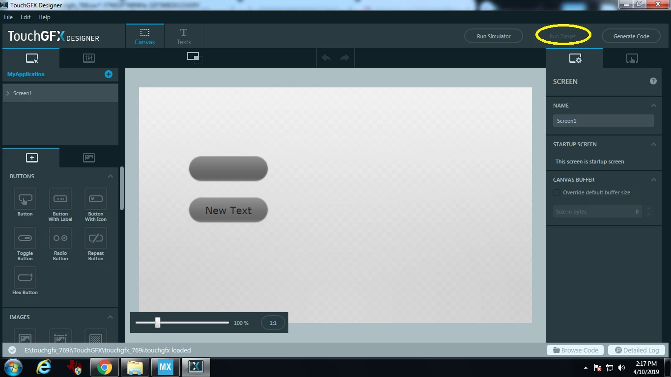

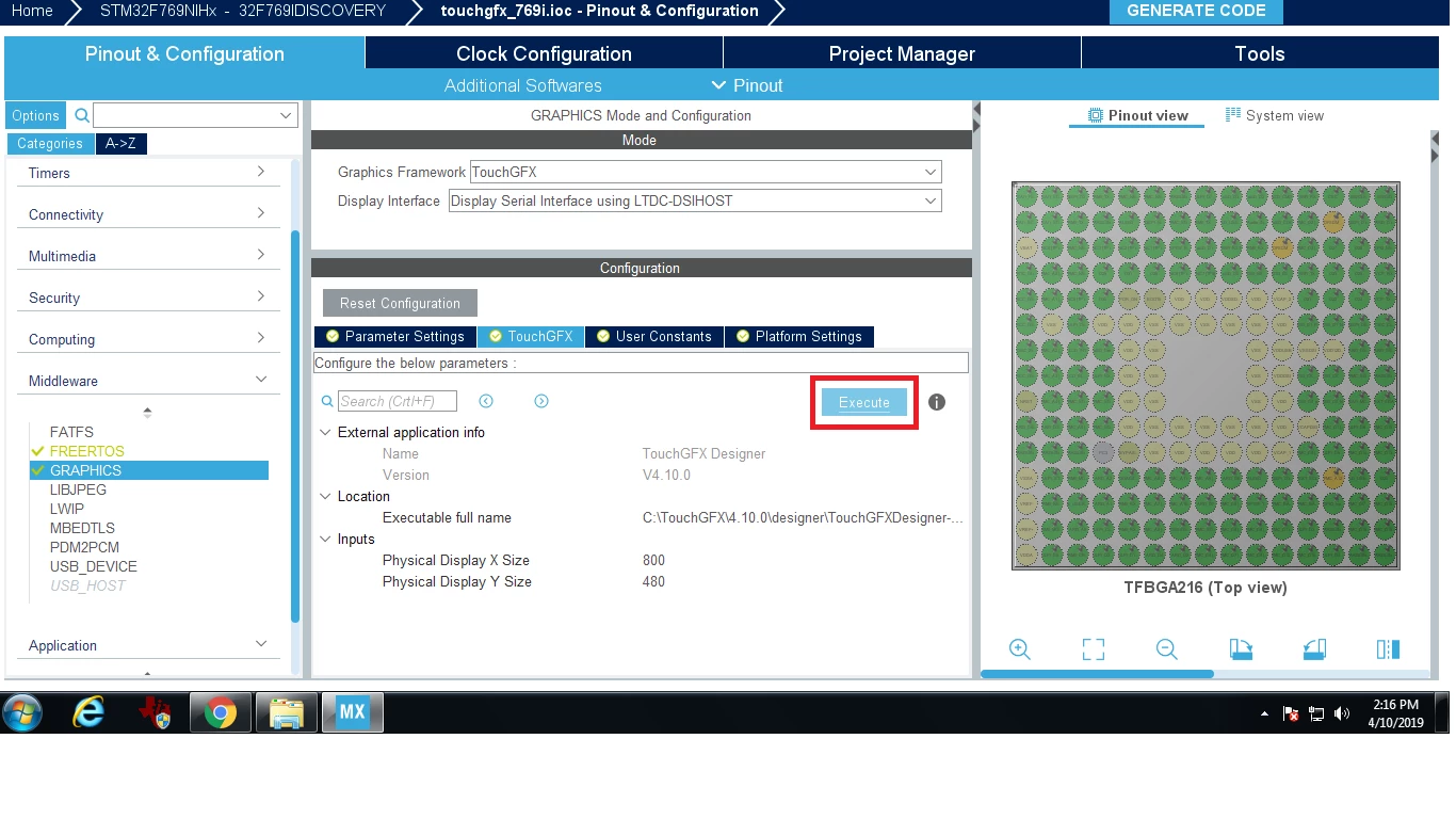

I am configuring the STM32F769I discovery Board in CubeMX and then use 'Execute' to generate the TouchGFXdesigner application.
But I think , TouchGFX doesn't maps the target correctly from CubeMX as the 'Run Target' option is inactive. (highlighted in yellow) Though it generates code without an error.
How can I select V2.0.0 of the STMF769-DISCO in the TouchGFX designer now?
