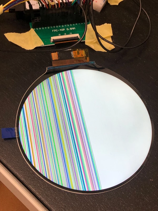

Hi Everyone I have a some difficulties with bringing up the HD40015C40-Y display with TouchGFX or even at all:
1. I used the init code provided by adafruit, I set up my SPI with 9bit words and sent it to the display as per the datasheet for the NV3052CRGB datasheet.

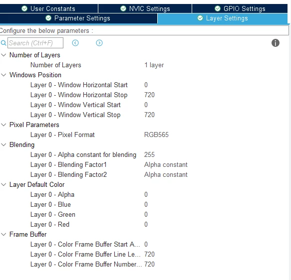

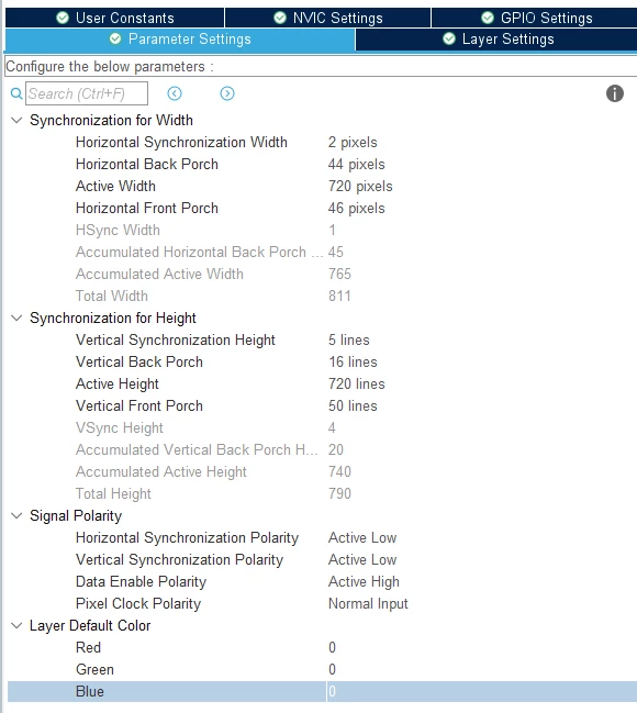

2. TouchGFX is already setup and LTDC is setup to the timings described in the  https://www.adafruit.com/product/5793 init code.
3. I have very strange rainbow lines behaviour
Currently I am running a 35Mhz clock. The 35Mhz clock was derived from the linux device tree overlay for the HD40015C40-Y display.
4. Things I do know: SPI transmission definitely works. There are physical signals for the LTDC pins coming from the STM chip as I checked with an oscilloscope.
Interestingly if you read the Circuit Python code from Adafruit, they only have 16Mhz frequency.
I have no idea if this is a software problem, hardware problem or a combination of both.

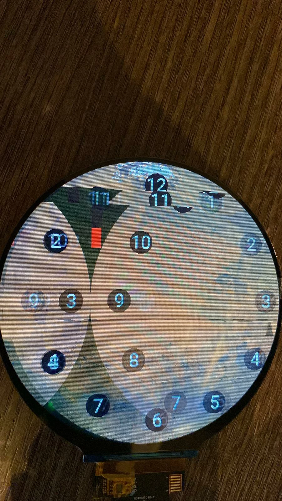

I've had different permutations and combinations of Vsync and it has yielded different artefacts such as the number of lines appearing. However none of this reflects what my GUI design is supposed to look like.

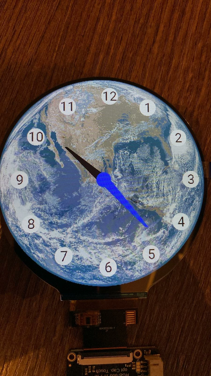

I have the image even TouchGFX GUI animating in the simulator but there is no change on the display.
So it seems to be stuck somewhere between SPI initialization and LTDC? If I turn off the power, it will lose this state. So SPI init seems to be working to an extent, however I cannot see the desired image. Anyone have any ideas?

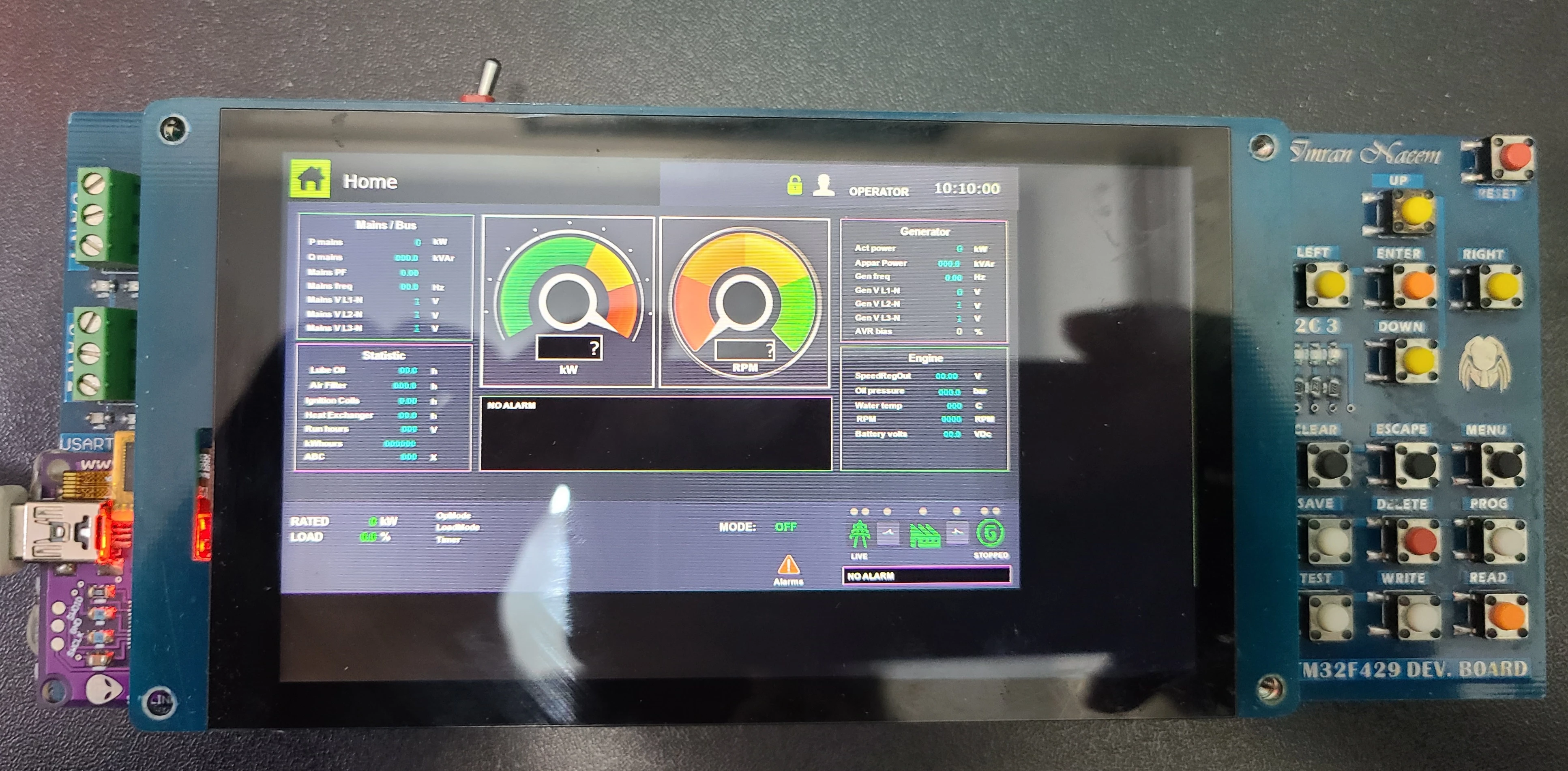

Hi SkeleSt ,,
I played with 5inch TFT having NV3052 chip with 720x1280 resolution.
The interface was SPI+RGB
Instead of Hardware SPI , I used software SPI function for Initialized .
Here is TouchGFX , running on 5.0" ,, 720X1280 ,, RGB + SPI TFT with STM32F429i-DISCOVERY
LCD PART No. TL050HDV31CT5-H1206A
The lcd driver chip/COG is NV3052
Let me know if you need help , fixing errors.
regards
I.N

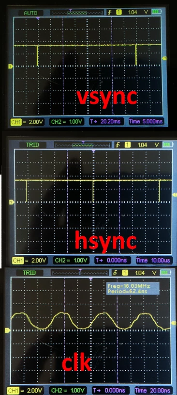

I'm doing a very similar activity and I am currently in the middle of the debug.
I have an MPU board that is not able to light up the display properly (even if the signals are correct), and for this reason, I've bought a complete adafruit kit, and I'm currently doing some tests on it.
I won't mention here the microcontroller that came with the display in this kit, but after having flashed the associated binary image, the display is running properly.
Here is what I've discovered until now:
This microcontroller is running the pixelclock at 16MHz, but if I raise it to 35MHz the display is still lighted up; there is a lot of flickering and the image is not stable but it is always present. See below pictures (on the left pixelclock = 16MHz, on the right 35MHz)

 16 MHz
Moreover, I verified that the following register initialization works properly after having mounted the kit:

thanks for replying. Regarding, 35Mhz is it possible that is due to signal integrity? The data should not be any different correct? Theorhetically if you try 18Mhz, 20Mhz etc. The data should be stable?
I read App note AN4861 and to get 60fps for 720x720 at 18bit we need at least 35Mhz clock.

You need to define your software SPI's Clock & Data Pins in MX.
You also need to bit modify the above codes as per your resolution.
I hop , after proper initialization , you will get the proper display .
regarding the Pixel Clock frequency ,, first use lower frequencies to test the display but display (complete frame) will flicker due to low refresh rate but don't worry.:face_with_tears_of_joy:
let me know the outcomes of your test with 9-bit software SPI.
regards

Jul 31, 2024 8:31 AM UTC
Okay, latest update:
Some extra information to bring up. I am using the STM32U5G9J-DK2 with the pinout modified to work on the display. I've modified the code such that it should work with a 720x720 framebuffer and do SPI init on the display. So in a sense I am not starting the project on a new board. That said, I don't believe this should cause the display to not work. If you create a project based on this in TouchGFXDesigner, you will end with the same base code I have.
I've purchased the Adafruit Microcontroller to compare. My SPI init sequence is 1 to 1 according to logic analyser with the exception of chip select not being down the whole time, I changed that and it didn't make a difference.
The next thing I did was start probing the clock signals on the Adafruit. I found it to be running at 12Mhz. I was using the rainbow demo and it was flickering however I think this is a problem with the code Adafruit provided and not so much the init or display itself.
I also measured the colour signals on the oscilliscope and found that to be sending data as expected.
And then I found out that my STM program is not sending any colour signal on the oscilloscope and that the Model::Tick() only runs once and then does not continue... This seems to be a problem with my codebase so I decided to start a new STM project.
Now I have colour signal again however... it is still the white stripes. I am at square one again.
The display refuses to display any of the LTDC signals despite receiving valid PLK, VS, HS clock signals and even colour signals (measured on oscilliscope).
The only signal I haven't been able to verify is the DE signal due to the small probe to measure. Even then, I think it is unlikely data enable isn't working.
Would anyone know how to extract the Vsync, Hsync FP and BP values from the adafruit. If it makes sense, it should be the same as the ones provided by Adafruit themselves and I should not have to investigate this.
Maybe some things I can try is bit banging directly to the RGB outputs. Or somehow testing LTDC before entering TouchGFX and RTOS loop, if that is possible?
Otherwise mostly, I'm not sure where to go from here.
 * @brief LTDC Initialization Function
 * @PAram None
 * @retval None
static void MX_LTDC_Init(void)
 /* USER CODE BEGIN LTDC_Init 0 */
 /* USER CODE END LTDC_Init 0 */
 LTDC_LayerCfgTypeDef pLayerCfg = {0};
 /* USER CODE BEGIN LTDC_Init 1 */
 /* USER CODE END LTDC_Init 1 */
 hltdc.Instance = LTDC;
 hltdc.Init.HSPolarity = LTDC_HSPOLARITY_AL;
 hltdc.Init.VSPolarity = LTDC_VSPOLARITY_AL;
 hltdc.Init.DEPolarity = LTDC_DEPOLARITY_AH;
 hltdc.Init.PCPolarity = LTDC_PCPOLARITY_IIPC;
 hltdc.Init.HorizontalSync = 1;
 hltdc.Init.VerticalSync = 4;
 hltdc.Init.AccumulatedHBP = 45;
 hltdc.Init.AccumulatedVBP = 20;
 hltdc.Init.AccumulatedActiveW = 765;
 hltdc.Init.AccumulatedActiveH = 740;
 hltdc.Init.TotalWidth = 811;
 hltdc.Init.TotalHeigh = 790;
 hltdc.Init.Backcolor.Blue = 0;
 hltdc.Init.Backcolor.Green = 255;
 hltdc.Init.Backcolor.Red = 0;
 if (HAL_LTDC_Init(&hltdc) != HAL_OK)
 Error_Handler();
 pLayerCfg.WindowX0 = 0;
 pLayerCfg.WindowX1 = 720;
 pLayerCfg.WindowY0 = 0;
 pLayerCfg.WindowY1 = 720;
 pLayerCfg.PixelFormat = LTDC_PIXEL_FORMAT_RGB565;
 pLayerCfg.Alpha = 255;
 pLayerCfg.Alpha0 = 0;
 pLayerCfg.BlendingFactor1 = LTDC_BLENDING_FACTOR1_CA;
 pLayerCfg.BlendingFactor2 = LTDC_BLENDING_FACTOR2_CA;
 pLayerCfg.FBStartAdress = 0;
 pLayerCfg.ImageWidth = 720;
 pLayerCfg.ImageHeight = 720;
 pLayerCfg.Backcolor.Blue = 0;
 pLayerCfg.Backcolor.Green = 0;
 pLayerCfg.Backcolor.Red = 0;
 if (HAL_LTDC_ConfigLayer(&hltdc, &pLayerCfg, 0) != HAL_OK)
 Error_Handler();
 /* USER CODE BEGIN LTDC_Init 2 */
 /* USER CODE END LTDC_Init 2 */
