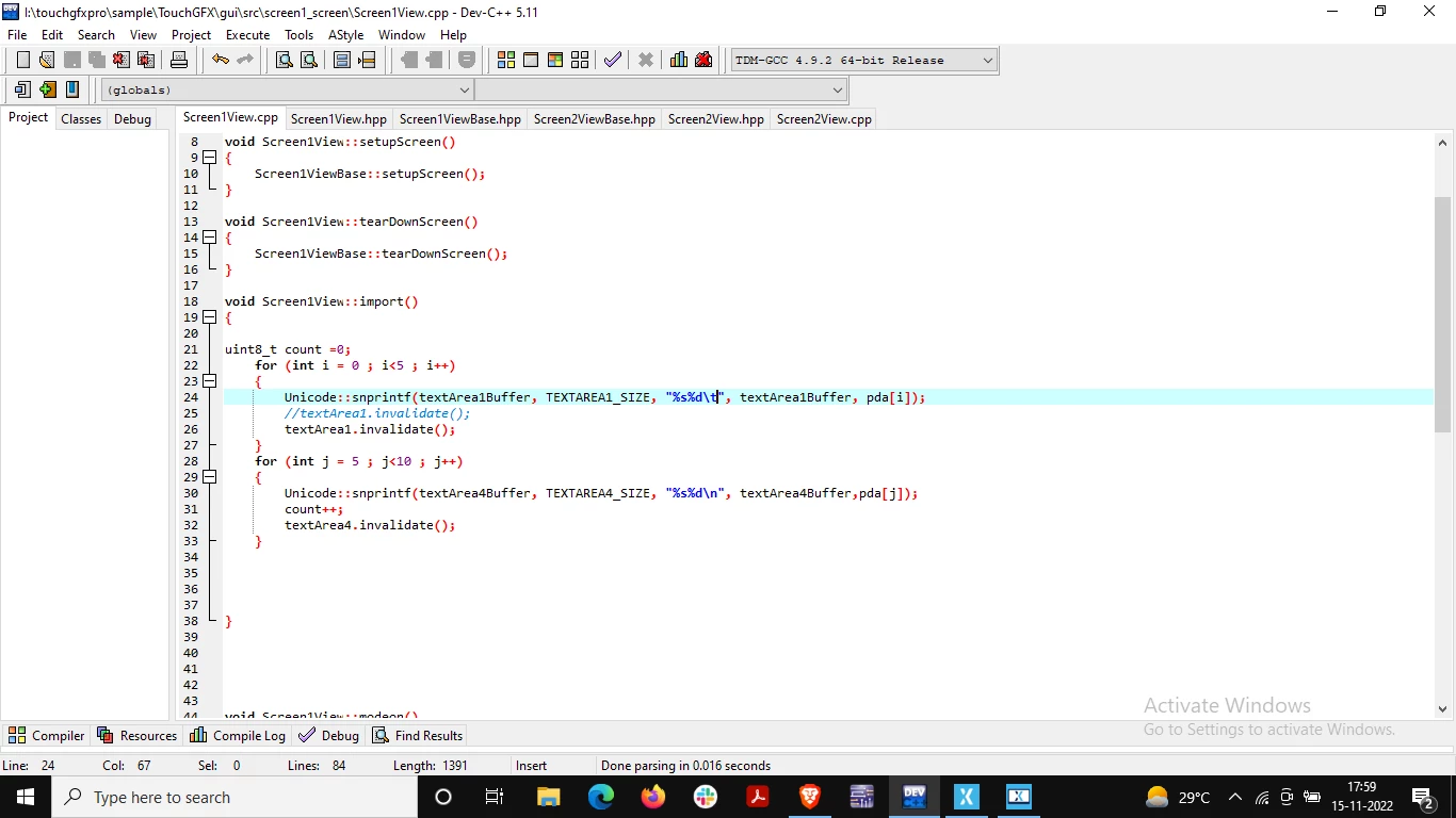

space character
as i include
Unicode::snprintf(textArea1Buffer, TEXTAREA1_SIZE, "%s%d\n", textArea1Buffer, pda[i]);
   //textArea1.invalidate();

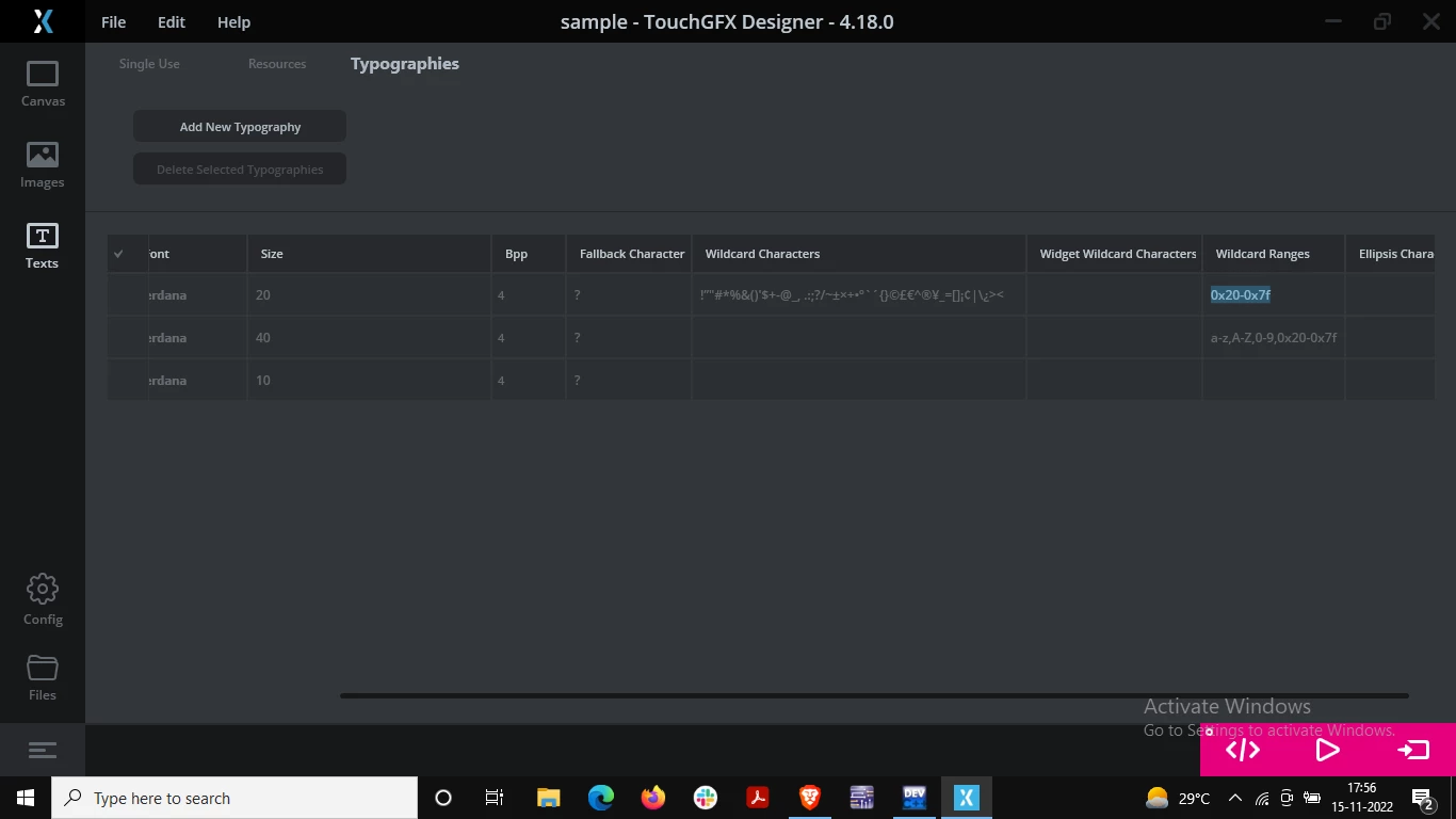

it works when i replace \n with \t show fallback characte(?)
what is actually happen
also add
wildcard range from 0x20 to 0x7f

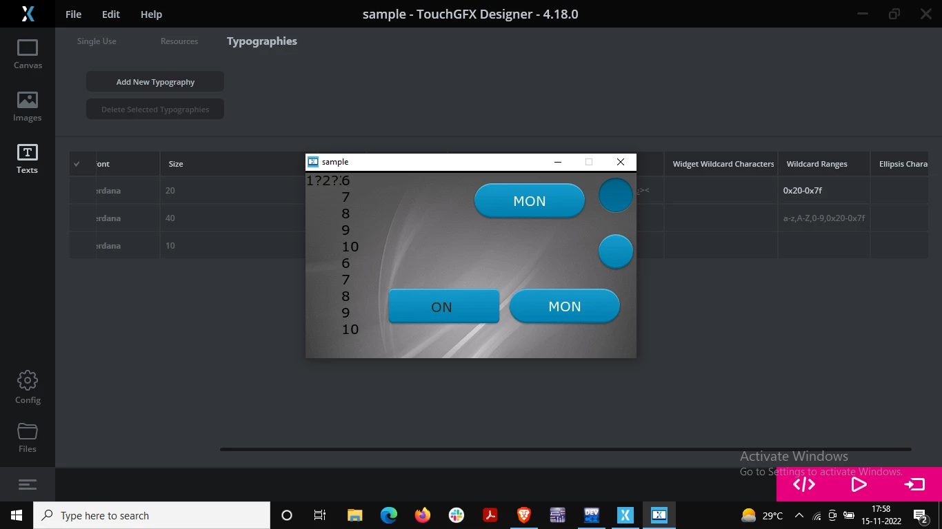

MA.21
MA.21Author
Nov 15, 2022 12:29 PM UTC
result shows second text on 2nd text area but 1st shows ? character0693W00000WIOIrQAP.png

Where in your code is space?
\t is binary char ...
That's something controlled by your terminal, not by printf. TGFX not control tabs.
