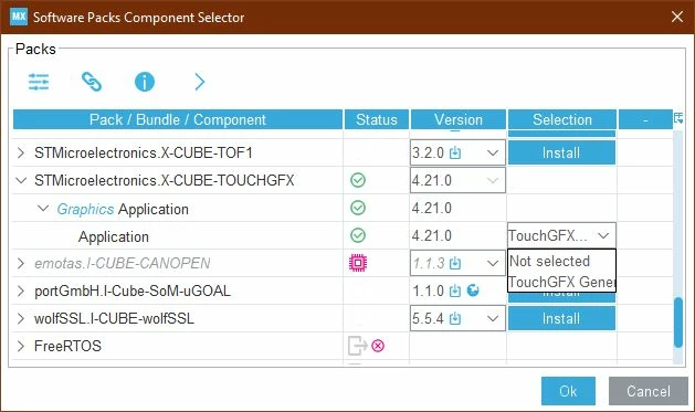

Paul1
Paul1Author
Senior III
Jan 16, 2023 1:33 PM UTC
And as per Murphy's law, the solution presents itself within seconds of hitting submit on the above post (Co-Worker recalled somthing similar from AI tutorial).
1) Install the software pack for TouchGFX in MX (Help>Manage...)
2) In the new MX Project ENABLE TouchGFX using: SoftwarePacks(Top centre of MX, not under Help) > Select Components > Under TouchGFX Drill down to Application and "Select/Enable" it (See attached: TouchGFX_Select=Enable.jpg).
Paul
