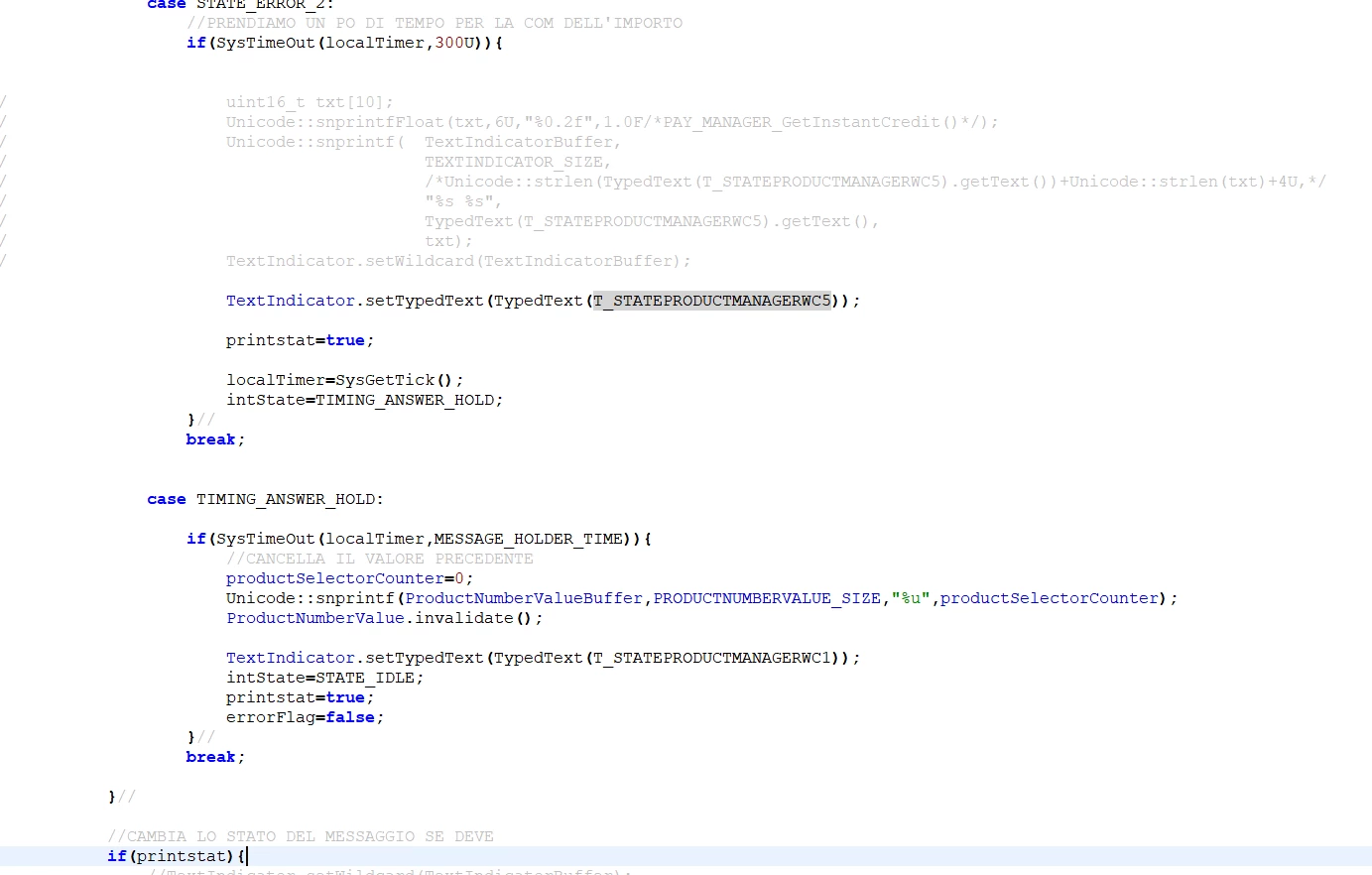

Hi friends, I have this problem:
static uint16_t txt[10];
Unicode::snprintfFloat(txt,6U,"%0.2f",functionGetFloat());
Unicode::snprintf( TextIndicatorBuffer,TEXTINDICATOR_SIZE,"%s %s",TypedText(T_STATEPRODUCTMANAGERWC5).getText(),txt);
TextIndicator.setWildcard(TextIndicatorBuffer);
TextIndicator.invalidate();
this work only once, after calling this function the second once, nothing change... some hint? thanks..

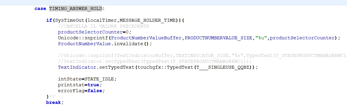

I alternate in the same place calling text in memory like:
TextIndicator.setTypedText(TypedText(T_STATEPRODUCTMANAGERWC4));
I tried any form of solution in the hint list.
In first attempt the text change in right mode, but after the first call, it not appair over. In debug the function get called, but no showing changes on text on screen.
calling passages over
or
TextIndicator.setTypedText(TypedText(T_STATEPRODUCTMANAGERWC6));
change, but trough sprintf only once and stop... i tried your solution and more other but with no luck.

Okey,i think you must have
since in some machine states use setTypedText funtion. Place this setWildcard in the states you use wildcard buffer.

I tried, but not work, if you see, was in the first comment in the start. Everyting seems work in first attempt I call the machine, but from the second one not work...
this work very well..
I considering to open a touchgfx ticket... really strange issue.

If you use setTypedText()- function in some machine state, you must return it also to the original single use id. Like this:
TextIndicator.setTypedText(touchgfx::TypedText(T___SINGLEUSE_IGD9));
Open your view-base.cpp and check singleuse ID there.
Maybe easier is to not use setTypedText, but do like this
Unicode::snprintf( TextIndicatorBuffer,TEXTINDICATOR_SIZE,"%s",TypedText(T_STATEPRODUCTMANAGERWC1).getText());
in the TIMING_ANSWER_HOLD, then the correct single-use ID stays.

Dear JTP1, I tried to change all lines in snprintf not using TextIndicator.setTypedText(blabla)... not work nothing at all! seems that if I use for this wildcard snprintf, after work once, it not will work over on this buffer.
if you look at the TIMING_ANSWER_HOLD, you can see the same for productSelectorCounter... and this work...
It work onli the first called routine in this sequence... after stop .

Jul 24, 2023 2:01 PM UTC
hi JTP1, I not solved the problem, I don't know why but this not work in my code. for time restrict in the work, by now I changed all in a simple retTypedText
