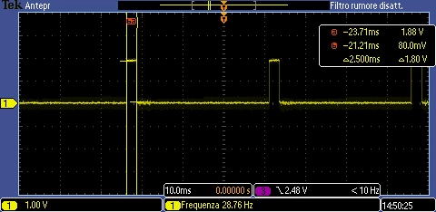

Also, this is the VSYNC signal captured
0690X00000AQoVBQA1.pngVSYNC the frequency is approx 29Hz

Your VSYNC seems slow. Can you tweak the pixel clock to speed it up?

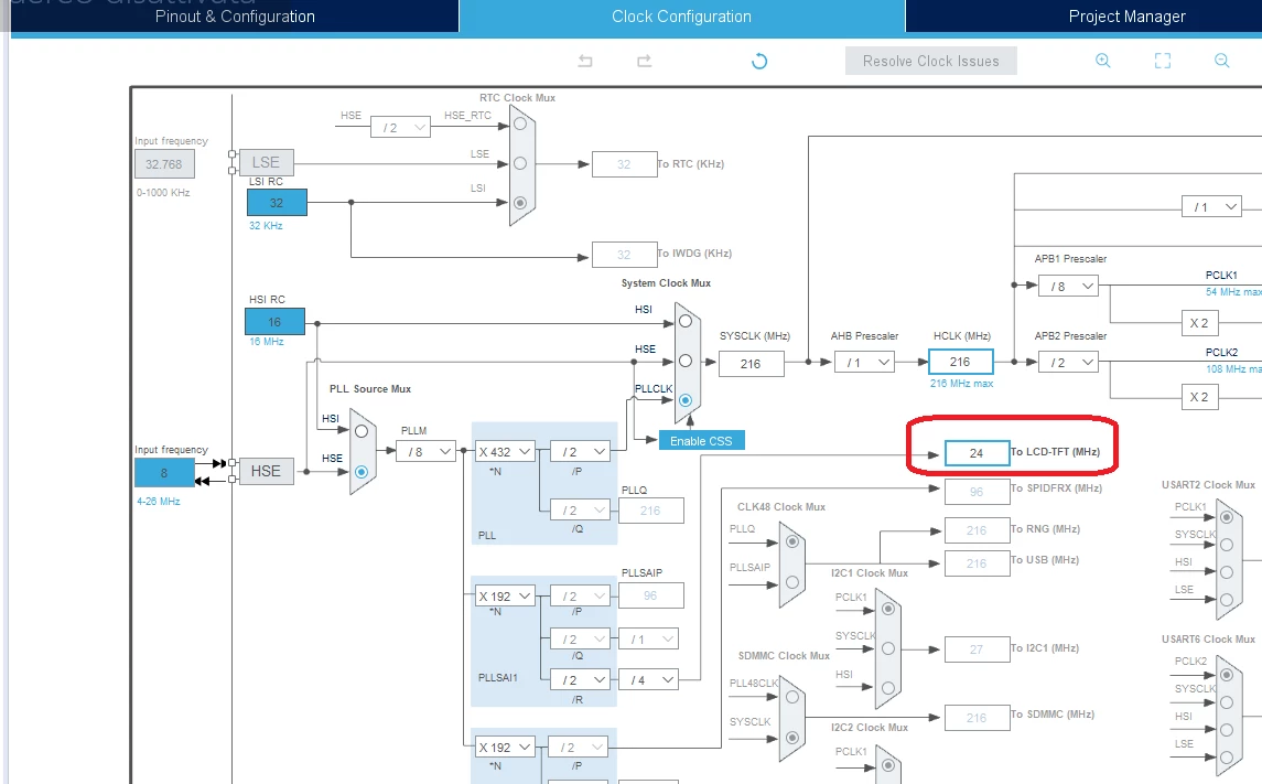

If I understand correctly, I can change the pixel clock via STM32Cube IDE Clock Configuration, as shown in the figure.
It's correct?

What i meant is that you can capture RENDER_TIME to find the time it takes to render an entire frame. You can use this to measure the time during transitions to get an idea.
Yes, you can change the clock like that, but through the derivative settings following the arrow (PLL).

Anyway, I doubled pixel clock (from 24Mhz to 48Mhz) but "TopMenu" transaction does not seem to accelerate.

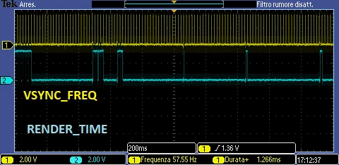

In the attached image, VSYNC_FREQ and RENDER_TIME when I "touch" to display slidemenu

That is a really long render time. Must be a really slow animation.
Do you have DMA2D configured to do these transfers? In a slidetransition we're transferring a lot of pixels, especially with your resolution.
