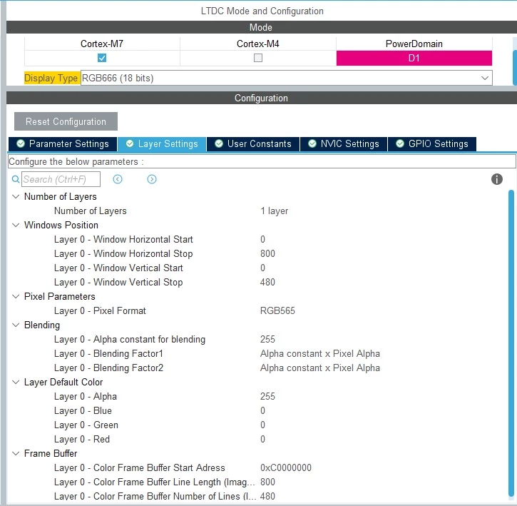

The board is an internal board with a 800x480 display connected in parallel to the LTDC interface with a 18bit bus as shown below:

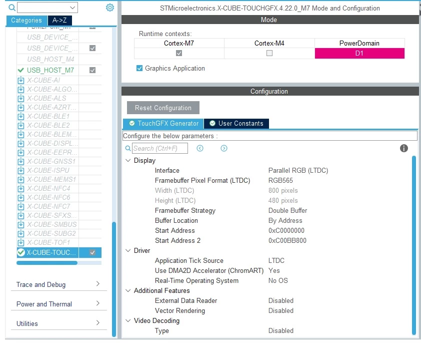

I use an rgb565 buffer in an external psram. Touchgfx settings are as follow:

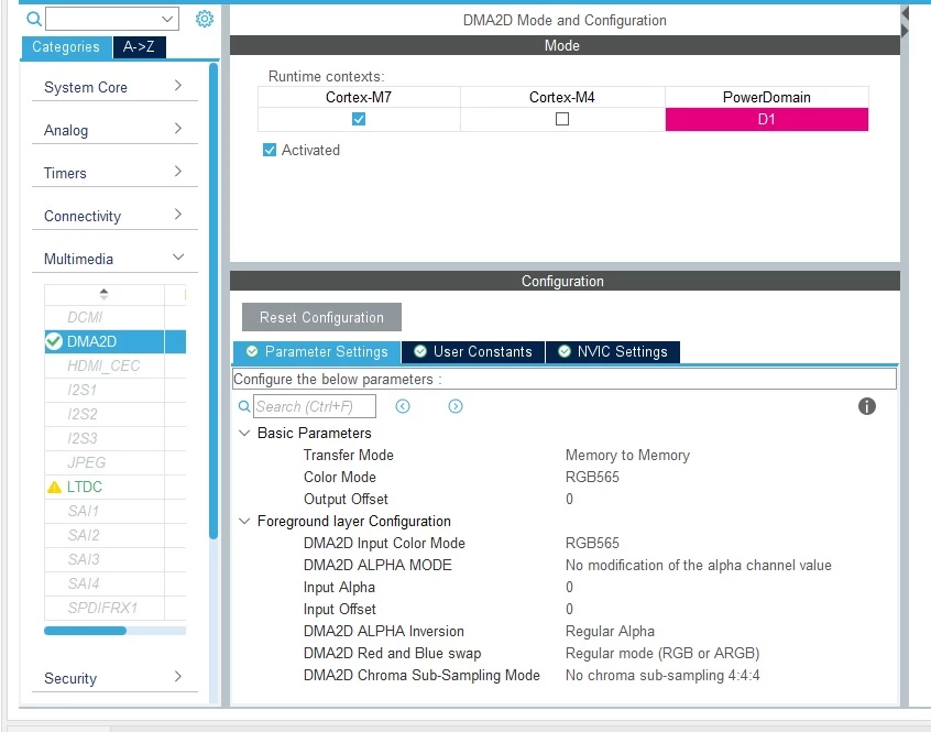

And here the dma2d settings:
I've made a simple screen where there is a fade of a box of 800x480 pixel (all the screen) from gray color to transparent but this fade is very slow. With or without DMA, the result is the same.

I've choosen LTDC as Application Tick source as described here: https://support.touchgfx.com/docs/development/touchgfx-hal-development/scenarios/scenarios-ltdc-parallel-rgb
and as you can see also in a screenshot in my first post; I mean this:
At the end of the documentation, I read this:
and looking through the code I see that the isVsyncAvailable() is called everytime LTDC generates an interrupt. The interrupt handler that manages this is: HAL_LTDC_IRQHandler.

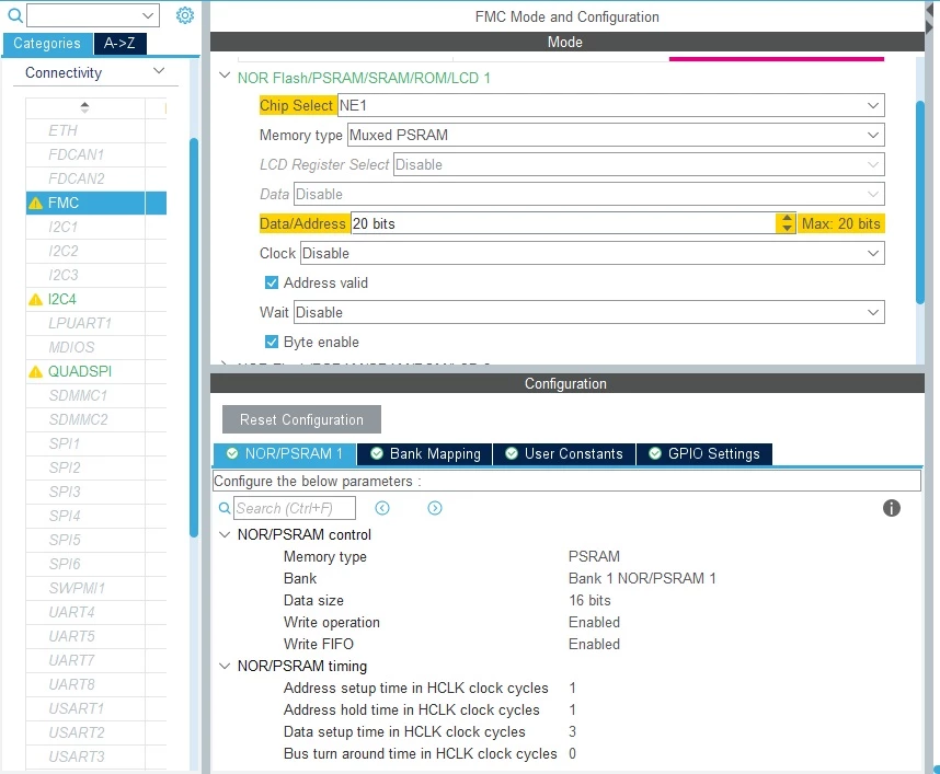

To be honest, I don't use a PSRAM since it's very difficult to find. However I am using a normal SRAM (a IS61WV102416FBLL-10TLI ) with 2 SN74LVC573APW latches and inverter for nadv.
The FMC clock is configured this way:
With some simple read/write test I've found the fastest clock we can achieve in order to have best performance. As far as I can understand the ram clock is enough to cover my display but I can be wrong. I don't find in the document you linked me, a section regards psram (only sdram, octospi, qspi flash) so I hope to have made my calculation well.
If I lower the FMC clock I see that the screen is corrupt so I think with this configuration the sram is fast enough.
