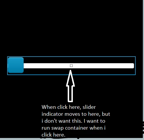

Slider with swipe container
I want to use swap container and a slider on same page. But when i click on slider background, i can not use swipe container, i.e i can not swap to second page. I just want to update the slider when i drag the indicator, not with clicking the background. So how can i implement this? Any advise?

I'm having a little difficulty understanding your issue. I don't see any problem using a swipe container / slider on the same page (unless the slider is in one of the swipe container pages). Is this the case? Can you show me a screenshot?

Hi @Martin KJELDSEN​
Please see the attached screenshot.

At which point do you want the slider to activate then? Only if you press the actual indicator? Is the slider in a swipe container page?

Yes, i just want to press and drag the actual indicator and adjust its value. And yes, the slider is in a swipe container page. Do you have any advise for me ?

I just want to swipe to second page from anywhere on the screen except the slider knob. This is only a design specification, because some users may want to slide screen from anywhere, so i want to control the slider with only its indicator. By the way , the setTouchable function can take one parameter of which true or false. How can we use this function with this aim?
