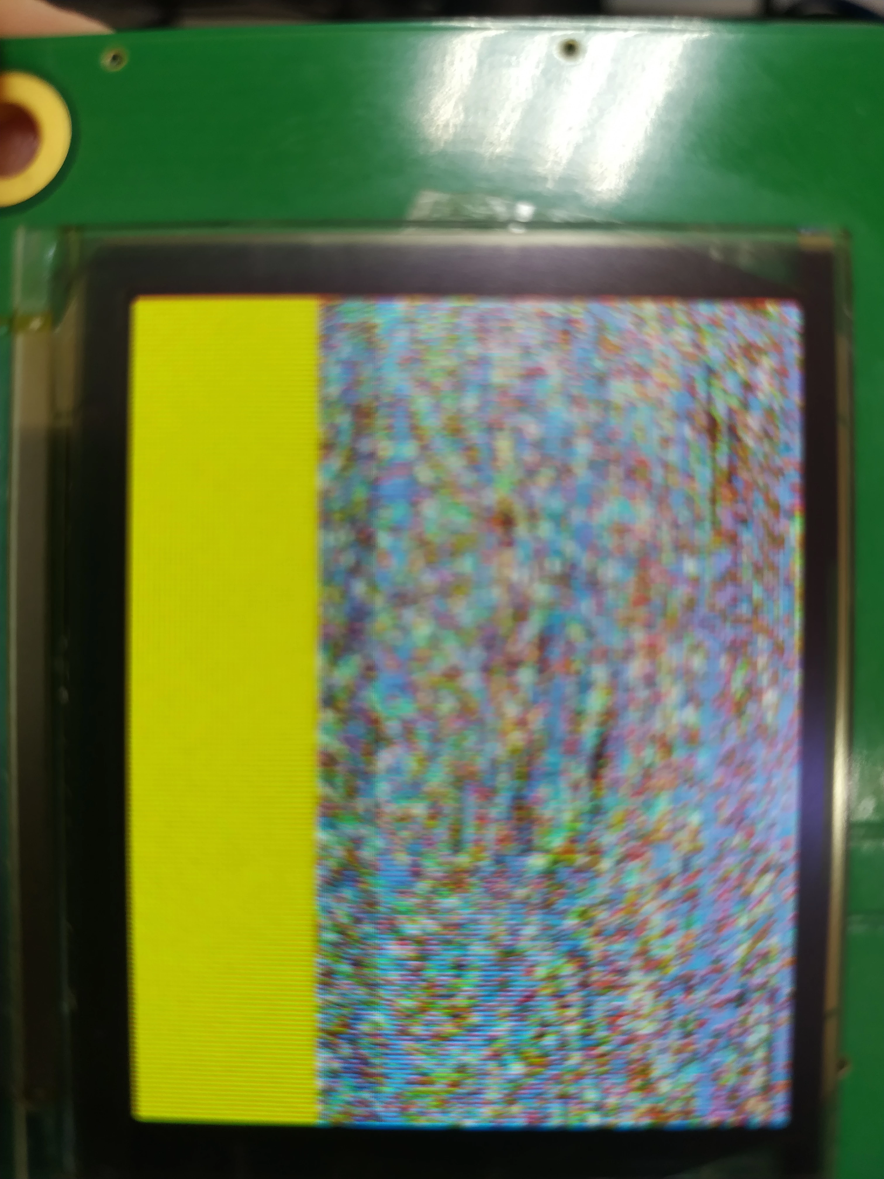

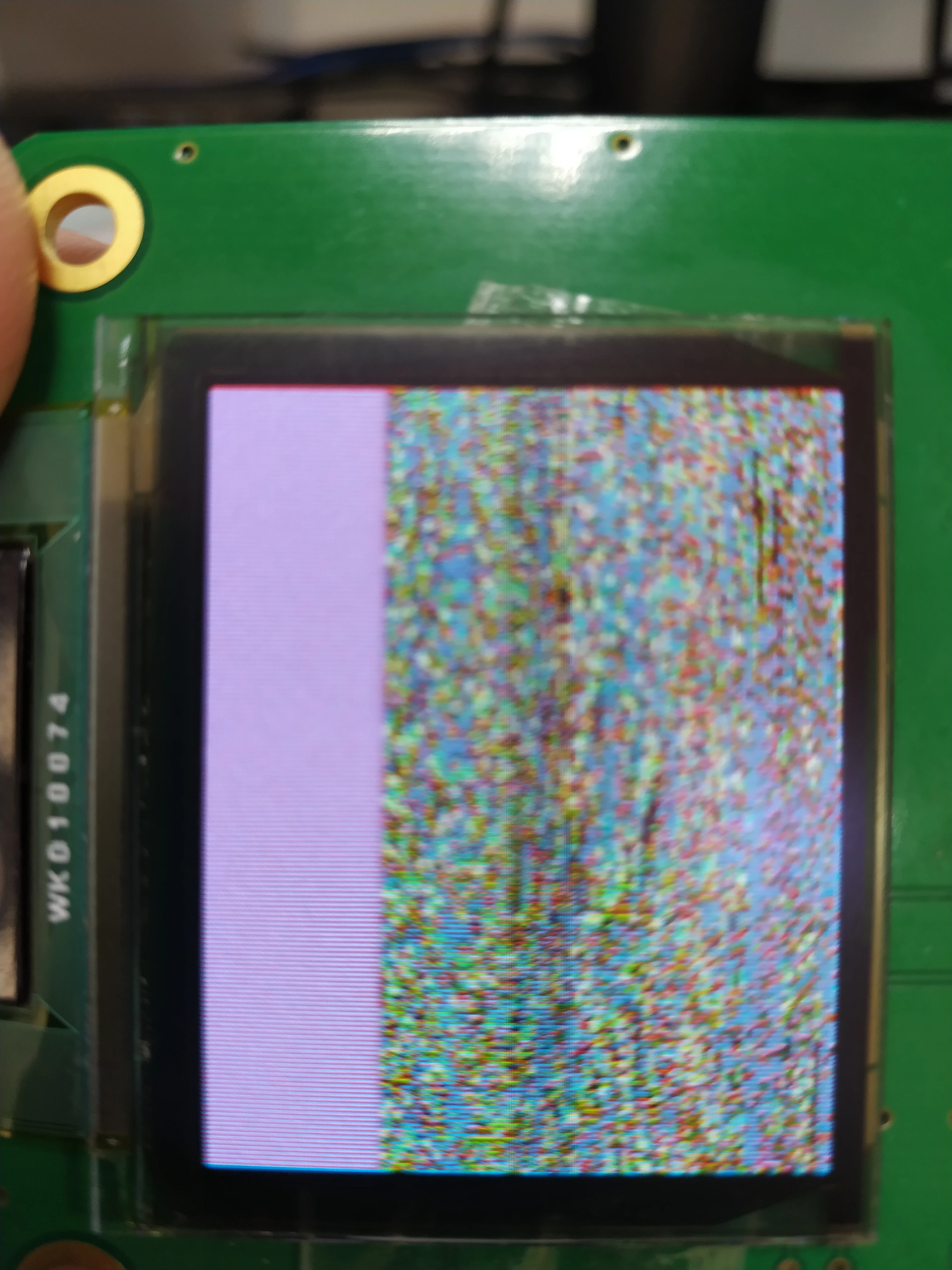

Slide screen transition problem
I created two screens and did the actions to change the screen. But changing the screen does not work correctly.
Added an extra buffer for animation

11 replies
Romain DIELEMAN
April 20, 2021
Are you facing the issues shown in the pictures only when you go from a screen to another ? Does that mean that you face no issues when staying on one screen and rotating elements (i have in mind the same animation as the UI template "Texture mapper example"), or with any other "complex" animations ?
/Romain

Yes, I only come across during transitions! Animating scrollWil Tutorial 4: Creating a Scroll Wheel with Custom Behavior works well! Transition block works good. Transition Slide, Cover and Wipe works bad.

Screen replacement does not work. The screen does not change.
After the first call to application (). GotoScreen2ScreenBlockTransition (), the transition to the second screen does not occur and the handleTickEvent event stops working.
