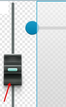

I have made a custom slider , vertical , using pngs .
When I run the simulator it does not appear .

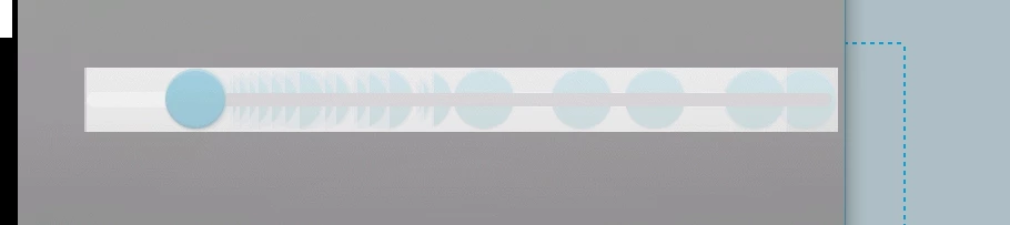

The default Slider shows but weird refresh and leaves a trail ?
Also , is there a way to say which item is on top of the other ? Bring to front , send to back ?

You're missing a background. What you're seeing is "ghosting" because there's nothing in the framebuffer at the very back to blend with.

And yes, you can see the order in the screen browser in the left hand side of the designer. So, you can change the z-order by moving them up and down.
