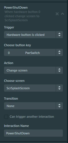

I have implemented a hardware button that changed the screen displayed.
It works fine when using the hardware.
I also want it to work with the simulator using the computer keyboard.
I think it is what the "Choose button key" in TouchGFX is for (correct me if I am wrong).
In the .touchgfx file I added the following:
"PhysicalButtons": [
 "Key": 0,
 "Name": "PwrSwitch"
Then in screen interaction:
0693W000007DUTqQAO.pngWhen running the simulator, I was hoping that by clicking on the computer keyboard "0" key, the interaction would be triggered. I tried both "0" key on the keyboard but nothing happens.
Please let me know if I am missing something.
Franck.

Best answer by MM..1
0 isnt key code , use ASCII "0" = 0x30 instead

That was it!
