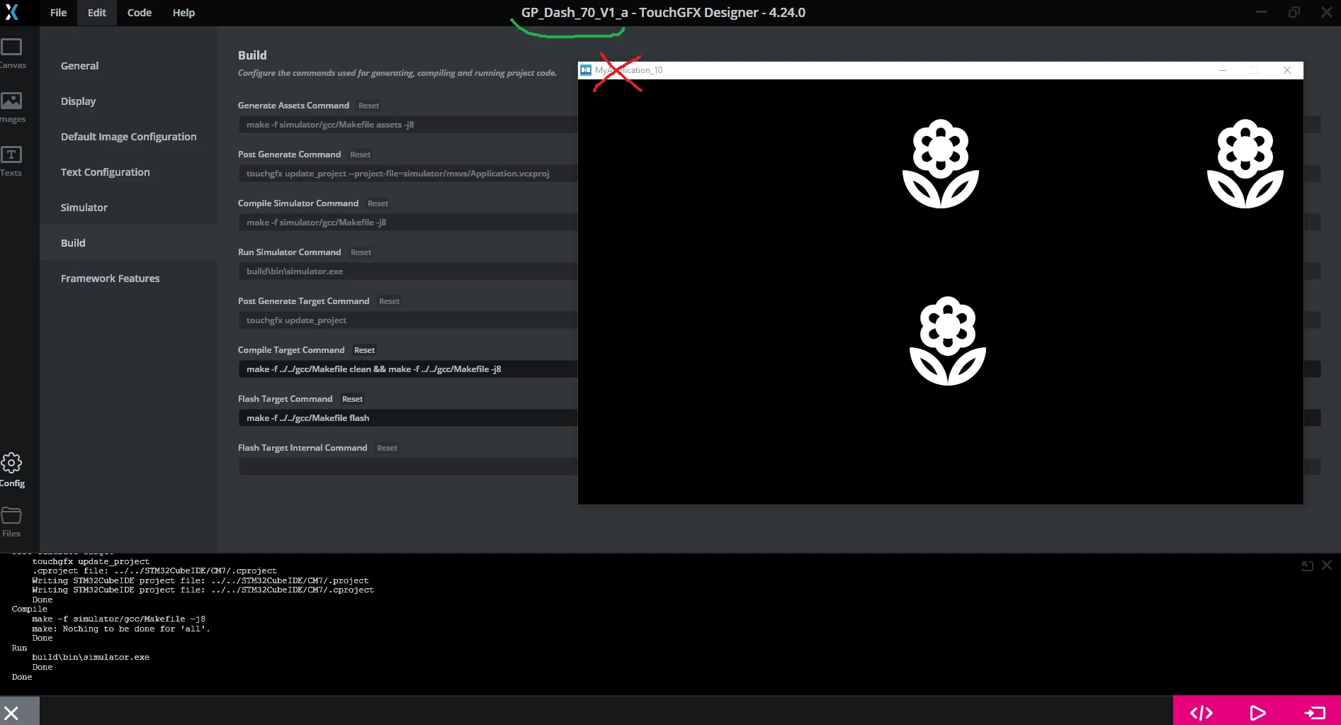

I have a problem, when I launch the simulator it does not launch the right project. My project is GP_Dash_70_V1_a not MyApplication_10.
MyApplication_10 is a project that I deleted a long time ago.
I do not know what manipulation I could have done to have this problem!

    Hello @Osman SOYKURT I had to copy and rename it a long time ago, and the renamed project worked fine. Due to errors I had to reopen the old base project in the project that worked and the problems started. I think it was stm32cubeide that merged!
    No problem with the new project.
    Is there a file that contains the links to the files to open on the simulator? I haven't tested on the riverdi screen.

    You can delete the generated, config, build, and simulator folders from your TouchGFX project directory, and regenerate the code from TouchGFX designer. Maybe this will help you, and please have a backup of your project before applying these changes.
