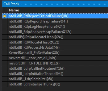

I've migrated our project from 4.9.3 to 4.10.0. Now I'm getting an exception when im running the simulator in visual studio 2017.
The error ocurrs when the program will execute the following line (189) within HALSDL2.cpp
if (SDL_Init(SDL_INIT_VIDEO | SDL_INIT_TIMER) < 0)
The error only ocurrs in the release-configuration in visual studio.
Everything else works fine:
  • Simulator in Visual Studio with debug-configuration
  • Simulator In designer
  • In IAR/on hardware
  • With touchgfx 4.9.3 the simulator works with debug and release configuration within visual studio
When i'm creating a new Project with the designer, everything works fine. I've already compared the files and configuration of visual studio, but did not found a difference which solves the problem.
Has anyone a suggestion what the problem can be?
I've attached the call stack
Thanks in advance

Hi @Marco.R​,
Anything more further down that stack? Can you identify the places where you allocate memory dynamically? Are you able to narrow it down a bit in terms of what the application is doing at the time of crash?

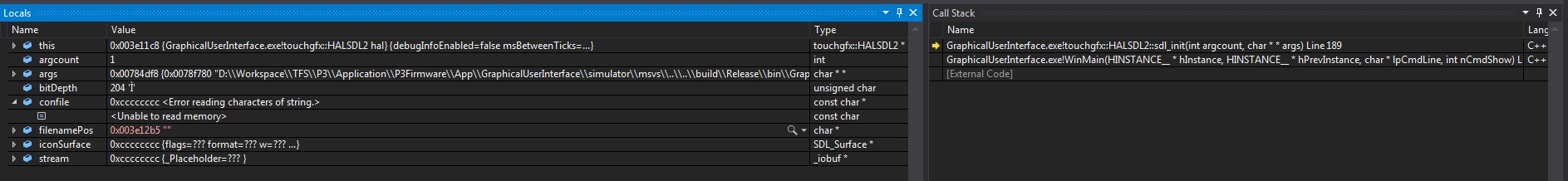

Thanks for the quick reply. This is the whole stack I attached in the last post.
Meanwhile I've tried the following:
  • Delete the Release configuration
  • Duplicate the Debug configuration
I've made the following changes in the configuration, otherwise the build fails:
  • Change Runtime Library from /MDd to /Md
  • Change Reprocessor Definition from _DEBUG to NDEBUG
The result is the same -> the simulator stops working when initalization the SDL2 Framework.
The error occurs within _SDL_Init routine of SDL2.dll (see Disassembly_SDLInit.png)
I also attached the Stack before this line will be executed (Line_before_exception.png)
I think the memory will be allocated within the SDL2.dll.
I assume it is a configuration failure, but I don't understand why It has an impact to the SDL2.dll.
