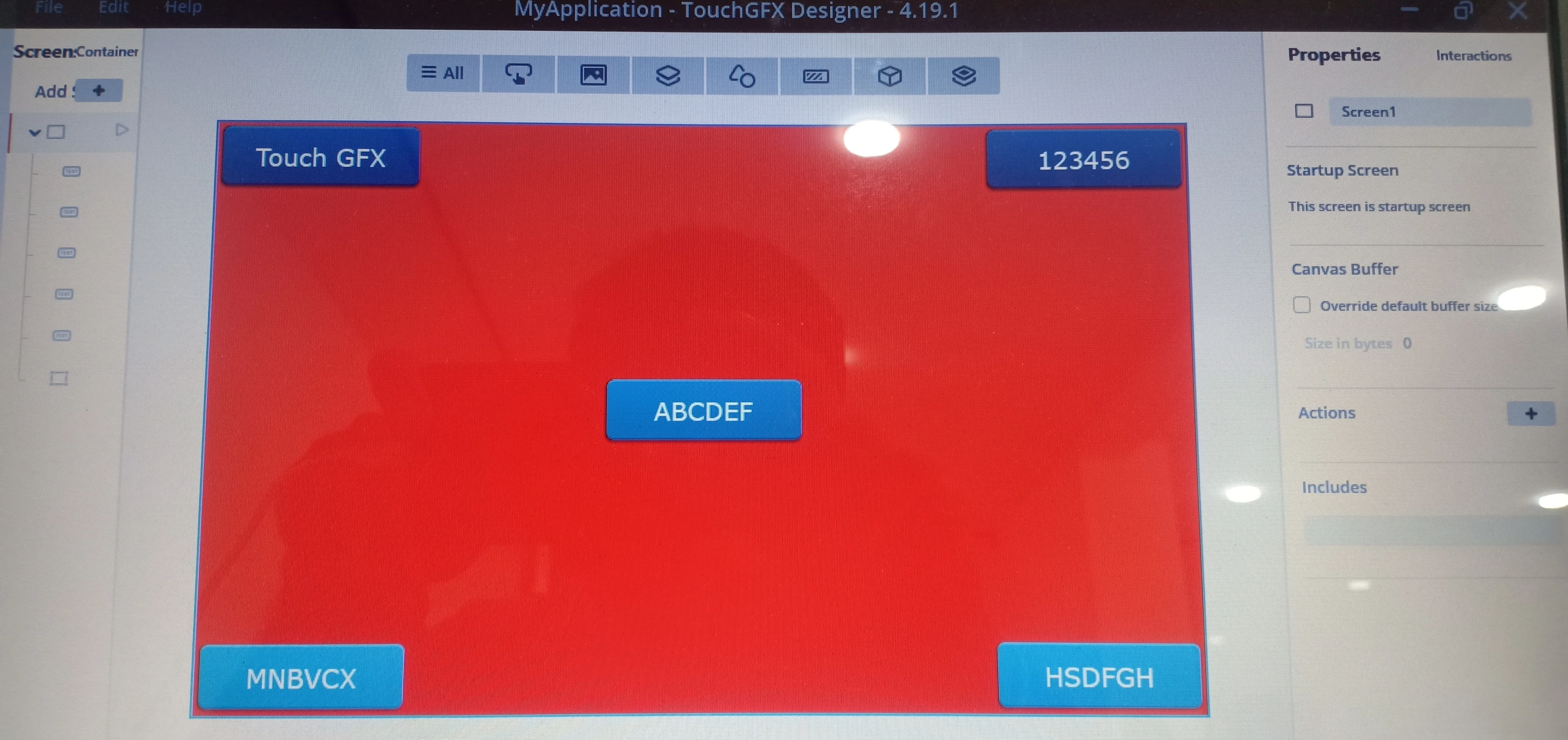

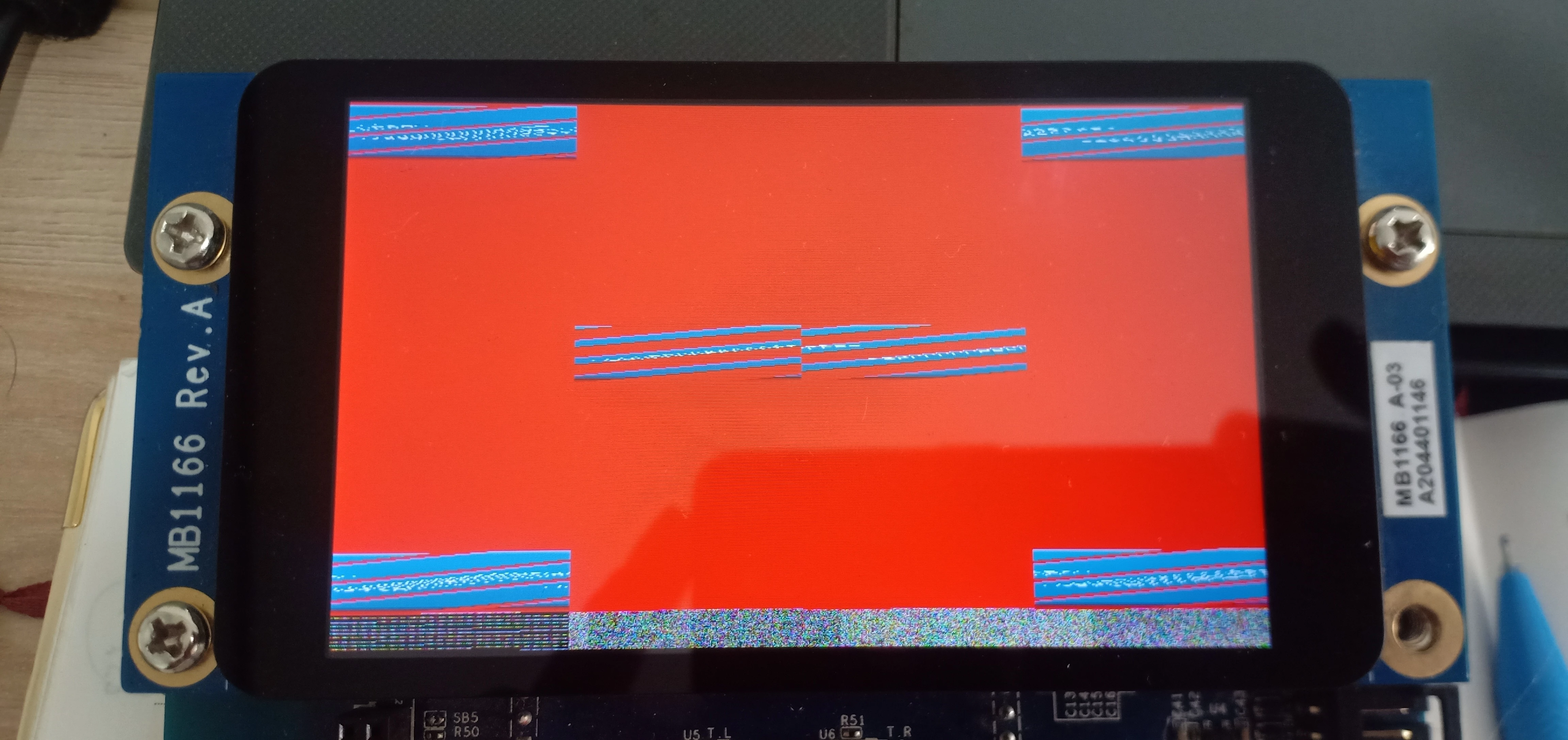

Simulated output of image is not shown as it is on the display. (STM32F769NI)
Hi Community,
I have generated the Touch GFX project through STMCubeIDE. Getting correct output in simulator. Not getting image as it is (on the Touch GFX canvas) on the display.
I have attached the images for the reference.

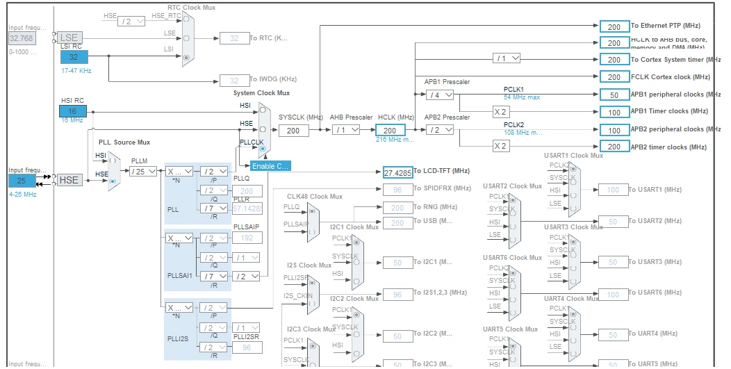

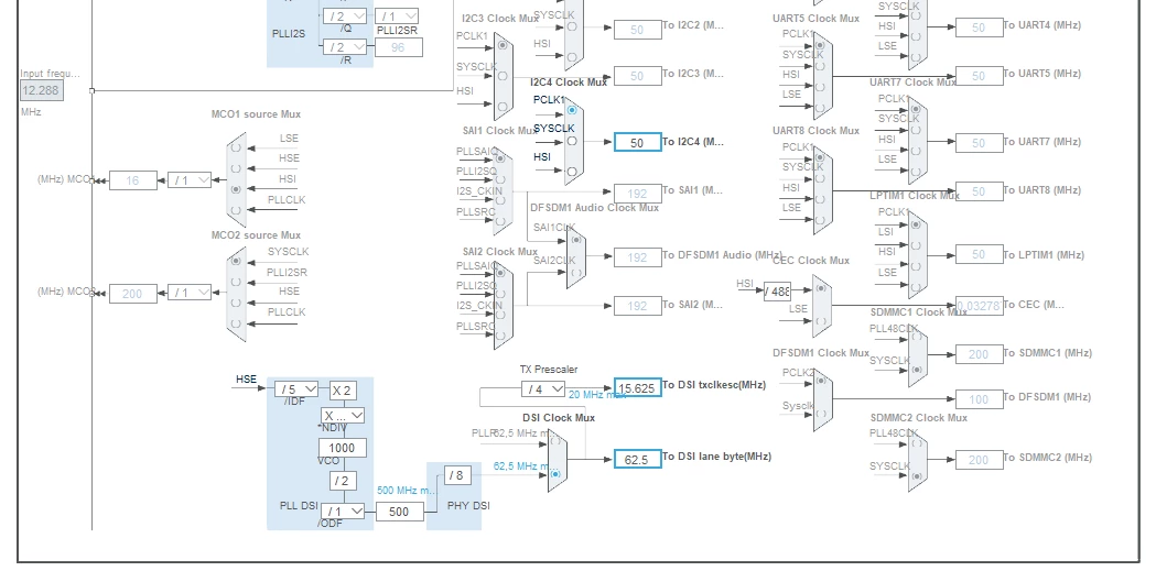

  • Could you show me your clock config ?

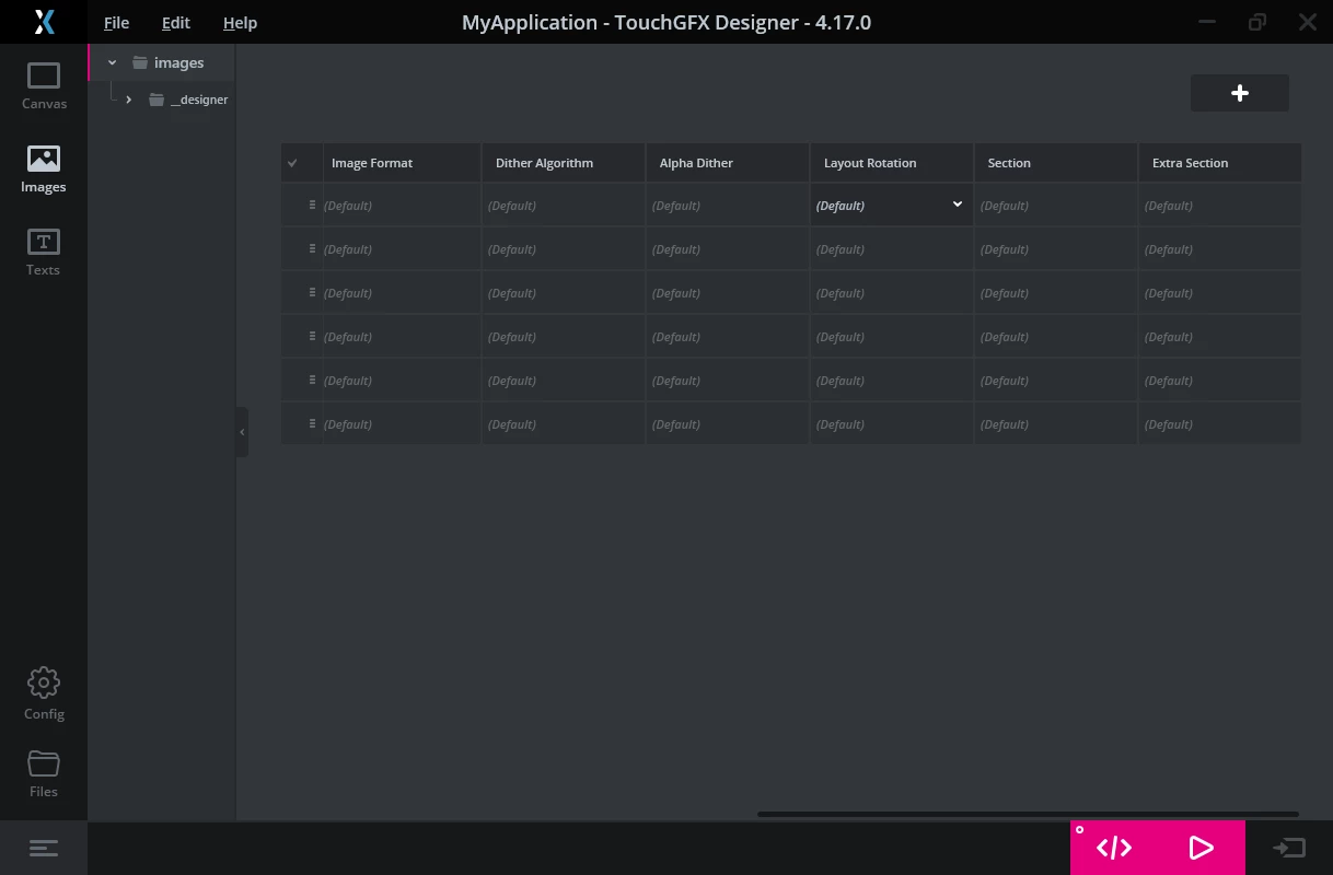

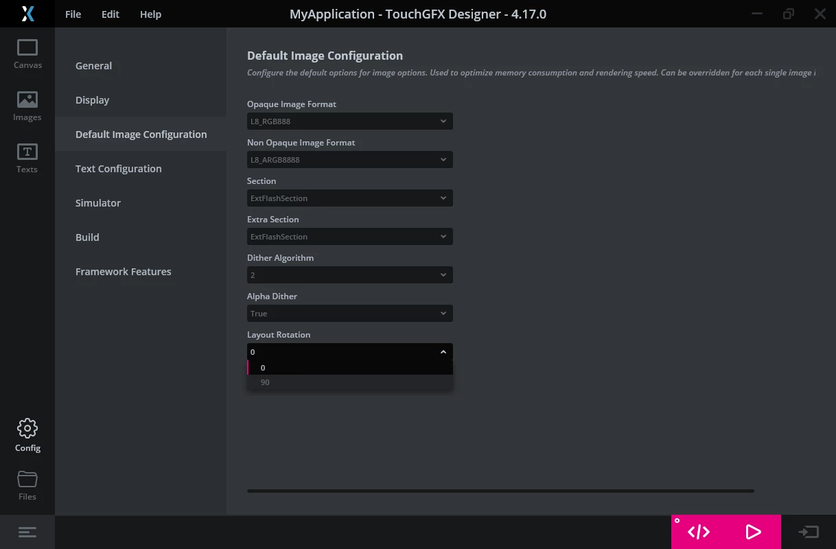

May 6, 2022 6:01 PM UTC
Basic user mistake. Set default image angle to 90 / 0 based to your hw lcd orientation.

May 9, 2022 9:31 AM UTC
@MM..1​ Already I checked with both the orientations, same results.
MM..1
May 9, 2022 1:09 PM UTC
Realy you regenerate code after change
0693W00000NpceNQAR.pngand on all images have default ?

May 9, 2022 2:05 PM UTC
this looks more like a problem with your porch settings or the pixel depth.
you can clealy se *something* which means the system is running and the assets are there.
The skewing of the assets hints at some offset going wrong at the end of the line. Also - the bottom of the image shows 'random' noise which indicate memory without content.
