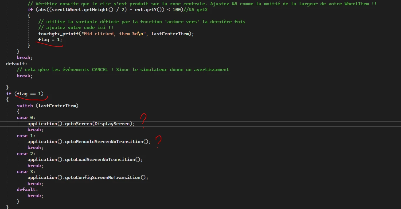

simply change pages screen
When a condition is validated, for example clicking in the middle of the scroll whell (flag == 1), how to change page, I can't do it? I've tried several things but I can't find anything explicit and clear in the posts or tutorials.

Hello
Just add to some of your screen interactions for changing screen - Screen x for all necessary screens. Its not needed to put any trigger to those interaction.
Then generate code and check generated function names from FrontendApplicationBase.cpp file. Then just call those functions from your switch-case structure.
Check my earlier answer here, maybe its enough clear:
https://community.st.com/t5/stm32-mcus-touchgfx-and-gui/frontendapplication-cpp-is-overwritten-when-he-code-is-generated/td-p/572550
Br JTP

NicoEFIAuthor
Feb 22, 2024 8:57 PM UTC
Many thanks :grinning_face:
