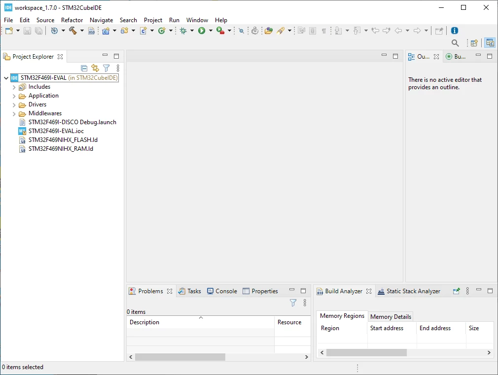

Should I be able to open and build a TouchGFX project (v4.18.0) in STM32CubeIDE (v1.7.0)?
I am creating a project for the STM32F469I-DISCO board, and trying to open it and build it in STM32CubeIDE. It appears that TuchGFX Designer is not creating correct file names. Some have -EVAL instead of -DISCO, and I think this is causing problems. You can see both in the project below. All I did was open the .cproject file in the TouchGFX project folder. It does not find the ioc file, because it is incorrectly looking for a -EVAL and the actual file is a -DISCO file.
I'm assuming this is a bug in TouchGFX Designer because it is mixing up the two types of boards (-DISCO and -EVAL)?

wired
wiredAuthor
Senior II
November 17, 2021
Tried building a project with 469I-EVAL rather than 469I-DISCO. Project builds with no errors (one warning about tick_start unused variable). It seems the problem is with the 469I-DISCO selection. This is the board I need to use, so are there any suggestions?

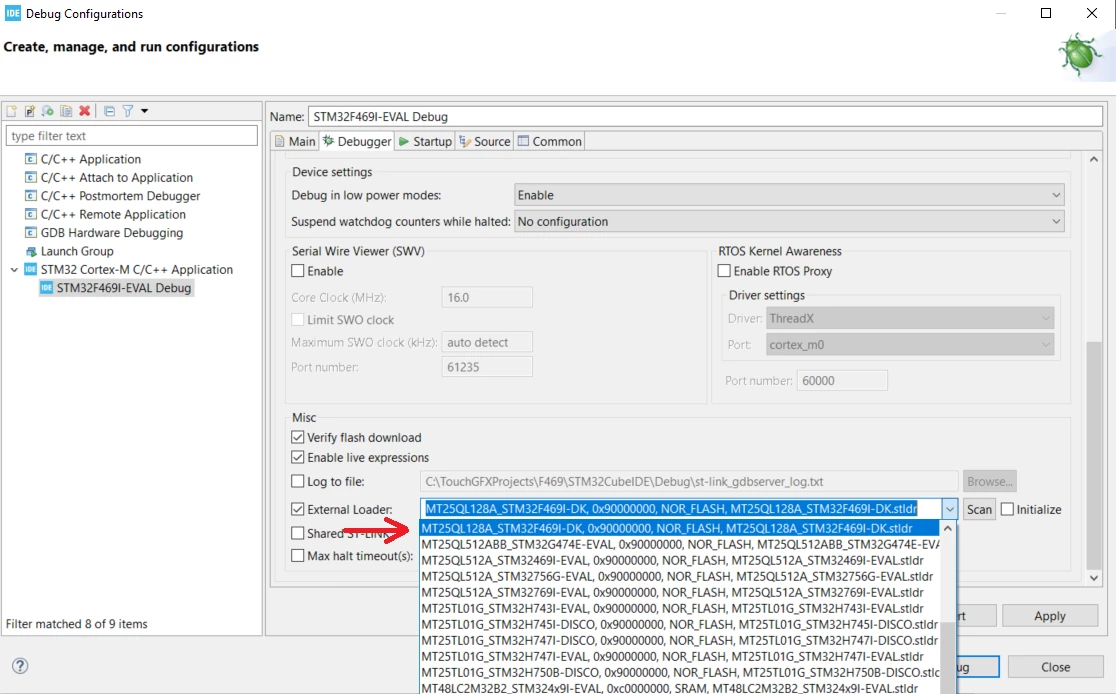

mƎALLEm
November 19, 2021
I don't have this STM32F469I-DISCO board to test.. but please check the flasher configuration in CubeIDE and select this one:

wired
wiredAuthor
Senior II
December 16, 2021
After getting the bad background color from using version 3.0.4, I went back to my original project and repeated what SofLit suggested (at least part of it - the flash configuration that was pointed out did not exist). This time I was able to compile with no errors and run the debugger.
