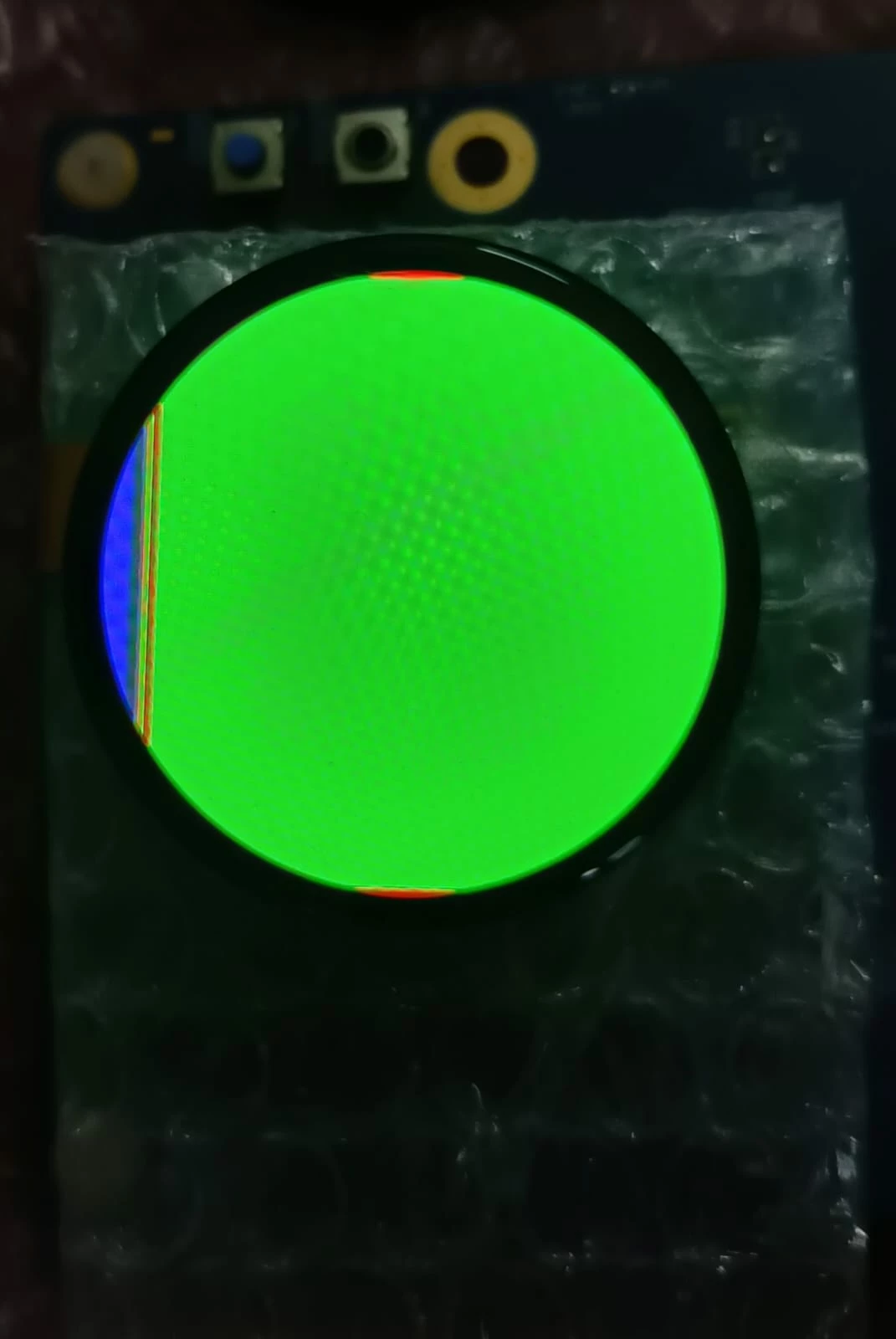

Hi, I'm using a custom board based on STM32U5G9J-DK1.I am using DSI Video mode with double buffering, but i had some issues in the DSI video mode.
I am using CO5300 driver-based 466 X 466 Display which supports DSI video mode
I successfully got a display displaying the actual GUI but it is slightly shifted from the left and from upper and bottom side as well
I am attaching images here; the first image is the simulator, and the second is the actual display.
Simulator Image:
Actual Hardware:

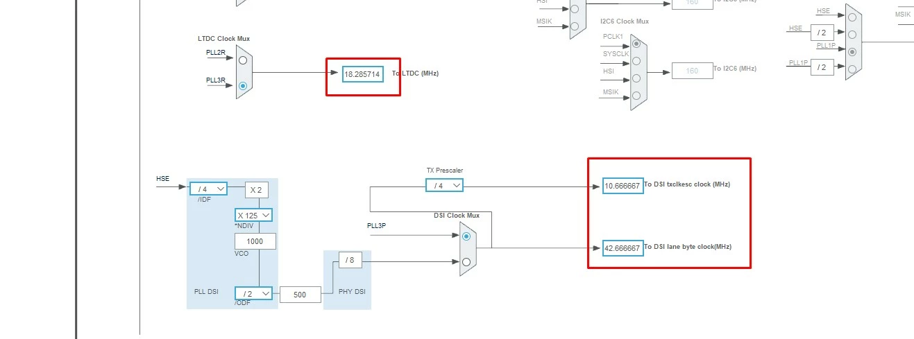

My configuration for clocks are as  given below

I have been debugging for over five days, yet the problem still exists. I am new to touchGFX so i dont have expertise like you guys.
Help will be really appreciated.

I solved the issue by changing my LTDC clock to 21.33 MHz and DSI clock to 42.666 Mhz.
A suggestion from @MM..1 really helped me to get the display working.

Sep 6, 2025 10:03 AM UTC
Start basic frame without TGFX run. And correct DSI config
 VidCfg.HorizontalSyncActive = 1;
 VidCfg.HorizontalBackPorch = 1;
 VidCfg.HorizontalLine = 466;
this numbers require be in DSI clock counting, no video clock as LTDC. For example if LTDC dotclock is 20MHZ and DSI data clock is 60M all this require multiply 60/20= x3   usw.
Too exist helping func for start pattern on DSI ... HAL_DSI_PatternGeneratorStart(&hdsi,0,1);

 PLLInit.PLLNDIV = 125;
 PLLInit.PLLIDF = DSI_PLL_IN_DIV4;
 PLLInit.PLLODF = DSI_PLL_OUT_DIV2;
 PLLInit.PLLVCORange = DSI_DPHY_VCO_FRANGE_800MHZ_1GHZ;
 PLLInit.PLLChargePump = DSI_PLL_CHARGE_PUMP_2000HZ_4400HZ;
 PLLInit.PLLTuning = DSI_PLL_LOOP_FILTER_2000HZ_4400HZ;

Hello, have you tried changing line 68 of ltdc file? This sets the start column.
HareshPrajapatiAuthorBest answer
Sep 12, 2025 11:54 AM UTC
below is my  DSI_VidCfgTypeDef VidCfg
