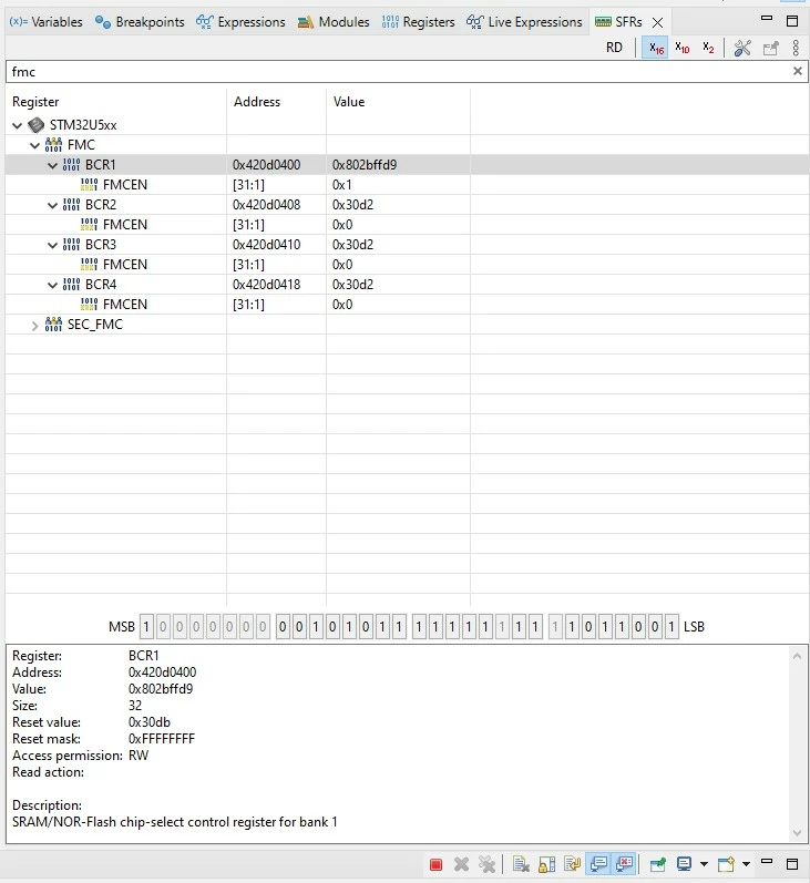

waclawek.jan
May 28, 2022
Have you set FMC to non-multiplexed 16-bit mode? Have you set properly GPIO for D9-D15? Read out and check/post content of FMC and GPIO registers.

waclawek.jan
May 28, 2022
> I can't decide between multiplexed or non-multiplexed mode.
It depends on the actual hardware. Unless you have an address latch (which you probably don't have, otherwise you would have known), you use non-multiplexed mode.
MGuth.1
MGuth.1Author
May 28, 2022
I'm not quite sure if I got the things you mean as I'm quite new to the Cube environment, but I hope I found the correct data :) If not, please let me know...
