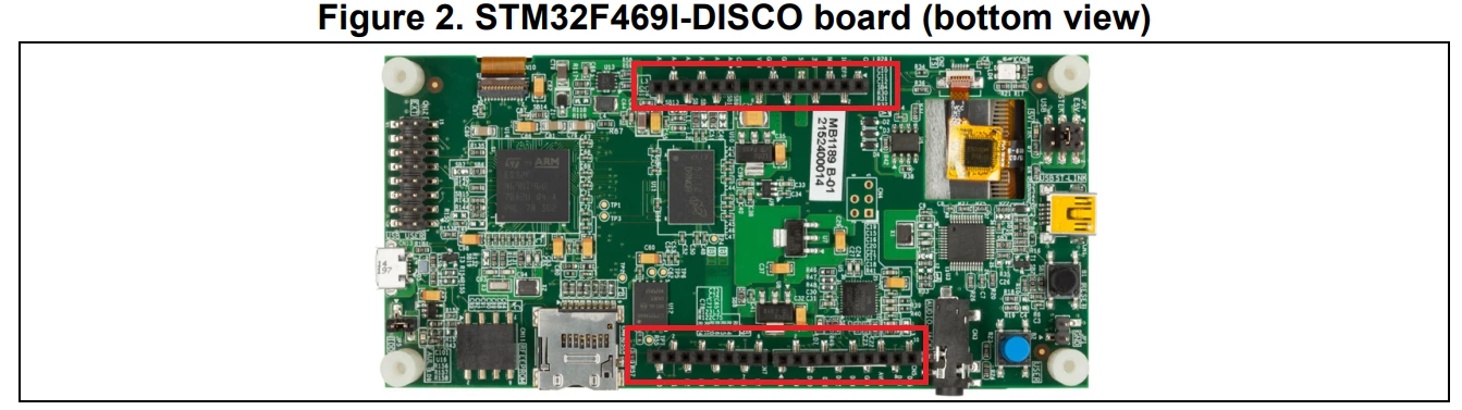

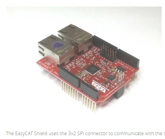

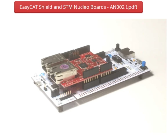

i would like to ask if i can send some data (numbers for exemple ) from my screen STM32F469I-DISCO to my system using EasyCAT Shield (ethercat protocol )
you will find attached photos as an example
best regards
mƎALLEm
mƎALLEmBest answer
November 19, 2021
The first photo shows a Nucleo board and not a Disco board ;) .
So, if you are really talking about STM32F469I-DISCO board, and EasyCAT has Arduino compatible connectors, you can plug the Shield directly to the STM32F469I-DISCO board since the latter also has Arduino compatible connectors.

yes because I have not yet received the STM32F469I-DISCO. i will use the arduino pin like you said
