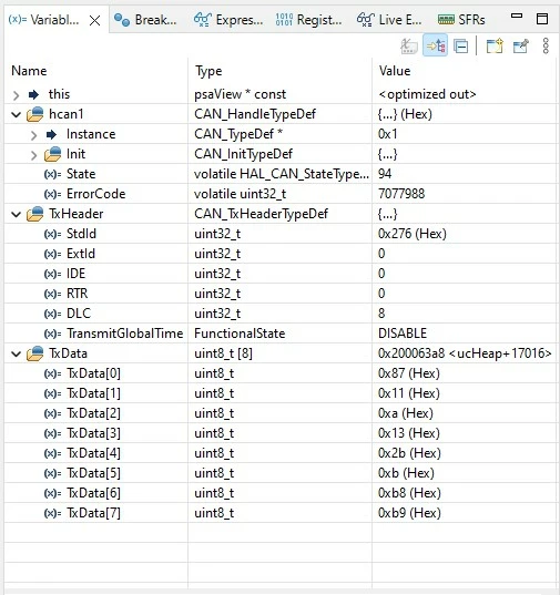

I'm developing a project with TouchGfx and Cube IDE that I'll be using to send CAN bus messages to wakeup automotive components like ecu's and dashboards. I've made all the GUI and also tested the buttons by activating the onboard led's. I've made the connection to CAN1 (that is connected to micro USB port and i've already tested and it's working fine (making a simple project without touchgfx) but I'm lost on how to send my messages from the GUI by pressing a button. I've seen some examples that put the code on the files like Screen1View.cpp and I've tested the led's example sucessfuly doing that but no CAN bus.
Configured CAN1 for 500kbit's, RX pullup, and all atached to MCP2515 transceiver.
I've tried also other similar methods like UART send but can't get CAN working.
Can you point me to some tutorials or tell me the best way to do it?
Thank you for your help!!!

The code I'm using is pasted bellow. I have the button that activates the led and also the button that shoul send the CAN message. Debuging the code I can see that the message is loaded to TxMailbox but I can't get it with my CAN Sniffer (I'm using Peak's P-CAN).
CODE:
void psaView::psa_exe()
CAN_HandleTypeDef hcan1;
HAL_CAN_Start(&hcan1);
CAN_TxHeaderTypeDef TxHeader;
uint8_t TxData[8];
while (1)
// Message 276
TxHeader.StdId = 0x276;
TxHeader.ExtId = 0;
TxHeader.RTR = CAN_RTR_DATA;
TxHeader.IDE = CAN_ID_STD;
TxHeader.DLC = 8;
TxData[0] = 0x87;
TxData[1] = 0x11;
TxData[2] = 0x0A;
TxData[3] = 0x13;
TxData[4] = 0x2B;
TxData[5] = 0x0B;
TxData[6] = 0xB8;
TxData[7] = 0xB9;
if (HAL_CAN_AddTxMessage(&hcan1, &TxHeader, TxData, NULL) != HAL_OK)
Error_Handler();
HAL_Delay(1000);
void psaView::psa_exe_2()
HAL_GPIO_TogglePin(GPIOD, GPIO_PIN_4); /*LED on board ON OFF*/
Thank you!!

I've tested what you said and I have the led on and off every second but no CAN message. The strange thing is that the message is loaded to Tx Mailbox but I have no transmission. I have a BP at:
and the result is on the image atached.
Thanks

@Karl Yamashita thank you for your answer!! It was my mistake, sorry - I'm using MCP2551. If I compile a simple project with CAN 1 and 2 active I can see the messages being sent with my Peak PCanUSB on both CAN1 and CAN2 and I can change the CAN bitrate. I think the problem is that my program never get one available mailbox but I can't figure it out. Can someone tell me how do I check my mailboxes when debuging my code? I've put some breakpoints and I can see that my messages are loaded but I think they are waitng for available mailboxes.
Thank you for your great help!!!!

I found that if I insert breakpoint at
MX_CAN1_Init();
pressing F5 the code jumps to this line
hcan1.Init.TransmitFifoPriority = DISABLE;
and does not load the CAN initialization values like prescaler and parameters.
When it arrives to
if(HAL_CAN_AddTxMessage(&hcan2, &TxHeader, TxData, NULL) != HAL_OK)
stepping through debug with F5 I get CAN NOT INITIALIZED.
Why it's jumping the CAN parameters loading?
I've made a new project just with CAN and GPIO for led and if I step the code with F5 I get all the parameters loaded.
What can be the problem?
Thanks for all the help!!!!
