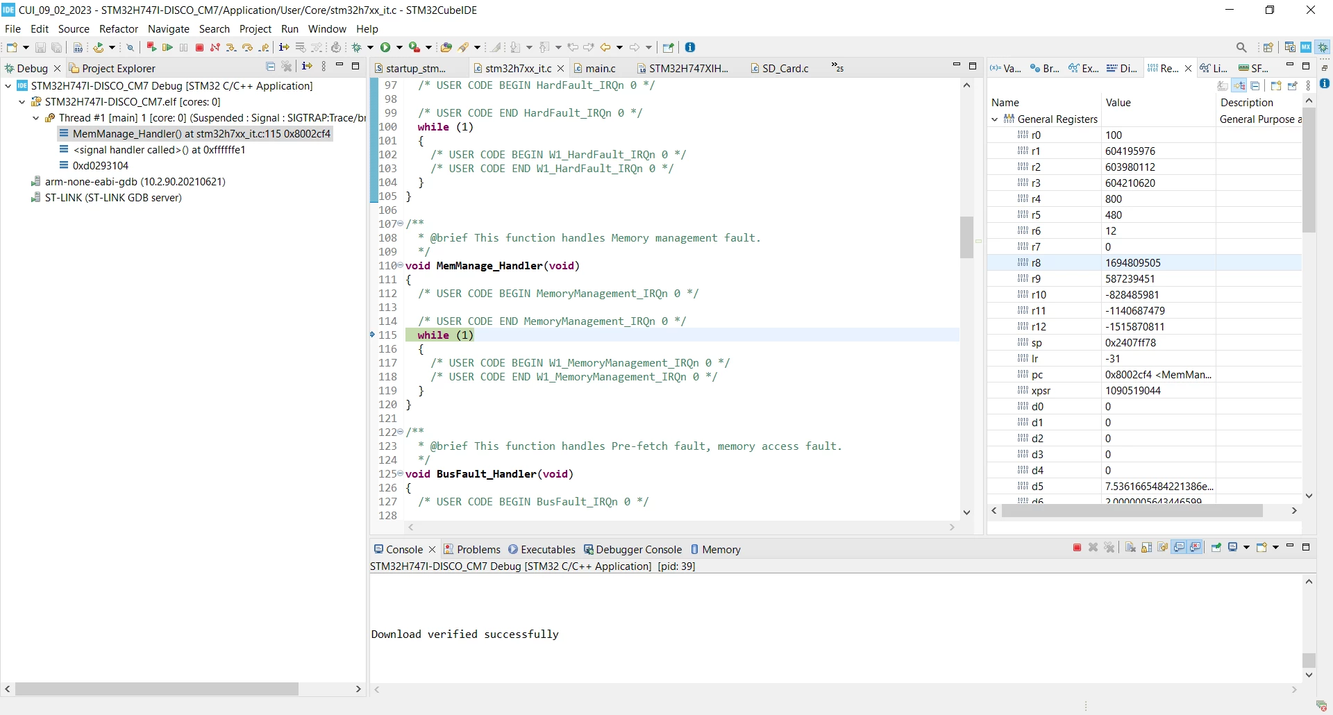

Dear all, I have an issue that only impacts floats and doubles when converted to strings using snprintf which are then stored to an SD card. The save is run in a dedicated task using TouchGFX and I am disabling dcache before and re-enabling after saving. If I write standard strings or integers (converted to strings via snprintf), there is no issue, the task exits normally and returns to the save screen. If I attempt to save any float or a double, the program has a Memory Management fault (attached). However, the data has been written to the card successfully. Would anyone be able to point me to a solution?

Hello @JSext.1​,
Could you please screenshot 0xE000ED28?
