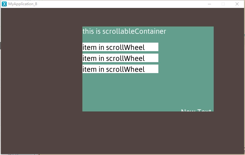

I put a ScrollWheel inside ScrollableContainer, then the ScrollWheel can not be scrolled.
How to go around it?

Could you provide some code or pictures of your project? With more information we will have a better understanding on what you want to do.

the scrollWheel with 10 items is put inside a scrollableContainer, click item in scrollWheel is ok, but can not drag up or down.

What is the use of your scrollableContainer? Can it be replaced by a swipeContainer?
It is not possible to differentiate the swipe for the two containers, therefor you are not able to drag up or down. A swipe container where you swipe horizontaly can solve this issue if it makes sense for your project.
Have a look at the code Alexandre gave for a similar question.
