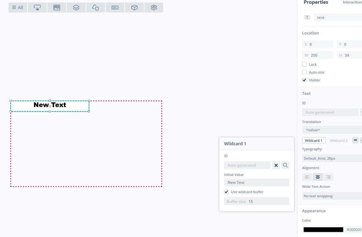

Here is my Container  (MenuItem):
Here is how I set up my text:

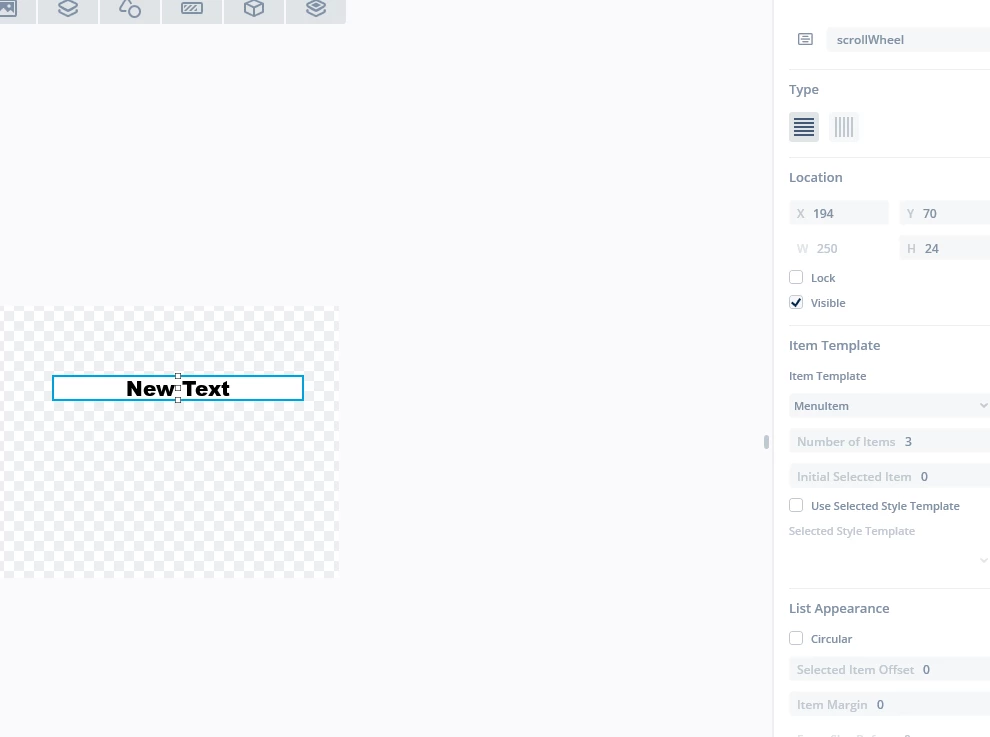

scrollWheel:
Here is Container MenuItem.cpp:
#include <gui/containers/MenuItem.hpp>
#include <texts/TextKeysAndLanguages.hpp>
#include <BitmapDatabase.hpp>
MenuItem::MenuItem()
void MenuItem::initialize()
 MenuItemBase::initialize();
void MenuItem::setWheelElements(int item)
	switch (item)
	case 0:
		text.invalidate();
		text.setTypedText(TypedText(T_S1));
		break;
	case 1:
		text.invalidate();
			text.setTypedText(TypedText(T_S2));
			break;
	case 2:
		text.invalidate();
			text.setTypedText(TypedText(T_S3));
			break;

I increased the size of the scrollWheel window (still making it only show one item) it responds much better and I do now get valid itemIndex, accept the index number does agree to what I thought it should be.
In other words,  I assume Option A should have index 0,  Option B index 1 and Option AB index 2,
but I get Option A index 1, Option B index 2 and Option AB index 0
Anyone know why the indexes as not as expected?

Hello @FJB2069 ,
Getting the "right" index when using a scrollWheel is tricky.
This is because it is not meant to be accessed. Instead, the scrollWheel should be used as a menu selector to navigate through your application or to select various options.
Therefore, you should only use the 2 callbacks provided setitempressedcallback and setitemselectedcallback .
So in a way I am avoiding your question because this is not how you should use the scrollWheel and I invite you to not use the index but only the 2 callbacks if you can.
If you really want to use the index of the elements, you should use the scrollList.
I hope this helps.
