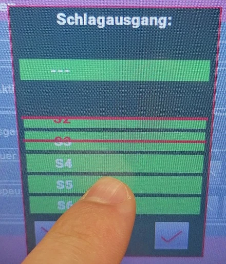

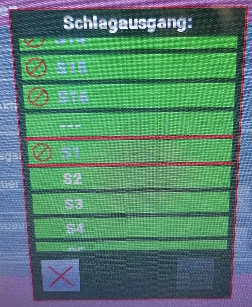

Scrollwheel hides Items above the selected Item when using SelectedItemOffset and CircularMode not enabled
Im using Scrollwheels on different screens. Wherever I move the selected Item to the middle of the list by increasing the SelectedItemOffset, Items above the selected Item (middle of the list) tend to disappear. As soon as I activate the Circular mode, everything runs fine.
Does anyone else had similiar behaviour? I tried to provoke this with the very similar ScrollWheel/List example, but there it is running fine.
I'm using the current TouchGFX 4.20.

I think I found the solution. I was looking at your code and didn't find anything different compared to mine. But looking at the Designer I noticed that I have set the Number of Items to 1 and you had 16. So I increased the value and now it's working. I thought this value is irrelevant, because the item count will be changed at runtime anyway.
Looking at the changes the code generator makes, this looks like a bug inside the TouchGFX lib when setting the Selected Item Offset to a value where no items exist at the moment of the function call (in the constructor of the parent screen/container):
swOutput.setNumberOfItems(1);
swOutput.setSelectedItemOffset(125);
vs.
swOutput.setNumberOfItems(10);
