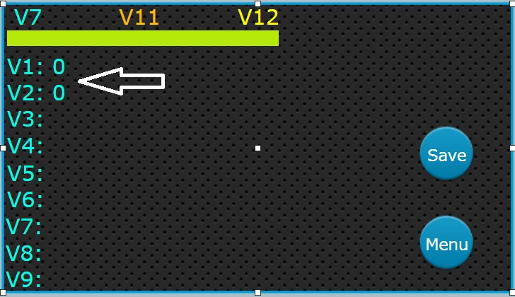

Hello again,
I have a bunch of measurement results that I would like to display on the screen but space is getting too little. I looked at the scrollable container example, where the long text was put as a text resource (or whatever that is). However, my measurement results aren't, of course, static text so I would need to use wildcard text buffers. How could I implement this?

What do you meant by "Space is getting too little"? Could you use multiple textArea widgets instead of one big one?
Could you add a screenshot of what your project looks like on Designer and possibly a bit more detail on what you wish to show? Some of the other examples might help you where they show a fixed text and changing values (for example the RadioButton example where Ressource is used but with non static text)

here is an example. I am using multiple text area widgets. There is a static text area for each measurement result (V1, V2..etc) and then a wildcard buffer for each of them. There are more results I would like to display than I can get fit on the display. Therefore I thought a scrollable container would be good, but I don't know how to implement that with wildcard values. I know how to do that with static text or normally with wildcard values when everything fits on the screen. I can make the font size smaller, but you can only do that for a certain point and it's not a good solution.

Instead of a scrollable container use a scollWheel or scrollList. I believe this is exactly what you need for your situation since you can have as many elements as you like with the textArea widgets you need. You can have a look at Tutorial 4 and at some of the projects using those widgets (some examples configure the scrollWheel or list through code and not designer directly, like in Demo 3).
