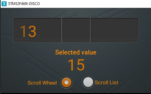

Fran Marala
October 9, 2020
0693W000004JDQIQA4.pngHi again, I have just tested the example provided in UI template provided for ST (using 4.14 version), when you click the radio button Scroll Whell, there you can see the problem, there is a difference between the selected value and the value show into the scroll whell.

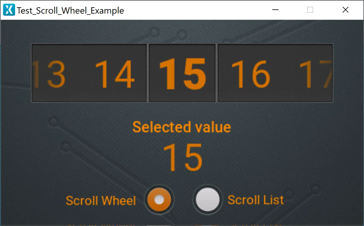

Alexandre RENOUX
Visitor II
October 13, 2020
Your simulator is not showing something correct indeed. What did you do exactly ?
Because I did the same thing (with any version actually, you should never have this) and we tested it dozens of times. This is what I get :
0693W000004JWujQAG.pngAlso to download TouchGFX 4.15, simply go to this page https://www.st.com/en/development-tools/touchgfxdesigner.html and click on the "Get Software" button.
/Alexandre
Fran Marala
October 13, 2020
0693W000004JXuQQAW.pngHi, about my simulator you are right is strange because now is working properly.
