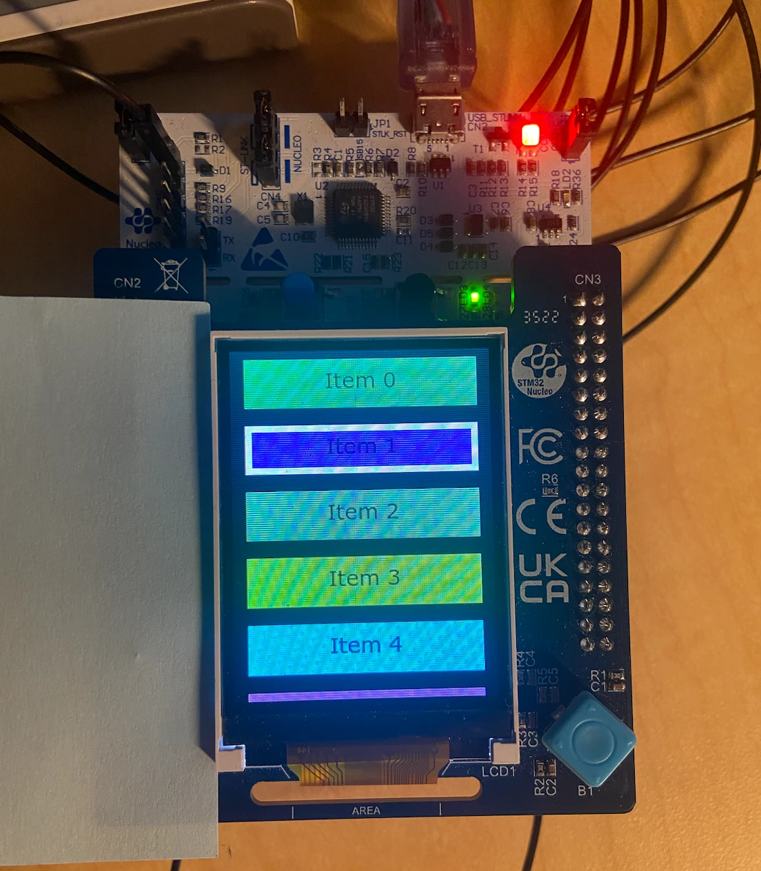

Hey @Arthur_UW,
I think if you manually change the selected item instead of using animateToItem(), you will be able to get better performance. I created a simple example to showcase what I mean, Keep in mind, it is not a perfect solution at all; it is just for demonstrating the idea of not using animateToItem.
I checked the performance on NUCLEO-G071RB + GFX01M2 and it looks acceptable.
I hope it can help you achieve what you are looking for!

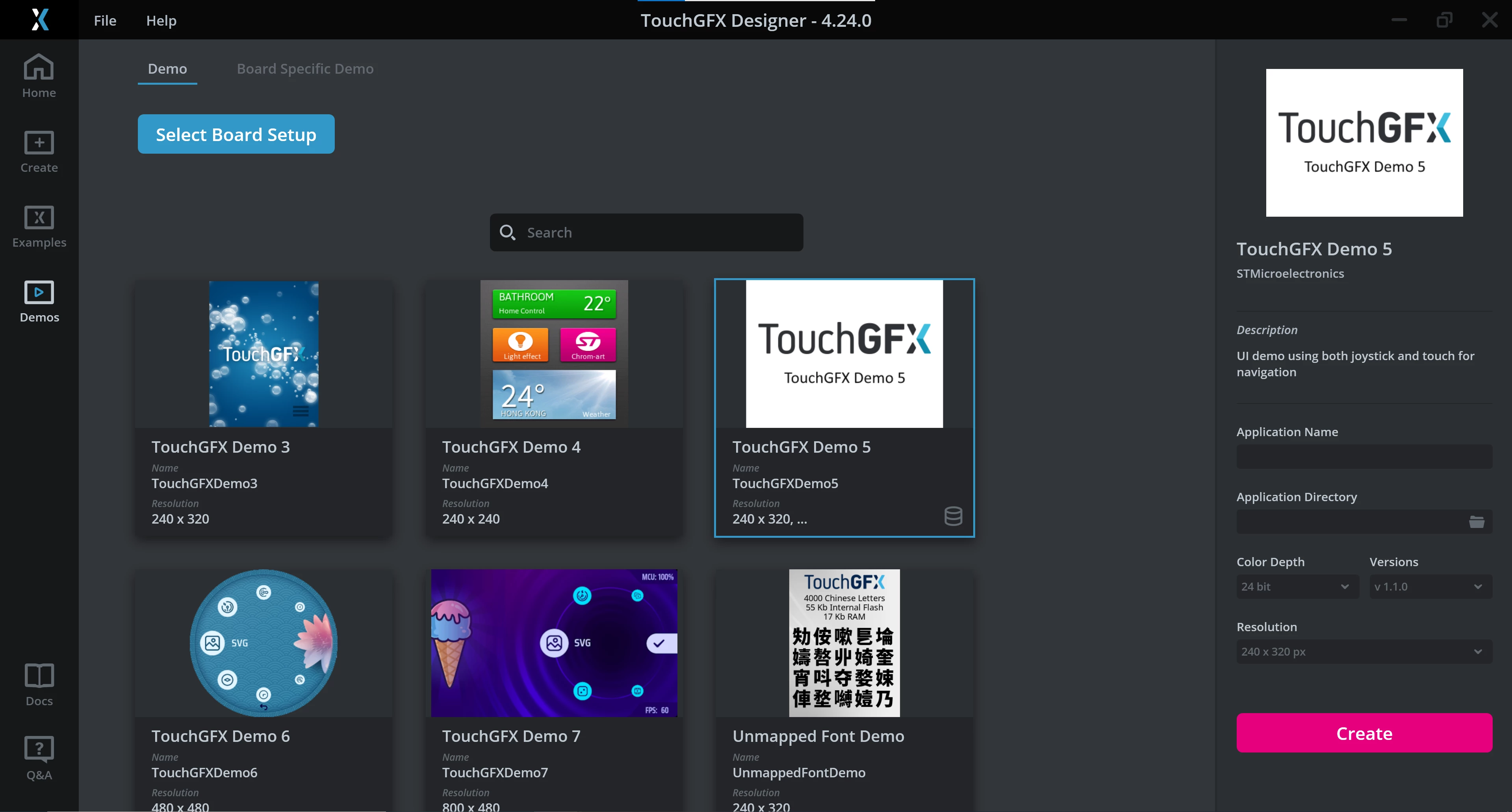

Hello @Arthur_UW,
As you mentioned, the NUCLEO G071RB is not strongest board available. However, I think there are a couple of tricks to use to help you achieve what you need.
Instead of using Scroll List and animating your background, use Scroll Wheel that supports a template for the selected item.
You can take a look at TouchGFX Demo 5, in the language selection screen, you can see how it scroll wheel is used.
TouchGFX Demo 5TouchGFX Demo 5
I hope this helps you. Let me know if you have more questions.
Mohammad MORADIST Software Developer | TouchGFX

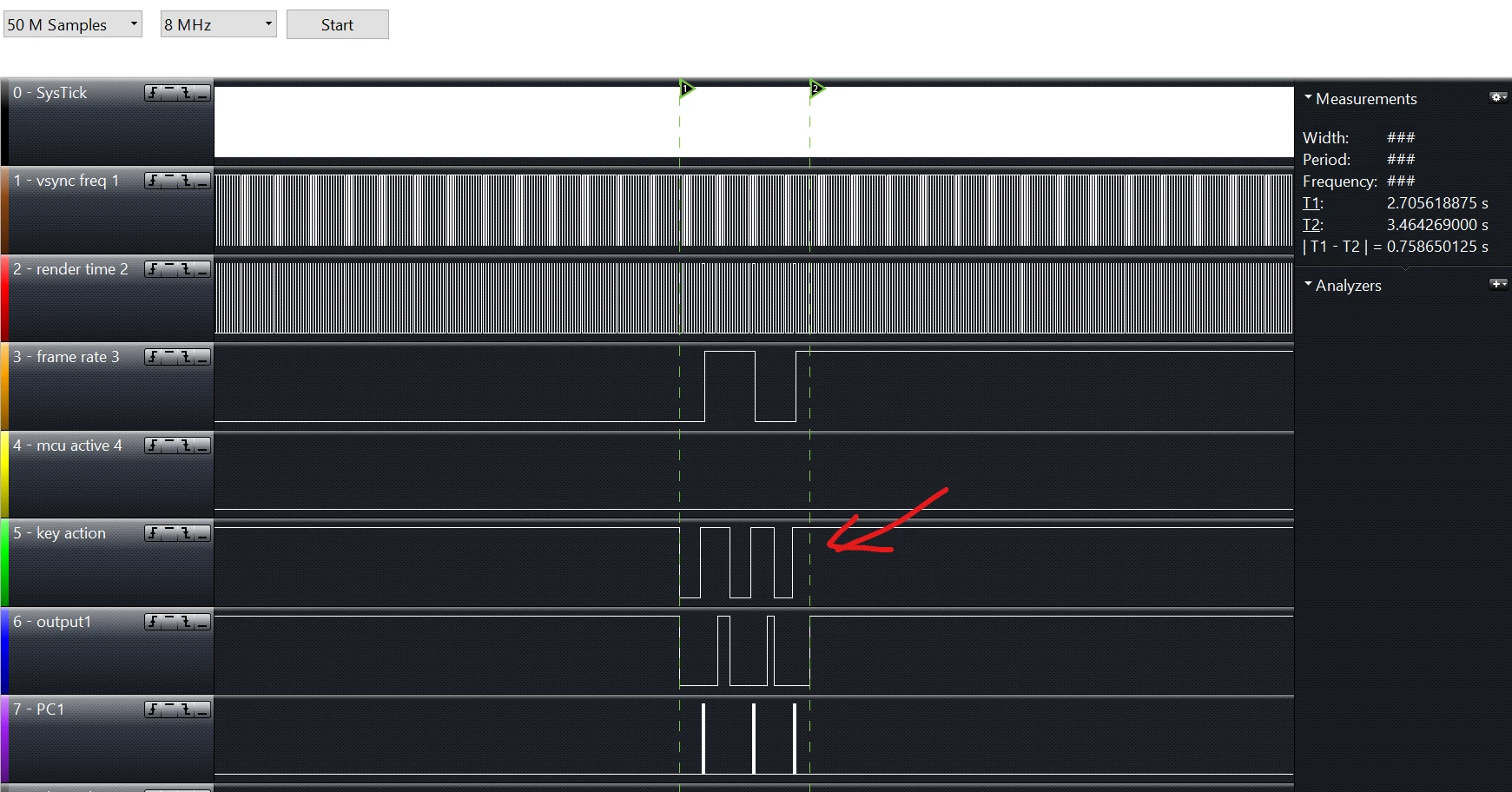

I did a test on my previous scroll list example, I pushed the 'down' button three times quickly in 0.7s and captured this waveform:
Zoom in:
(ch0 is 1ms systick, 1~4 are following nucleo's settings :
Performance testing can be done using the GPIO pins designated with the following signals:
- VSYNC_FREQ - Pin PD9(CN10 - PIN 38)Pin is toggled at each VSYNC
- RENDER_TIME - Pin PD8(CN10 - PIN 36)Pin is high when frame rendering begins, low when finished
- FRAME_RATE - Pin PC5(CN10 - PIN 37)Pin is toggled when the frame buffers are swapped.
- MCU_ACTIVE - Pin PC4(CN10 - PIN 35)Pin is high when framework is utilizing the MCU.
My code was:

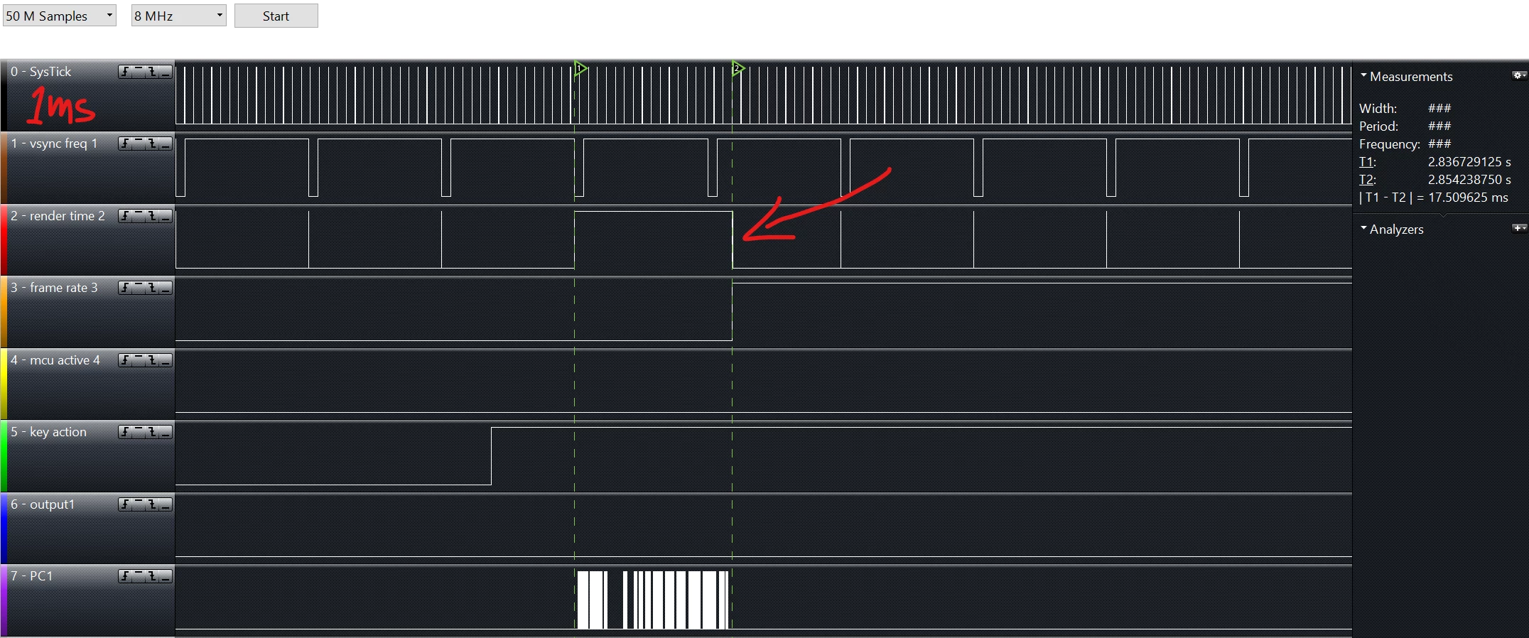

void Screen1View::key_down(){
	if(current_selected_index >=6){
		current_selected_index = 6;
	}else{
		current_selected_index++;
	scrollList1.animateToItem(current_selected_index);
	switch_to_new_selected_item(); //hide previous item's background and show new item's background.
From the waveform above, I can see the animation was done in a single cycle which max out the rendering time, causing the lagging effect.
I am thinking, I only changed 1/10 of the screen, which is way less than the band and cpu capability. Is there any setting I can use to fix this? I've tried this below but it did not work at all.
scrollList1.setAnimationSteps(0);//set 0 to disable moving animation, default=30, which is slow to eyes.
Aug 29, 2024 12:08 PM UTC
Hey @Arthur_UW,
Arthur_UW
Arthur_UWAuthor
Sep 1, 2024 3:50 AM UTC
Good, I flashed and tested the effect, and I think it's very good.
