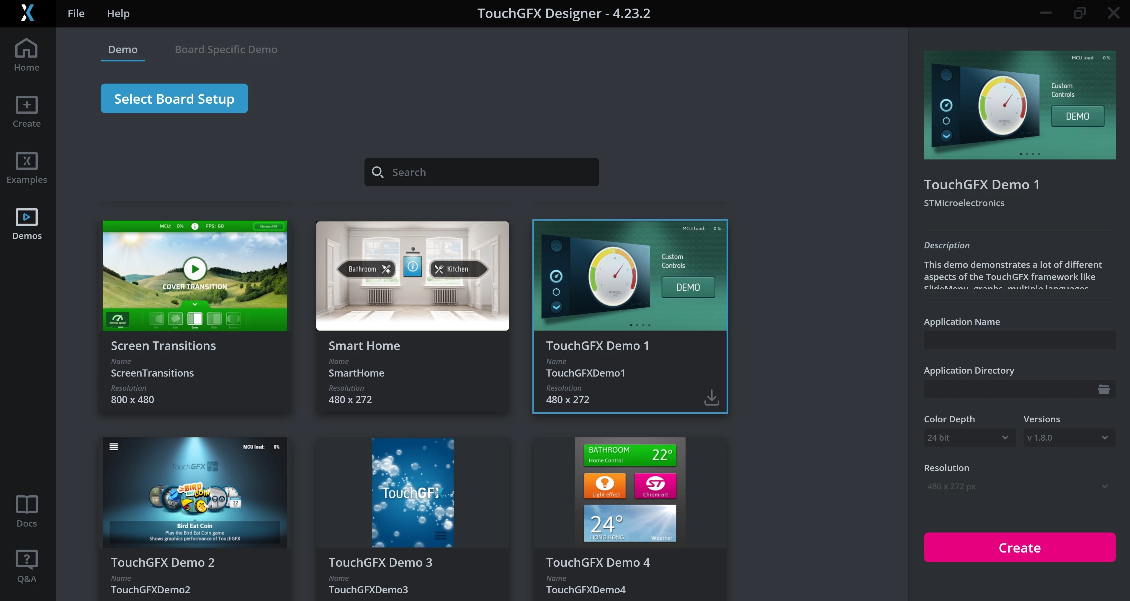

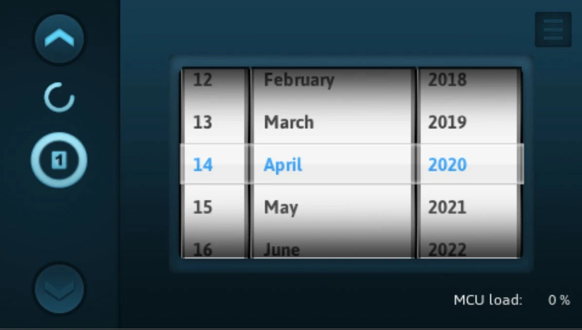

    I think what you are looking for is pretty similar to a date picker. You can see one example shared by @Juliette CRESPO here , and also there is another one available in TouchGFX Demo 1.
    TouchGFX Demo 1TouchGFX Demo 1
    Date Picker in TouchGFX Demo 1Date Picker in TouchGFX Demo 1
