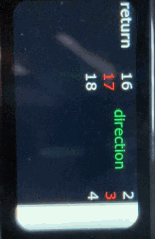

The screen tearing issue is as below. It looks always appear in the right area:

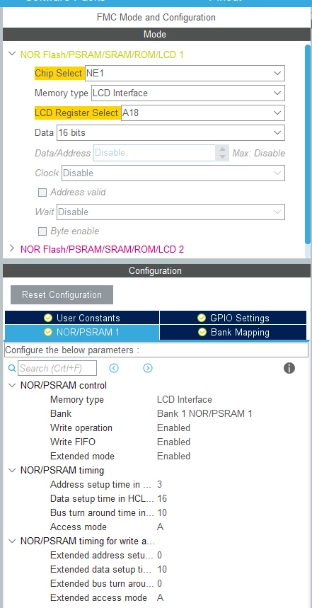

0693W000006GwEqQAK.gif​The screen is FMC16 bit parallel port, and the parameter is as below:
0693W000006GwKFQA0.pngAnd the screen has TE signal, the TE Interrupt function is an below:

The MCU is H750VBTx, and the white box is the part of my GUI, I write it for observing the tearing phenomenon.

So actually if your display interface is FMC, you are right to check the parameters for this display. Unfortunately I don't know about your custom display.
