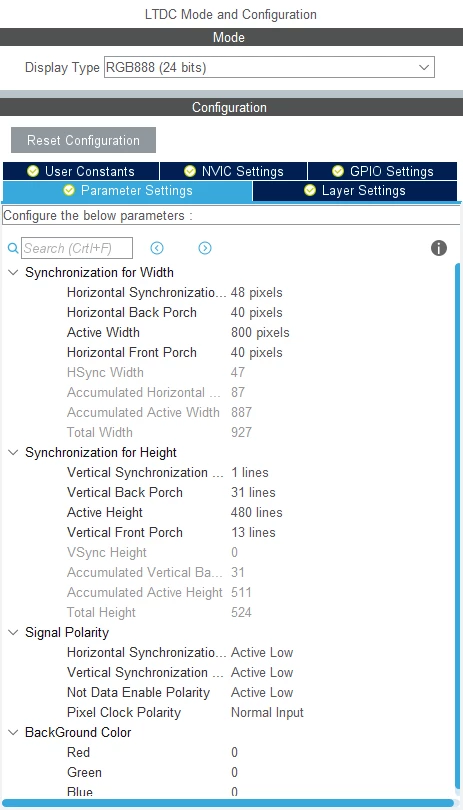

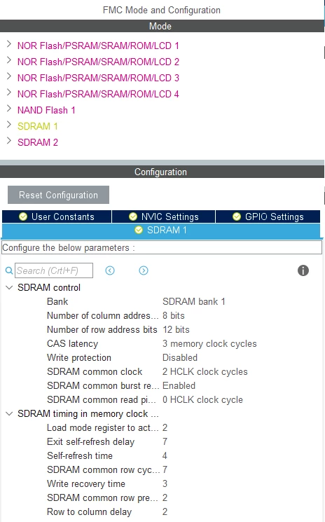

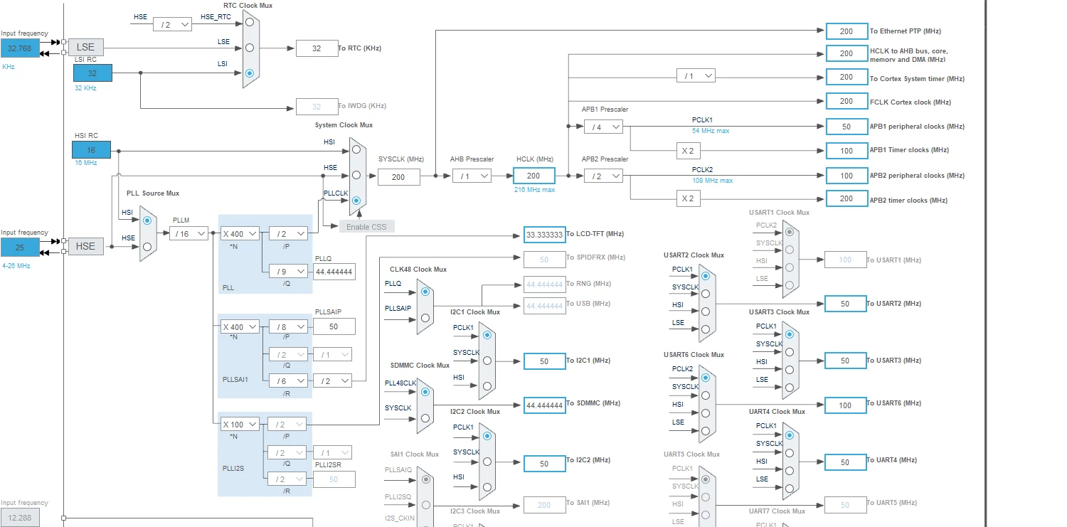

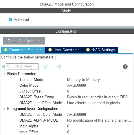

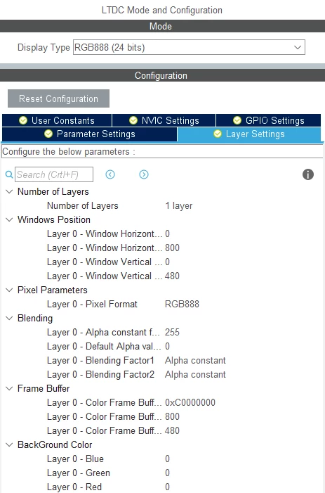

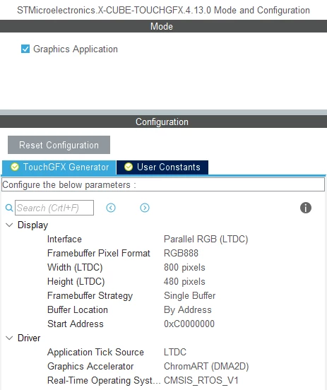

I am using the following screen and CPU : 4DLCD-70800480 and STM32F746BGT.
I configured the LTDC and TouchGFX parameter settings but the screen tears ...
I have attached all the configuration.
Best Regards
Best answer by Alexandre RENOUX
Your clock tree seems strange to me.
The LCD-TFT clock and the SDMMC clock looks wrong. If you look at the F746G-DISCO AT, the LCD-TFT clock is at 9.6 MHz. Try with this value and also try to avoid having clocks with a high number of decimals in any case.
/Alexandre

Did you have a look at the F746G-DISCO Application Template in the Designer ?
What kind of tearing do you notice ? Could you provide a picture of the issue ?

Hi Alexandre,
I have attached some photos of the problem.
As you can see, it makes a tear when I change screens (no animation is used).
Best regards
