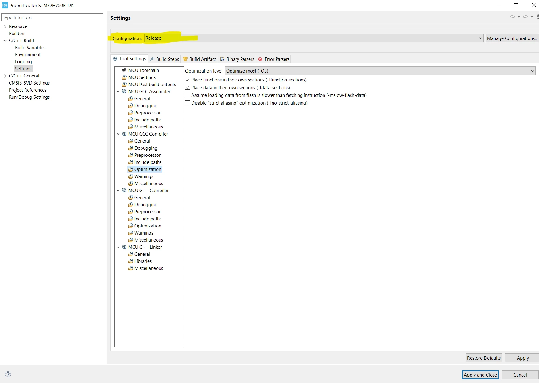

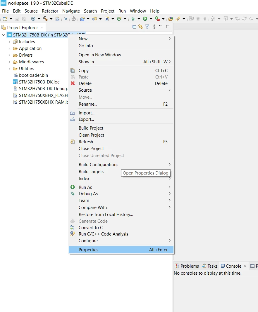

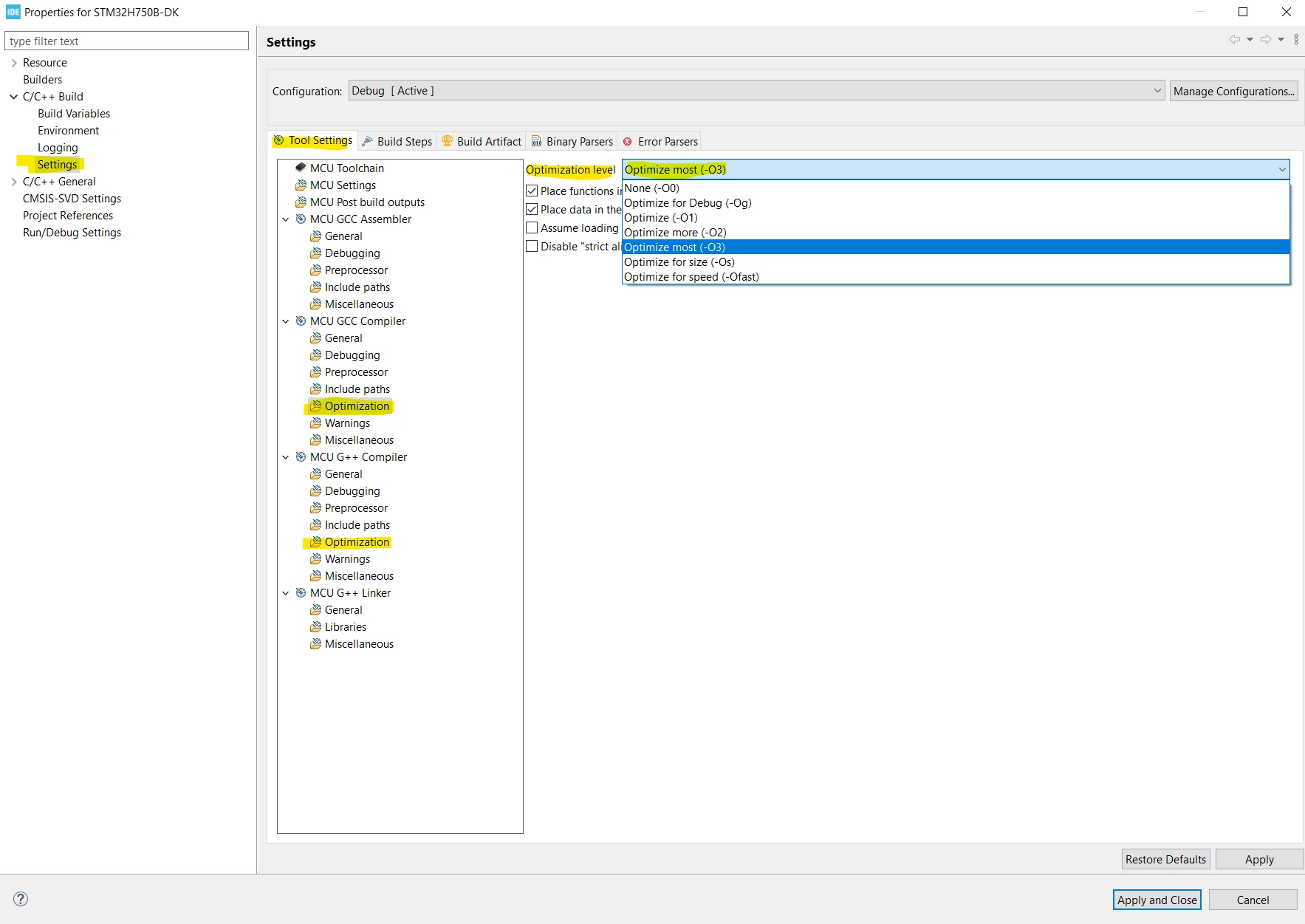

Ok, I think we know where the issue is then. We made a correction with TBS version 3.0.8 that fixes this issue. So I suggest you to try with the latest version of the TBS, with TouchGFX Designer 4.20.0 .
If you want to keep using TouchGFX Designer 4.18.1, you need to activate the option "optimize most" in STM32CubeIDE. Here's how you can do it :
1- Right click on your project > Properties
2- In Settings > Tool Settings > MCU GCC Compiler > Optimization > Select optimization level "Optimize most (-O3)
Do the same with MCU G++ Compiler > Optimization > Optimize most
3- Do the same with Release configuration
4- Apply and close, then recompile your project.
Let me know if that works.
/Osman
