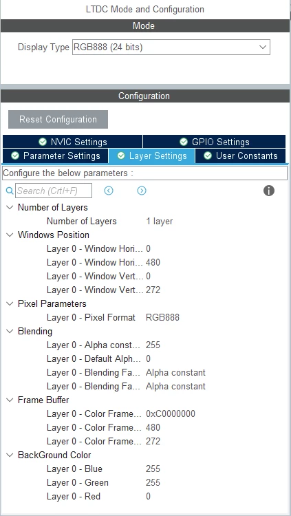

I use TouchGFX 4.16, CubeIDE, STM32F429ZI.
Screen shake occurs when text is written on the screen and when a slider is selected.
In the case of text, it is designed to be written every second.
I added a reference to "https://community.st.com/s/global-search/screen%20shake", but it didn't work.
  * Initialize TouchGFX
 hal.initialize();
 hal.setTouchSampleRate(5);
 hal.setFingerSize(20);
 hal.setDragThreshold(20);
How can I get rid of screen shake?

What MCU are you using? Does it have data cache like H7 series?
Look at discussion: ​https://community.st.com/s/question/0D53W00001Gl5lJSAR/stm32h743-weird-screen-flickering
Enabling cache and configure MPU properly gives huge speed improvement and I have no screen problems since then.

I use STM32F429ZI.

According to ST it has MPU, so try to see how set it up an use​ it for LTDC. May me it will help.

LTDC settings are attached image files.
