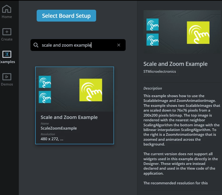

Can I scale image with TOUCHGFX at runtime? I need to change image width depends on text long

Hello heyo,
Yes it's exactly what a texture mapper widget is meant for :)
I invite you to have a look on the "Scale and Zoom Example" we provide on TouchGFX Designer, it does what you asked.
/Osman
