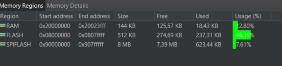

Feb 28, 2024 2:16 PM UTC
Thank you for your response. I am using NUCLEO STM32G0B1RE kit that have 64 MHz clock and 32 Mbits/s SPI. But the external flash IC is in custom board. DMA is activated. Memory of my flash IC has 8 MB. And indicator of capacity is ~8% for ext flash IC.
***Also, keep in mind that scalable images are heavy widgets for MCUs, so there might be a chance that the MCU cannot render them fast enough when they are stored on the External Flash
It's possible.
My memory state is the following SS.
