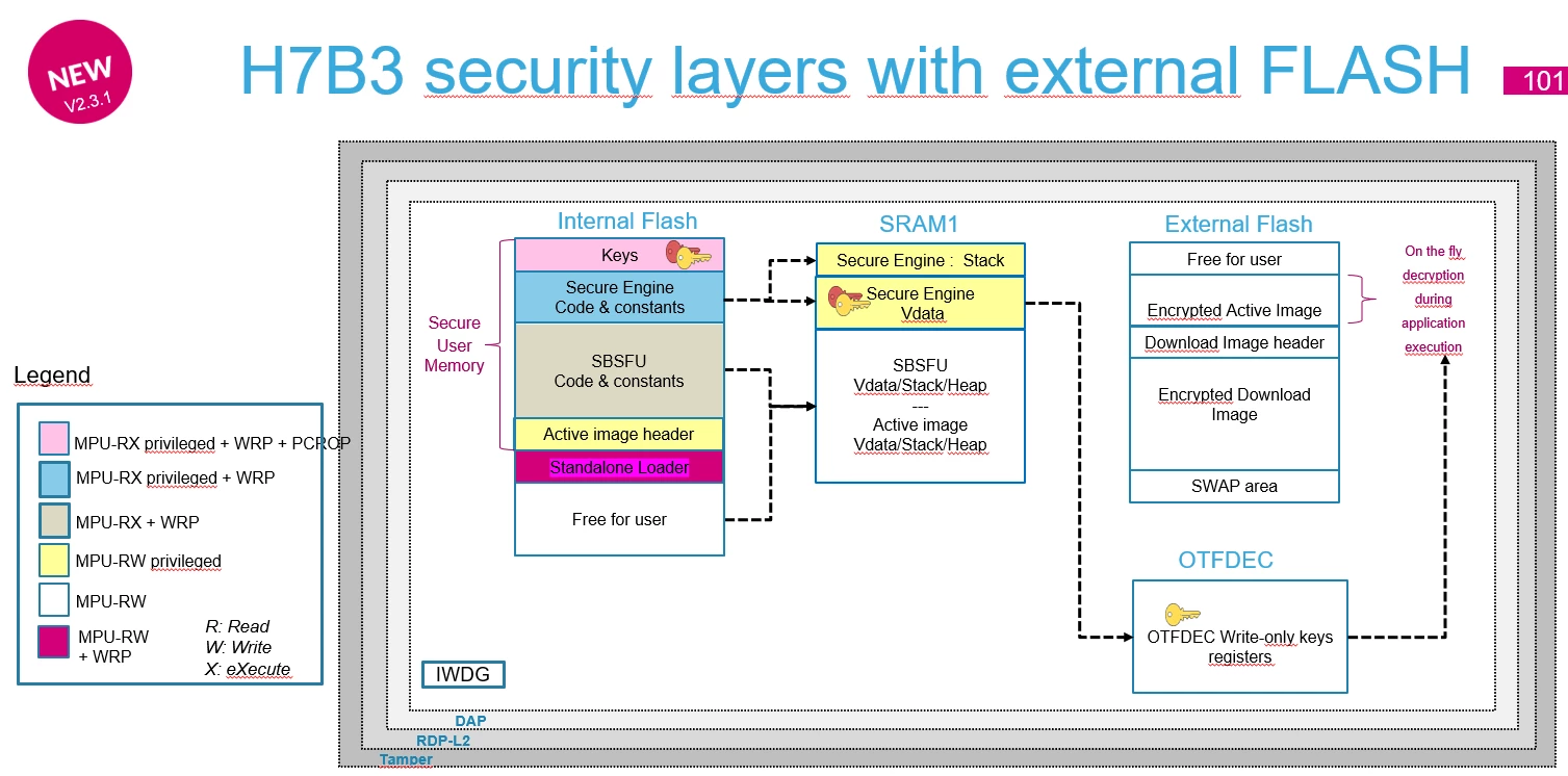

Fred
May 30, 2023 8:58 AM UTC
be careful that the idea is also that the slots stored in external FLASH are encrypted:

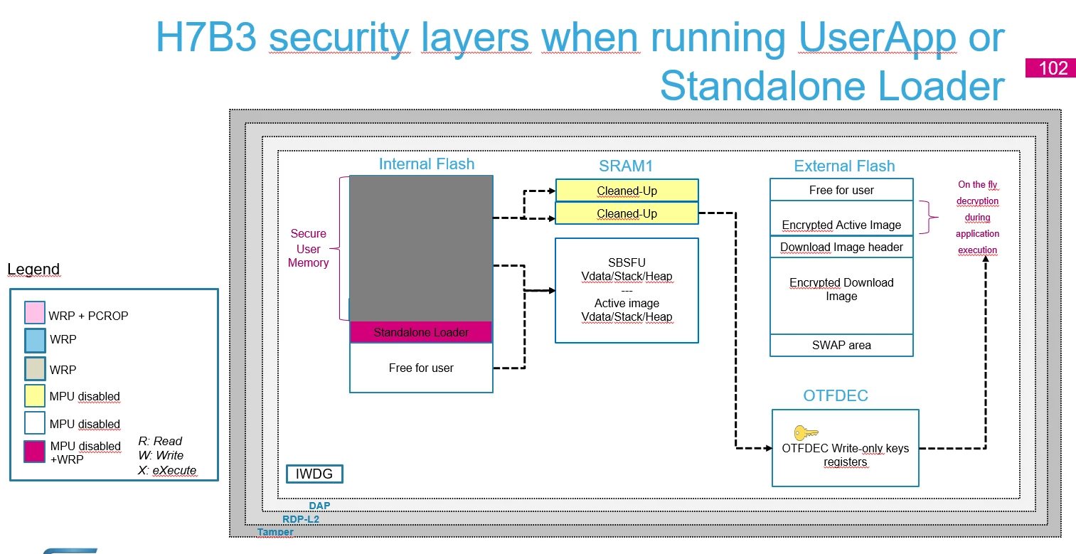

Fred
May 30, 2023 8:59 AM UTC
Which gives when running your application:
sute
suteAuthor
May 30, 2023 9:24 AM UTC
Thanks for the reply. This is interesting and I think I may have misunderstood something then, as I remember reading that the external flash is not encrypted (can't remember where though). If this is the case then what if I have one active slot in the internal flash for which there is a corresponding download slot in the external flash. Is the data in the external flash always encrypted?
