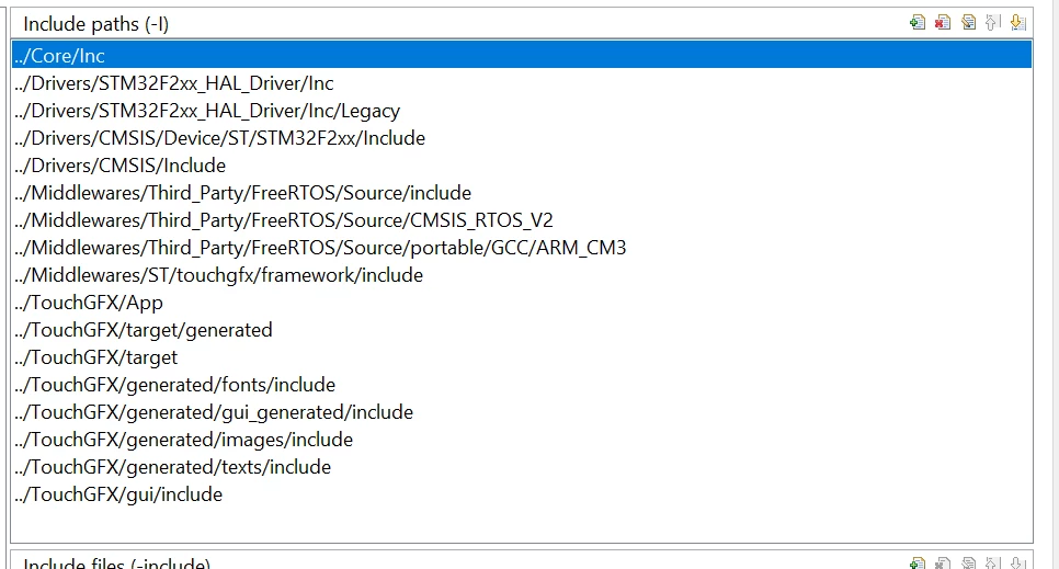

thank you for your answer. So far, I tried the following, all with help from the CubeIDE:
I created an application (1) targeting the STM32F207VG and set up FreeRTOS, CRC and the FSMC for the display
I created an application (2) targeting the STM32F407VG and added TouchGFX and FreeRTOS.
In TouchGFX Designer, I simply added a button and created code.

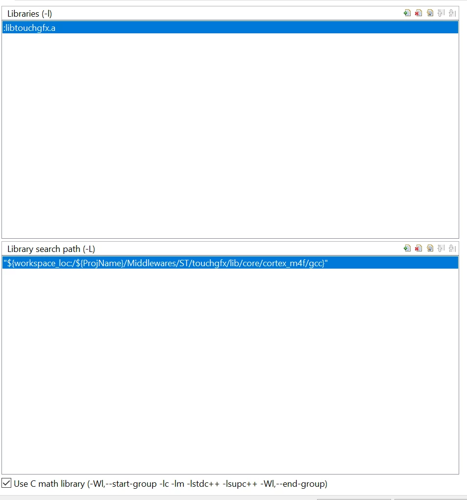

I then tried copying the TouchGFX and Middleware/ST from application 2 to apllication 1. I added the include paths to the C and C++ sections in application 1 and libtouchgfx.a from the core_m4f/gcc folder. I then had to exclude the Middlewares/ST/TouchGFX folder from building. Is this correct?

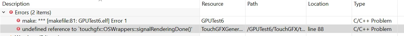

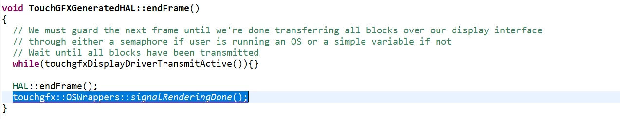

Now I am stuck at two problems. In TouchGFXGeneratedHAL.cpp the method DisplayDriverTransmitBlock(...) is being called in flushFrameBuffer(...), but only touchgfxDisplayDriverTransmitBlock is defined as extern "C". Is this an error in the generated file? The second error is an undefined reference to touchgfx::OSWrappers::signalRenderingDone(). I made shure that the corresponding cpp file is being compiled, but the error continues.
0693W000004K0m6QAC.png0693W000004K0mQQAS.pngDid I miss something? Are the includes correct?

Looks like there has been no activity on this post for 21 days but I too am seeing both these problems using an SPI partial buffer strategy.
Adding touchgfx prefix to the mismatched name will fix the DisplayDriverTransmitBlock() problem however that then results in the undefined reference that Jonas has encountered.

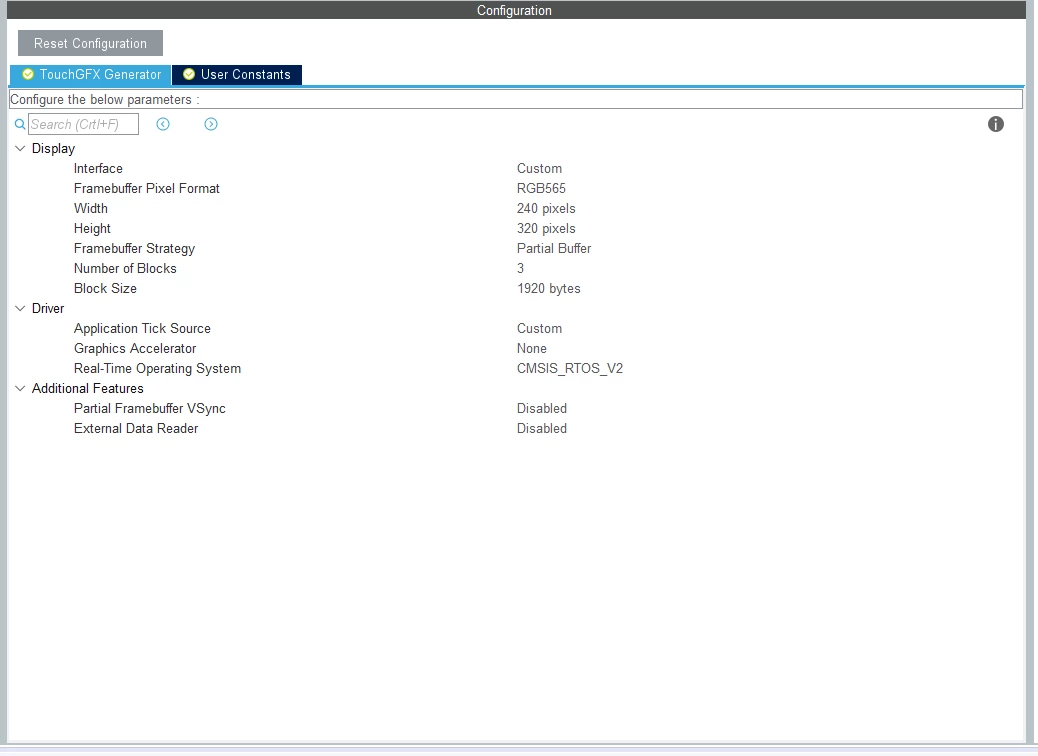

I´m receiving same errors when configuring partial buffer mode with touchgfx 4.15.0 with STM32F4

I have the same problem too: undefined reference to `touchgfx::OSWrappers::signalRenderingDone()' in TouchGFXGeneratedHAL.cpp

This is an known issue that will be fixed in the next release 4.16 coming out end of this year.
The signalRenderingDone() function is not implemented correctly. To solve manually this issue, simply add the following code to your OSWrappers.cpp
* Signal that the rendering of the frame has completed. Used by
* some systems to avoid using any previous vsync.
void OSWrappers::signalRenderingDone()
 osMessageQueueReset(vsync_queue);
Very sorry for the inconvenience.

thanks for the fix. I applied it, but a HardFault occurs when waitForVSync() is called during TouchGFXHAL::initialize() in TouchGFXHAL.cpp
Through the STM32CubeMX I added support for the FreeRTOS (CMSIS_V2) and modified the StartDefaultTask in maic.c file as follows:

We've fixed an error where `touchgfx::OSWrappers::signalRenderingDone()' was required, despite RTOS being selected (it's only useful it there's no OS).
