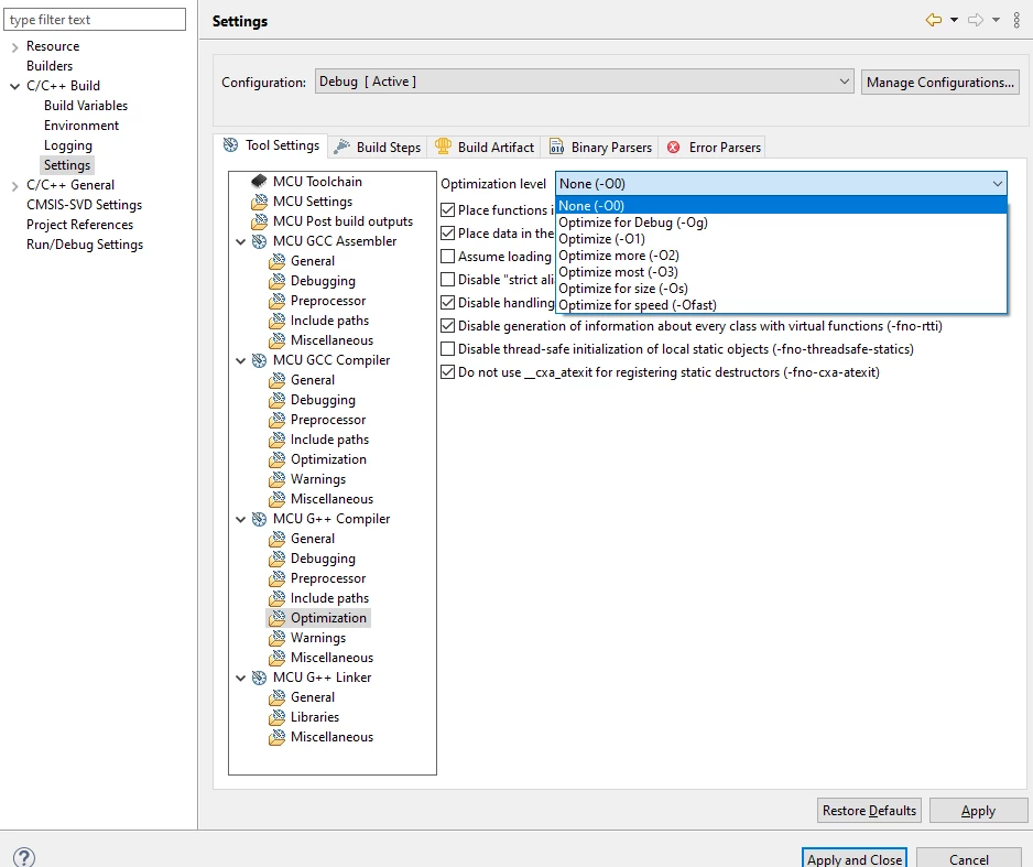

Optimize level config for C and C++ ???
Assets in external flash ?
January 17, 2025
Thanks for your reply.
Assets are kept in ext Flash only and can you please elaborate this Optimize level config for C and C++ as i am not aware of it?
MM..1
January 17, 2025
try use higher value as you have now...
