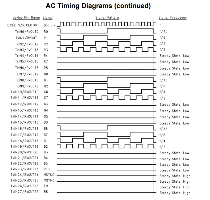

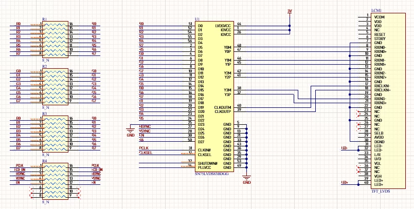

Hey,

Thank you very much for the solution. I have looked into the DS90C385A datasheet and the assignement of RGB lines to the pins seems quite disorderly and chaotic (but most likely on purpose?). It seems that you have the same assignment in your schematic. Is this assignment compatible with most screeen manufacturers or is that assignment vendor specific?
ZExpo.1
Oct 28, 2023 10:03 AM UTC
Generally we see a lot of Manufacturers using these connections that uses FPC as general setup but you have to check with the datasheet for pin outs which sometime are manufacturer specific.
