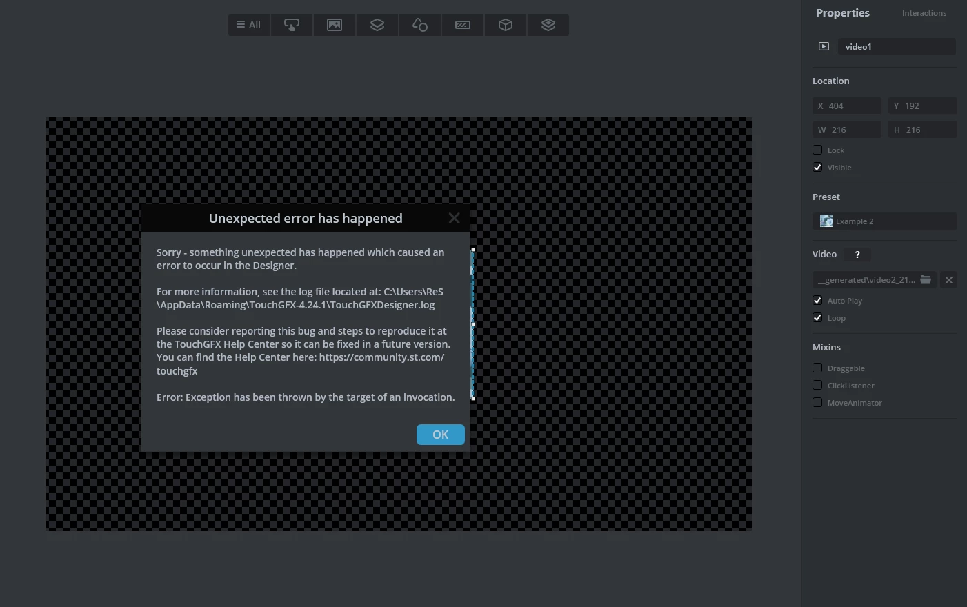

Feb 7, 2025 2:09 PM UTC
Hello @GaetanGodart,
when I try to insert a video into a screen I get this error window. What is it about?
GaetanGodart
Feb 7, 2025 2:14 PM UTC
Hello @TechnicalPBG2025 ,
Can you reproduce the bug, then right after, send me the logs and tell me the steps to reproduce the issue so we can investigate?
Regards,
Gaetan GodartSoftware engineer at ST (TouchGFX)
