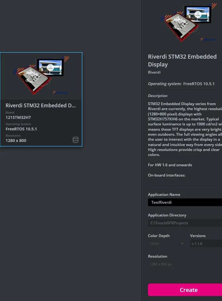

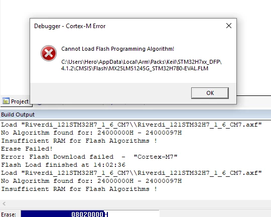

Hello I have a problem compiling TouchGFX for Keil. My procedure:
1/ Run TouchGFX Designer 4.25
2/ Create New project
3/ Go to tab – By Partners – select board Riverdi STM32 121STM32H7
4/ Click to Create
5/ Add Button ( for example)
6/ Click Generate CODE
7/ Go to project Folder and open ioc file Riverdi_121STM32H7_1_6.ioc STM32CubeMx v6.5
8/ Go to tab Middleware and Software pack Select FreeRTOS M7 Select tab Advanced settings USE_NEWLIB_REENTRAND ← disable !!! ( for keil it must be turned off )
9/ Go to project manager Switch toolchain IDE to MDK keil
10/ Save and Generate CODE

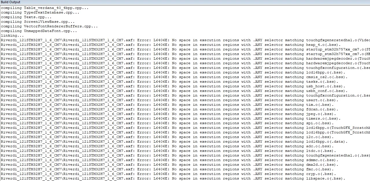

11/ After generate code by STM32CubeMx I'm going back to Touchgfx Designer and click generate code again TouchGfx generate code for keil.
12/ Run project in Keil
13/ Go to Option for target Go to tab OUTPUT
and uncheck Browse information
14/ Project build target
15 / Keil linking problem Not enough information to list image symbols.
Not enough information to list load addresses in the image map.
Finished: 2 information, 0 warning and 81 error messages.
"Riverdi_121STM32H7_1_6_CM7\Riverdi_121STM32H7_1_6_CM7.axf" - 81 Error(s), 0 Warning(s).
Target not created.
Build Time Elapsed: 00:00:14
Can anyone please solve the problem with compiling this Riverdi display for KEIL? Please try to compile a simple project for Riverdi STM32H7 display in MDK KEIL.
Thanks

    mcumakeAuthor
    Sep 24, 2025 8:51 AM UTC
    Hi OSMAN I tried your SCATTER file.
    The compiler reports this error
    linking...
    Riverdi_121STM32H7_1_6_CM7\Riverdi_121STM32H7_1_6_CM7.axf: Error: L6218E: Undefined symbol ExitRun0Mode (referred from startup_stm32h757xx_cm7.o).
    Finished: 2 information, 0 warning and 1 error messages.
    "Riverdi_121STM32H7_1_6_CM7\Riverdi_121STM32H7_1_6_CM7.axf" - 1 Error(s), 0 Warning(s).
    Target not created.
    mcumakeAuthor
    Sep 24, 2025 9:53 AM UTC
    another attempt with the V6 compiler
    l
    inking...
    Riverdi_121STM32H7_1_6_CM7\Riverdi_121STM32H7_1_6_CM7.axf: Warning: L6869W: abstractpartition.o requested the Rogue Wave Standard C++ Library which has been removed from the product. This might cause link errors because libc++ is used instead.
    Riverdi_121STM32H7_1_6_CM7\Riverdi_121STM32H7_1_6_CM7.axf: Warning: L6869W: lcd16bpp.o requested the Rogue Wave Standard C++ Library which has been removed from the product. This might cause link errors because libc++ is used instead.
    Riverdi_121STM32H7_1_6_CM7\Riverdi_121STM32H7_1_6_CM7.axf: Warning: L6869W: application.o requested the Rogue Wave Standard C++ Library which has been removed from the product. This might cause link errors because libc++ is used instead.
    Riverdi_121STM32H7_1_6_CM7\Riverdi_121STM32H7_1_6_CM7.axf: Warning: L6869W: bitmap.o requested the Rogue Wave Standard C++ Library which has been removed from the product. This might cause link errors because libc++ is used instead.
    Riverdi_121STM32H7_1_6_CM7\Riverdi_121STM32H7_1_6_CM7.axf: Warning: L6869W: box.o requested the Rogue Wave Standard C++ Library which has been removed from the product. This might cause link errors because libc++ is used instead.
    Riverdi_121STM32H7_1_6_CM7\Riverdi_121STM32H7_1_6_CM7.axf: Warning: L6869W: button.o requested the Rogue Wave Standard C++ Library which has been removed from the product. This might cause link errors because libc++ is used instead.
    Riverdi_121STM32H7_1_6_CM7\Riverdi_121STM32H7_1_6_CM7.axf: Warning: L6869W: constfont.o requested the Rogue Wave Standard C++ Library which has been removed from the product. This might cause link errors because libc++ is used instead.
    Riverdi_121STM32H7_1_6_CM7\Riverdi_121STM32H7_1_6_CM7.axf: Warning: L6869W: container.o requested the Rogue Wave Standard C++ Library which has been removed from the product. This might cause link errors because libc++ is used instead.
    Riverdi_121STM32H7_1_6_CM7\Riverdi_121STM32H7_1_6_CM7.axf: Warning: L6869W: dma.o requested the Rogue Wave Standard C++ Library which has been removed from the product. This might cause link errors because libc++ is used instead.
    Riverdi_121STM32H7_1_6_CM7\Riverdi_121STM32H7_1_6_CM7.axf: Warning: L6869W: font.o requested the Rogue Wave Standard C++ Library which has been removed from the product. This might cause link errors because libc++ is used instead.
    Riverdi_121STM32H7_1_6_CM7\Riverdi_121STM32H7_1_6_CM7.axf: Warning: L6869W: fontmanager.o requested the Rogue Wave Standard C++ Library which has been removed from the product. This might cause link errors because libc++ is used instead.
    Riverdi_121STM32H7_1_6_CM7\Riverdi_121STM32H7_1_6_CM7.axf: Warning: L6869W: hal.o requested the Rogue Wave Standard C++ Library which has been removed from the product. This might cause link errors because libc++ is used instead.
    Riverdi_121STM32H7_1_6_CM7\Riverdi_121STM32H7_1_6_CM7.axf: Warning: L6869W: lcd.o requested the Rogue Wave Standard C++ Library which has been removed from the product. This might cause link errors because libc++ is used instead.
    Riverdi_121STM32H7_1_6_CM7\Riverdi_121STM32H7_1_6_CM7.axf: Warning: L6869W: screen.o requested the Rogue Wave Standard C++ Library which has been removed from the product. This might cause link errors because libc++ is used instead.
    Riverdi_121STM32H7_1_6_CM7\Riverdi_121STM32H7_1_6_CM7.axf: Warning: L6869W: textprovider.o requested the Rogue Wave Standard C++ Library which has been removed from the product. This might cause link errors because libc++ is used instead.
    Riverdi_121STM32H7_1_6_CM7\Riverdi_121STM32H7_1_6_CM7.axf: Warning: L6869W: typedtext.o requested the Rogue Wave Standard C++ Library which has been removed from the product. This might cause link errors because libc++ is used instead.
    Riverdi_121STM32H7_1_6_CM7\Riverdi_121STM32H7_1_6_CM7.axf: Warning: L6869W: unicode.o requested the Rogue Wave Standard C++ Library which has been removed from the product. This might cause link errors because libc++ is used instead.
    Riverdi_121STM32H7_1_6_CM7\Riverdi_121STM32H7_1_6_CM7.axf: Warning: L6869W: utils.o requested the Rogue Wave Standard C++ Library which has been removed from the product. This might cause link errors because libc++ is used instead.
    Riverdi_121STM32H7_1_6_CM7\Riverdi_121STM32H7_1_6_CM7.axf: Warning: L6869W: abstractbutton.o requested the Rogue Wave Standard C++ Library which has been removed from the product. This might cause link errors because libc++ is used instead.
    Riverdi_121STM32H7_1_6_CM7\Riverdi_121STM32H7_1_6_CM7.axf: Warning: L6869W: displaytransformation.o requested the Rogue Wave Standard C++ Library which has been removed from the product. This might cause link errors because libc++ is used instead.
    Riverdi_121STM32H7_1_6_CM7\Riverdi_121STM32H7_1_6_CM7.axf: Warning: L6869W: drawable.o requested the Rogue Wave Standard C++ Library which has been removed from the product. This might cause link errors because libc++ is used instead.
    Riverdi_121STM32H7_1_6_CM7\Riverdi_121STM32H7_1_6_CM7.axf: Warning: L6869W: gestures.o requested the Rogue Wave Standard C++ Library which has been removed from the product. This might cause link errors because libc++ is used instead.
    Riverdi_121STM32H7_1_6_CM7\Riverdi_121STM32H7_1_6_CM7.axf: Warning: L6869W: stm32_crc_lock.o requested the Rogue Wave Standard C++ Library which has been removed from the product. This might cause link errors because libc++ is used instead.
    Riverdi_121STM32H7_1_6_CM7\Riverdi_121STM32H7_1_6_CM7.axf: Warning: L6869W: texturemaptypes.o requested the Rogue Wave Standard C++ Library which has been removed from the product. This might cause link errors because libc++ is used instead.
    Riverdi_121STM32H7_1_6_CM7\Riverdi_121STM32H7_1_6_CM7.axf: Warning: L6869W: touchcalibration.o requested the Rogue Wave Standard C++ Library which has been removed from the product. This might cause link errors because libc++ is used instead.
    Riverdi_121STM32H7_1_6_CM7\Riverdi_121STM32H7_1_6_CM7.axf: Error: L6218E: Undefined symbol __aeabi_vec_ctor_nocookie_nodtor (referred from application.o).
    Riverdi_121STM32H7_1_6_CM7\Riverdi_121STM32H7_1_6_CM7.axf: Error: L6218E: Undefined symbol typeinfo for touchgfx::Font (referred from constfont.o).
    Finished: 2 information, 25 warning and 3 error messages.
    "Riverdi_121STM32H7_1_6_CM7\Riverdi_121STM32H7_1_6_CM7.axf" - 3 Error(s), 25 Warning(s).
    Target not created.

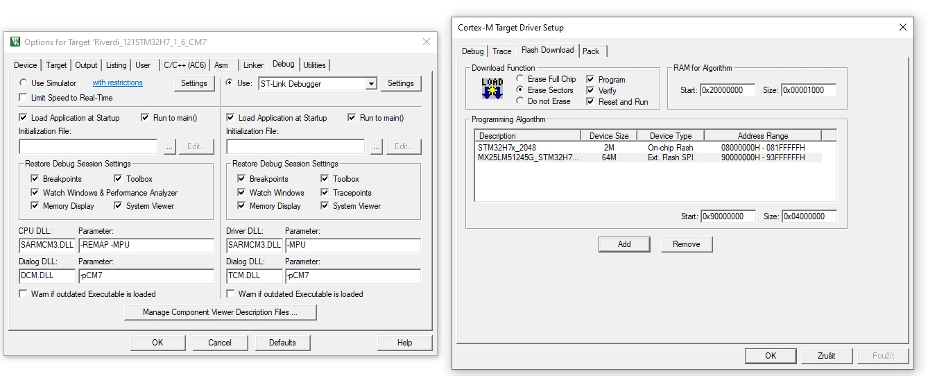

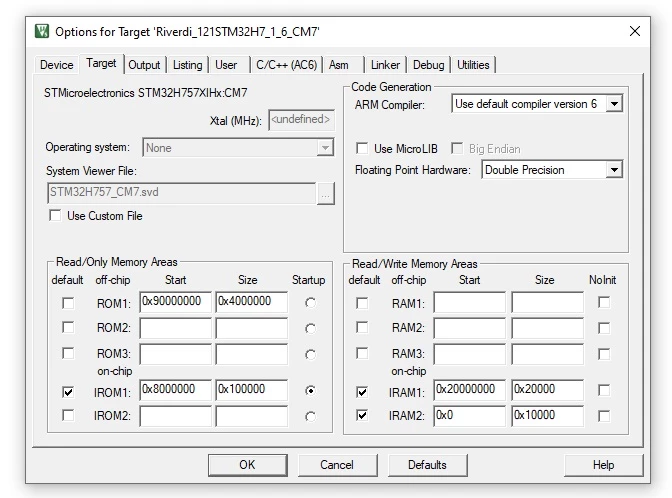

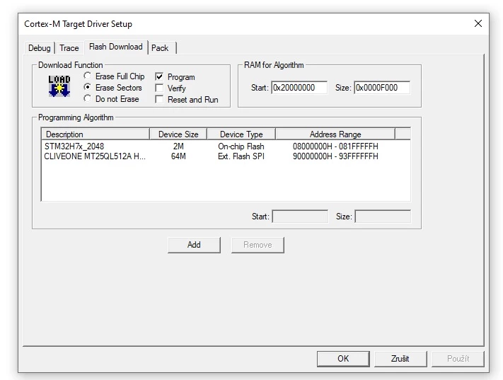

    Osman SOYKURT
    Oct 7, 2025 11:48 AM UTC
    Hello @mcumake ,
    I've tried your project, I think I've found out where the issue is. I have 3 suggestions that we could try:
    • 1st suggestion : Edit the file system_stm32h7xx_dualcore_boot_cm4_cm7.c (In Common/Src), remove all and paste this instead :

    • 2nd suggestion: IF 1st suggestion didn't work try to remove these 3 lines from startup_stm32h757xx_cm7.s and startup_stm32h757xx_cm4.s files (under Application/MDK-ARM)
    • 3rd suggestion: If 1st and 2nd suggestion didn't work try to use an older version of TouchGFX Designer (it has to be before 4.25.0)
    mcumakeAuthor
    Oct 7, 2025 4:06 PM UTC
    Hi Osman. Thank you very much for your help. Currently the compiler compiles the project without any problems.
    But there is one more problem. The RIVERDI display uses external FLASH memory. I have a problem with the programming settings for this external memory. Keil only offers external flash memories from DISKO or EVAL boards.
    How to create a programming file for the external flash of the RIVERDI board?
    external flash memory for DISCO - EVAL boardsexternal flash memory for DISCO - EVAL boards
    mcumakeAuthor
    Oct 8, 2025 12:09 PM UTC
    Hi.
    I have tried all the presets for the 64MB external FLASH. The programming attempt always fails.
    Osman SOYKURT
    Oct 8, 2025 1:05 PM UTC

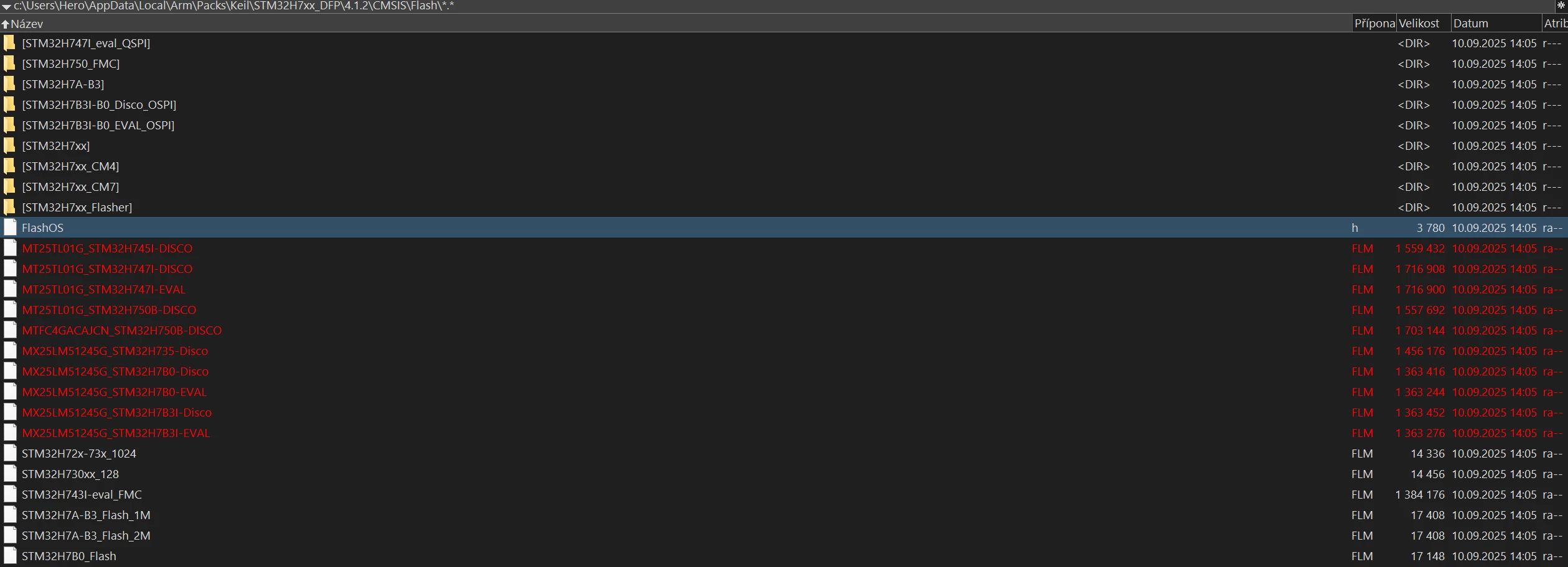

    Hello @mcumake ,
    Could you try to flash using STM32CubeProgrammer? The flash loader (.stldr) is inside the gcc folder of the project. You can copy that file to the External loader folder of your STM32CubeProgrammer (by default C:\Program Files\STMicroelectronics\STM32Cube\STM32CubeProgrammer\bin\ExternalLoader) and then use it for flashing your board.
    mcumakeAuthor
    Oct 8, 2025 3:01 PM UTC
    Hex compiled using CUBE IDE

    Oct 9, 2025 8:45 AM UTC
    Hi.
    A better way would be to enable programming - debugging directly in keil.
    I found this link.
    https://www.keil.com/appnotes/files/apnt_333.pdf
    Could someone more experienced create an FLM file for programming external FLASH on the RIVERDI board?
    Thanks.

    I found some external loader for Riverdi memory.
    https://github.com/cturvey/stm32extldr/blob/main/h7_mt25ql512a/README.md
    I'm going to try it.
    Tesla DeLorean
    Guru
    Oct 14, 2025 9:55 AM UTC
    Ok, so complaining here about your code generated to be placed into 0x24000000 which is RAM. You need to check your Target setting for FLASH and RAM, ie the scatter file which is the equivalent to GNU Linker Script.
    The .FLM is providing an Algorithm for the 0x90000000 address space, which is where the QSPI memory is situated.
    mcumakeAuthor
    Oct 14, 2025 2:11 PM UTC
    Hi
    Thanks for the info.

    mcumakeAuthor
    Nov 21, 2025 9:23 AM UTC
    I tried to implement all the information from
    https://support.touchgfx.com/docs/development/scenarios/converting-keil5-project-to-keil6
    and from
    https://community.st.com/t5/stm32-mcus-touchgfx-and-gui/when-using-arm-v6-compiler-the-touchgfx-program-cannot-run/td-p/846333
    I uploaded the HEX compiled with MDK using cubeprogrammer and an external loader.
    The program probably doesn't run. The screen is black.
    It would be necessary to create an external FLM loader for the riverdi board.
