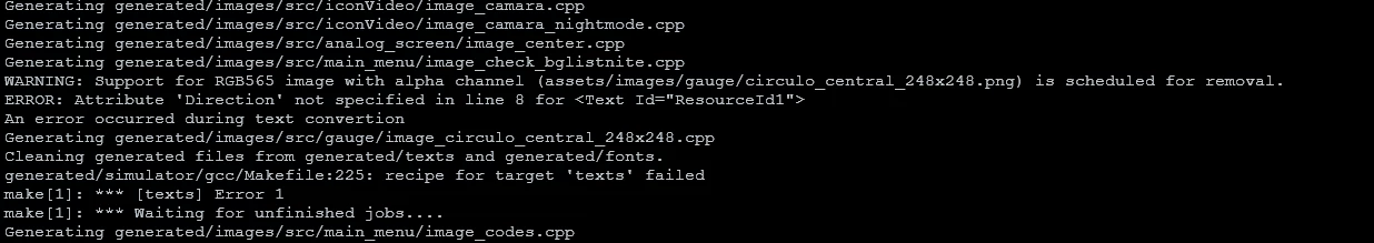

When I create a text area (or a button with text, text progress, digital clock), I encounter this problem when I generate the code.
Generate Code
 Generate
 Done
 Generate Assets
 make -f simulator/gcc/Makefile assets -j8
 Reading ./application.config
 ERROR: Attribute 'Direction' not specified in line 8 for <Text Id="__SingleUse_FCFO">
 An error occurred during text convertion
 Cleaning generated files from generated/texts and generated/fonts.
 generated/simulator/gcc/Makefile:225: recipe for target 'texts' failed
 make[1]: *** [texts] Error 1
 simulator/gcc/Makefile:32: recipe for target 'assets' failed
 make: *** [assets] Error 2
 Failed
 Failed

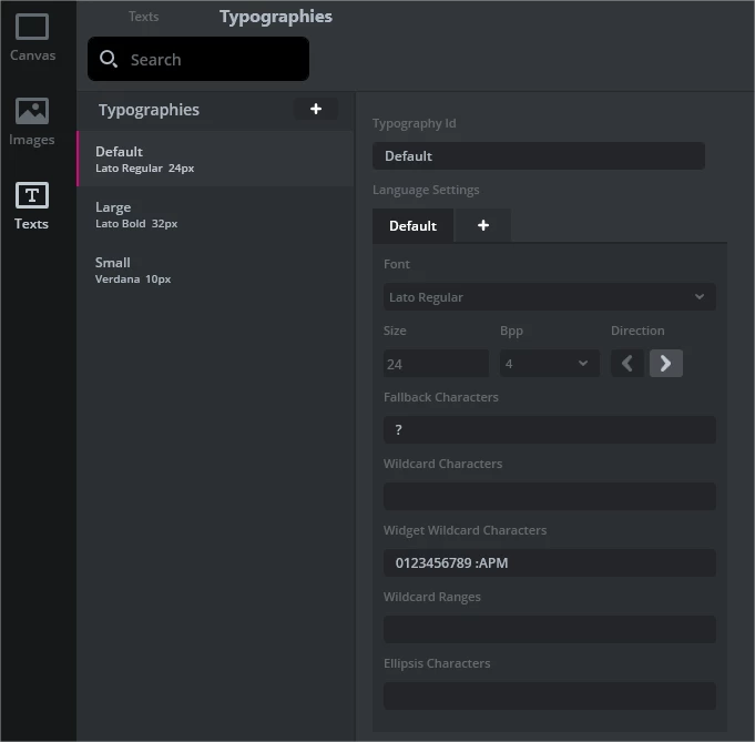

I checked the direction of the typography is LTR so it is specified in there at least.

We investigated and found out where the problem came from.
In the .touchgfx project file, the TouchGFX version is updated to 4.19.1, which is correct. But, it seems like CM7>Middlewares>ST>touchgfx folder is included with the TouchGFX Board Setup for this board, and unfortunately those file are still under the 4.18.1 version. So, there is a mismatch between generated files and TouchGFX project versions.
We will contact Riverdi to discuss this issue.
In the meantime, you could use a little work-around to make your code generation work :
  • Rename or delete your CM7>Middlewares>ST>touchgfx folder
  • Generate code in the Designer
