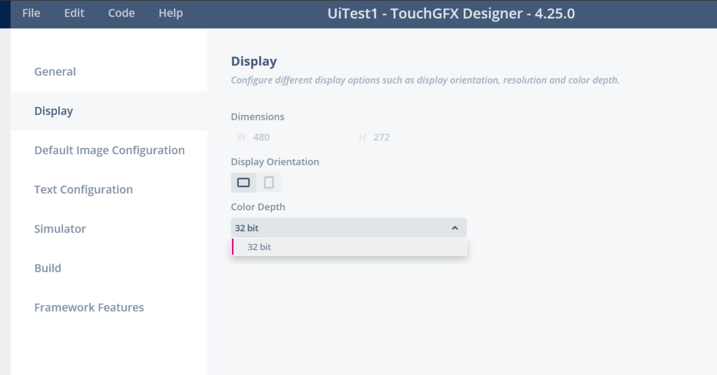

Hi Team,
   We are running into a problem on TouchGFX (v4.25) on configuring our 480x272 display on the above discovery board I mentioned.
  1. We want to configure a text box and display this  color I attached below. We found that the RGB we have is RGB565 and we may need RGB888. But I do not see any difference even after the change in this configuration.
  1. We want to understand if it is really possible to achieve this color or is it a limitation of the board selected?
  2. This information will help us to choose this controller for our further development or choose other products to achieve this.
Looking forward for your response as soon as possible. Thank you so much.
Changed config:
6 replies

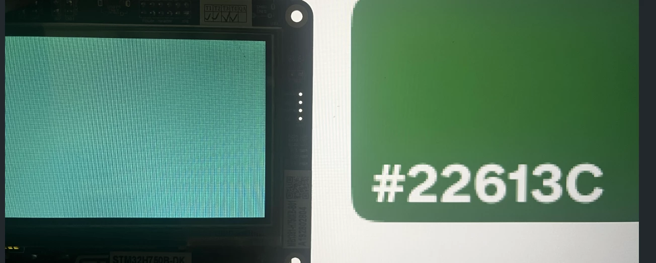

Hey Johan,
    Thanks for your response. Yes we are facing issue with the color representation.
In the above image I want color #22613C to be displayed in the display. But even after successful configuration of RGB888, still there is no change the color. I do not see the same color on the display.
If it is the limitation then we can check with the displays that you have mentioned. If it is possible for you to show how #22613C looks in one of the displays you mentioned then we would like to order and go ahead with those displays.

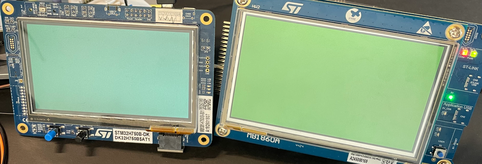

Jul 30, 2025 9:06 AM UTC
It is difficult to capture accurately in an image, but I have tried to compare the STM32H750B-DK with the STM32U5G9J-DK2 in the image below.
The color on the STM32U5G9J-DK2 doesn’t exactly match the color displayed on my computer monitor either (it appears slightly darker on my monitor). However, I cannot determine which one is more accurate.
Note: To my eye, the green on the STM32U5G9J-DK2 board appears a bit darker than it does in the image.
