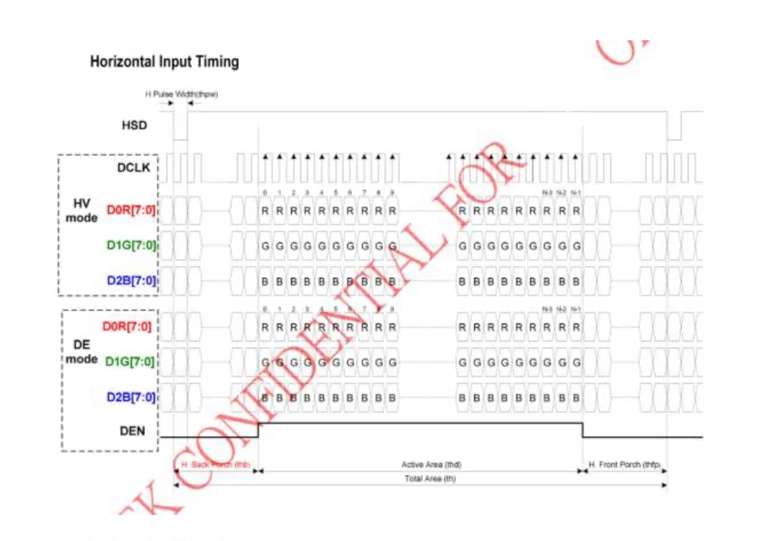

Hey,
i am planning to use an LCD With RGB 18 bit interface.
In the LCD D.S there are only RGB+DE+DCLK Pins, without Hsync and Vsync.
it works In DE mode without this pins.
can the MCU work at this mode?
Br
peleg

Which mcu?
But, as all LTDC signals are outputs, whichever the mcu is, it really does not care whether that output is connected anywhere or not.

Hey,
STM32H743..
Maybe there is a configuration register where you decide in which mode to work with.. H+Vsync or DE only.
