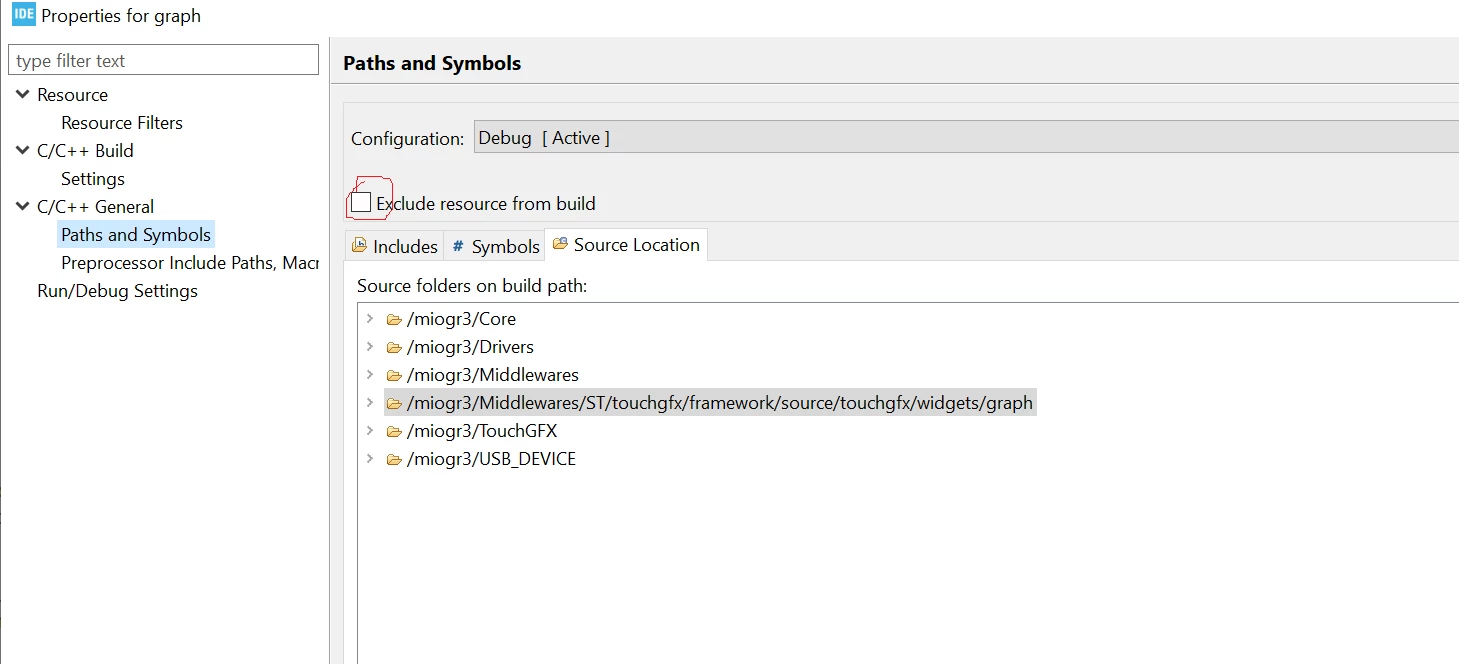

I am using the following workaround:
1. After adding points using addDataPoint(), the dataCounter field of the AbstractDataGraphWithY class is incremented. In this class, I have added a dataCounterReset () function that zeroes out the dataCounter.
2. Before adding points to dynamicGraph, I called the dataCounterReset () function.
2. Then, in the properties of Middlewares / ST / touchgfx, unchecked the "Exclude resource from assembly build" checkbox and compiled the project.
I also did not find another way.

Anyway, how to do this:
"2. Then, in the properties of Middlewares / ST / touchgfx, unchecked the "Exclude resource from assembly" checkbox and compiled the project."
Any SW tool to uncheck this option?

 It seems there was a mistake in my comment. If I remember correctly, it was necessary to uncheck this checkbox in the project properties(stm32cubeide). 0693W000008yqXdQAI.png
April 9, 2021
I did not understand this part

Hi @mbagh.1​ , I think what @Vladimir​ meant was that he needed to exclude particular code folder which was touchgfx designer related to make the project in Cube IDE able to build.
However in my case, to resolve the issue in this forum, it is suffice as what @Michael K​  summarize
