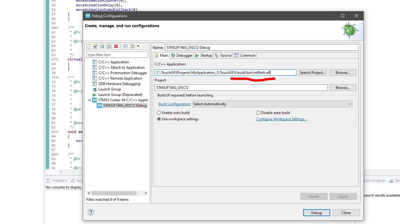

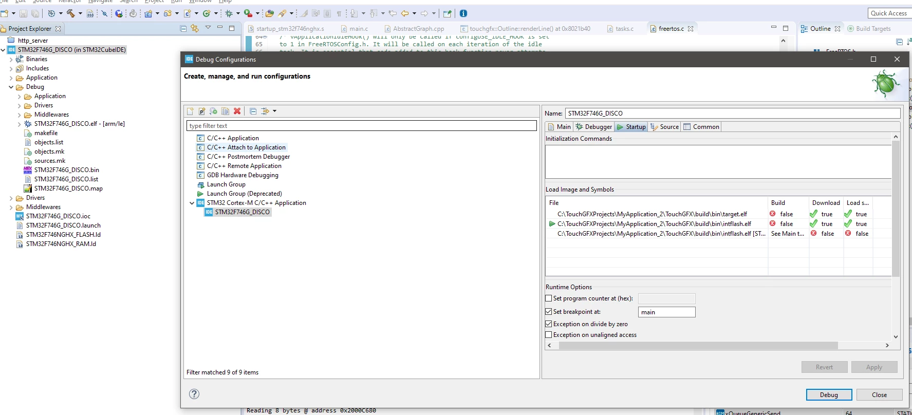

Vladislav Leschenk
February 9, 2020
I just have added target files without any "dancing with a tambourine".
The order files in first screen is important!!!
