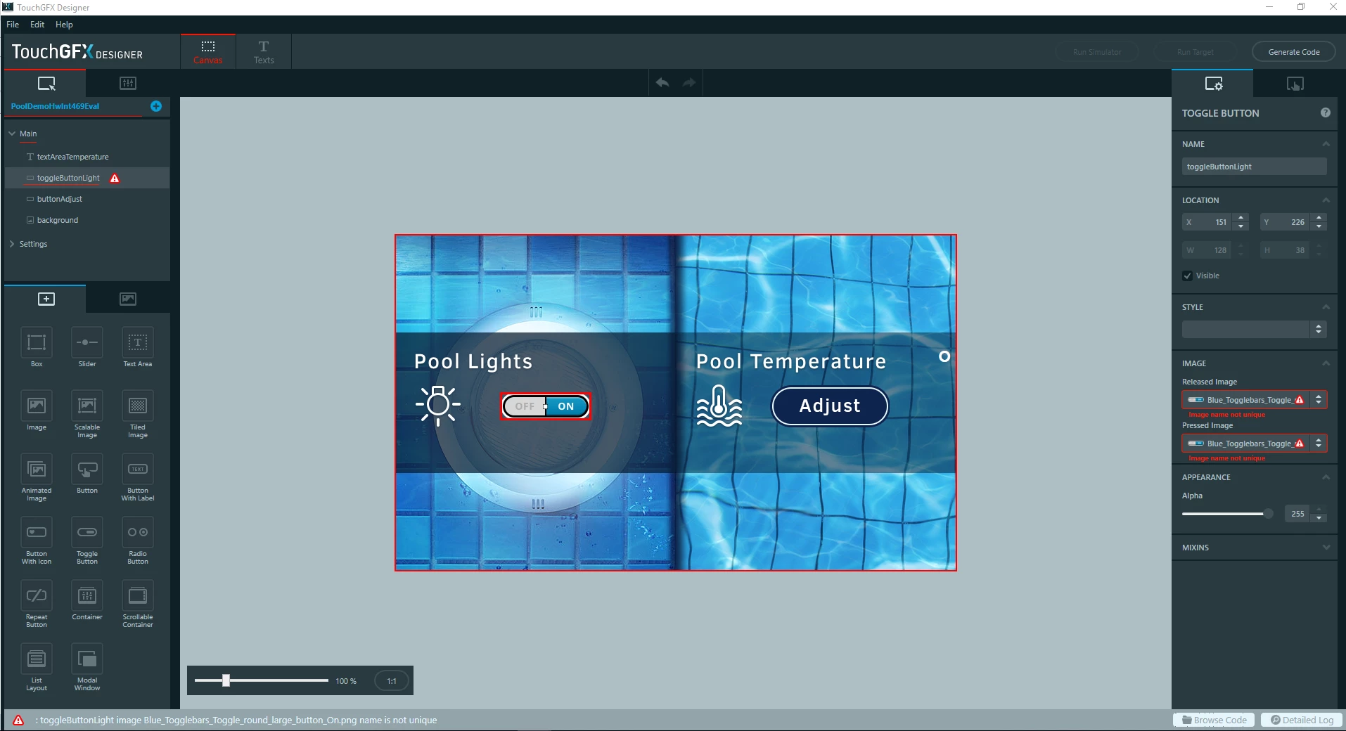

I tried to use the example but there is an error.
It say that button ON OFF image is not located in asset/image folder (see image attached).
Next, I copied and pasted "Blue_Togglebars_Toggle_round_large_button_Off.png" and "Blue_Togglebars_Toggle_round_large_button_On.png" in the image folder. I choosed them in TouchGFX (see image attached) but continue to have error.
I use TouchGFX Designer 4.9.2 and when I opened the project it says me to upgrade because was realized with an older software version.
Same compilation error there is if I open Visual Studio solution.
Could you provide me an example for my touchGFX version and keil target please?

ANSWER - TouchGFX Community repost - Anders Nedergaard Petersen - April 2018
Hi Christian,
It appears that the project contains more than one images in assets/images with the name "Blue_Togglebars_Toggle_round_large_button_On.png"
