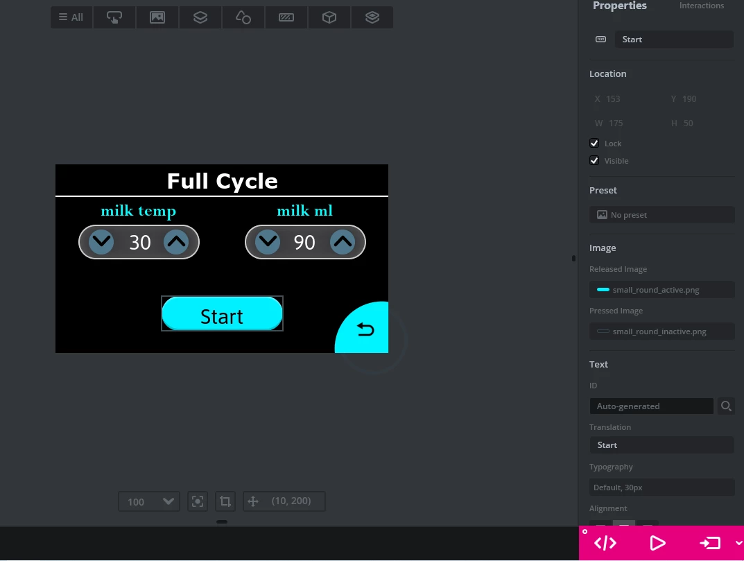

Hi, I’m working with an STM32H7S78-DK board and I want to replace the current display with a new one that has a resolution of 480x272. I’d like to know if this is possible, and if so, what steps or considerations I need to follow to make it work properly. Any guidance on configuring the MCU, adjusting the display driver, or handling any hardware/software changes would be really helpful. Thanks!

    I Configured the Display, but TouchGFX isn't working correctly. The button touches aren't registering properly; they react continuously even before I release them.

    Hello @Sanjay27 ,
    Could you check you I2C1 config? Because the sampleTouch function reads touch status from it (at least from our TBS)?You can read more about that in our documentation.

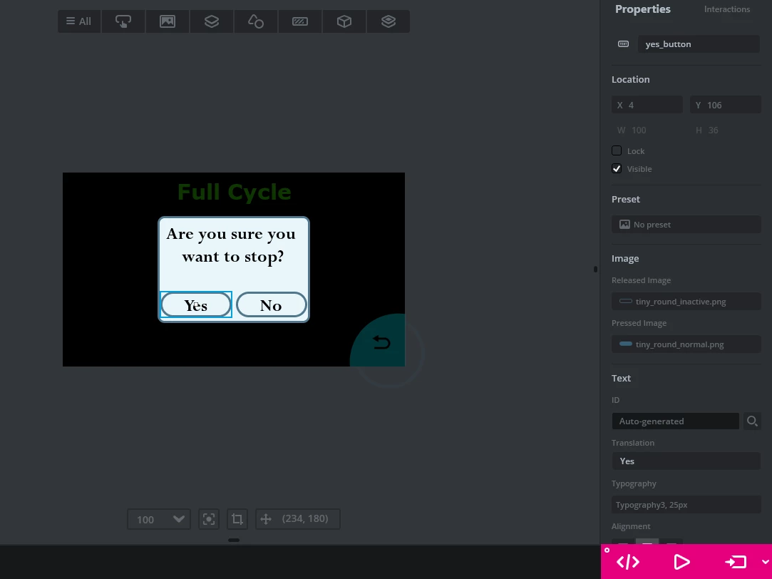

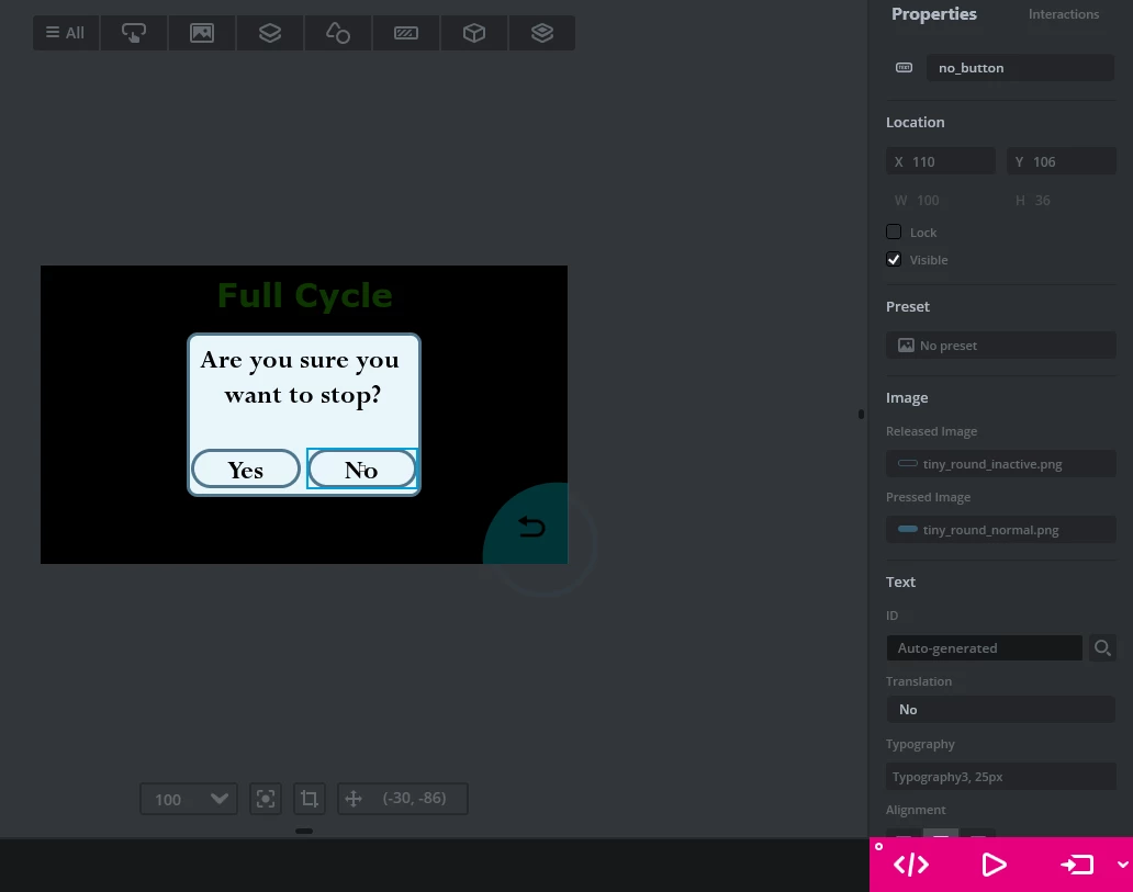

    Sanjay27Author
    Dec 15, 2025 12:39 PM UTC
    Hello @Osman SOYKURT
    The Buttons are Reacts before release, see the Pictures and attached video files

    Could you show us your STM32TouchController.cpp file ?

    Sure,

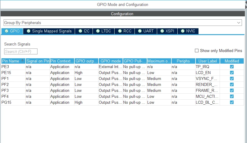

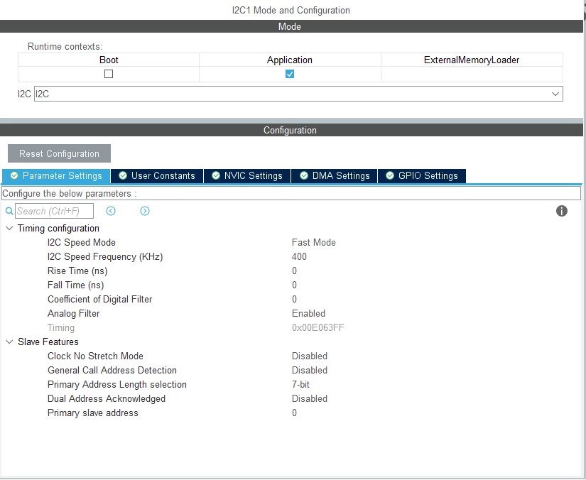

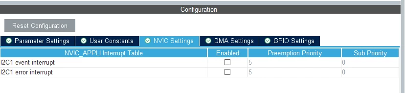

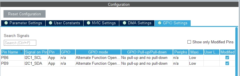

    Dec 18, 2025 9:34 AM UTC
    Ok, could you now check your TP_IRQ_Pin configuration on STM32CubeMX ?
    You can also check you i2c configuration (I would suggest to make it similar to our current) :
    Sanjay27Author
    Dec 18, 2025 10:56 AM UTC
    My Configurations Still not working well

    Hello @Sanjay27 ,
    I'm running out of ideas, but maybe you have found on your side what was the issue?
