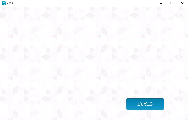

Render problems after rotating the display 180 degrees
  • August 4, 2020
  • 1 reply
  • 1181 views

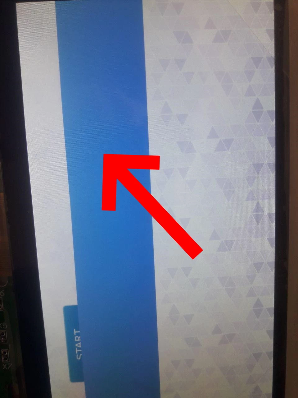

I have a TFT display with a resolution of 800x480 and STM32F429. Used the code from here https://community.st.com/s/question/0D50X0000A1lVxsSQE/repost-change-lcd-orientation-in-180-degree , everything works fine in the simulator
and separately tested on the 476H Discovery but on the TFT with F429 does not render different areas

Everything works fine without a mirror and these empty zones appear in different places
