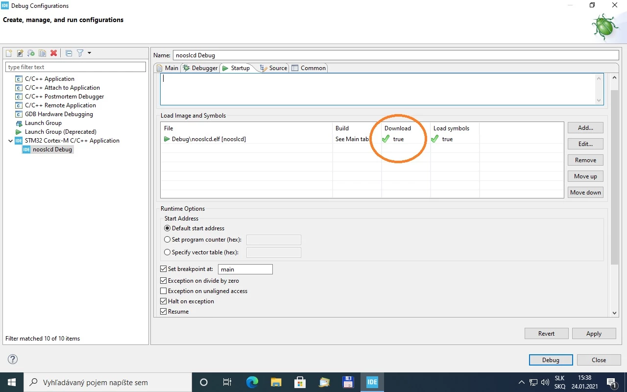

You dont write how IDE used , but simply you need only skip flash external section ,,,

i'm using IDECube 1.5.1. (sry I forgot it)
How can I edit this setting? I'm new about stm32 world, and soometimes I need some help.
Can you show me with a picture?

Here in CubeIde exist more type of projects, but when you use normal , then in Debug configuration window you have one settings for external loading and second for startup download. I mean simple is turn off Download and in command part write cmd line to flash only hex file .
or try disable only external loading on Debugger settings

If I disable the external loader, debugger connection crash and nothing works.
In the section you show me, I tryed to change the configuration but I discovered that is only possibile to set an offset.
If my uC FLASH range is 0x08000000 --> 0x08200000 and QSPI section is 0x09000000, i'm not able to exclude the QSPI section. Offset allow to me to exclude the main program instead of external resources. (IE I can set the Offset to 0x09000000, but not a valid range)
